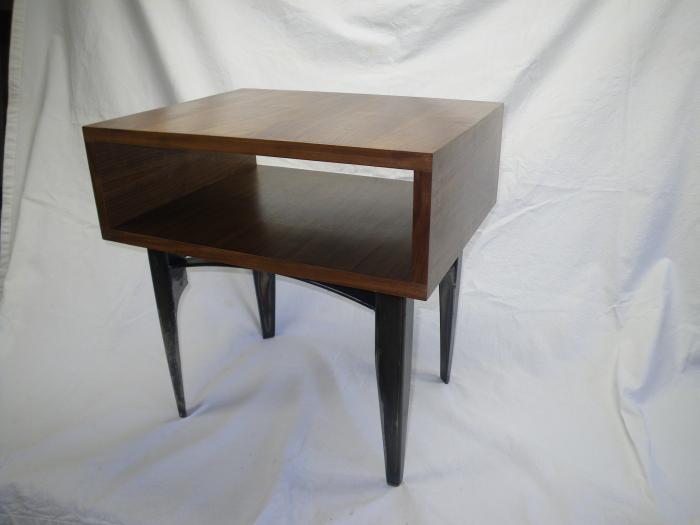

- My take on mid-century modern

Motox, which radius, the diagonal coverlet facing in? that was plasma cut and fitted. square tubing? in some cases, yes and in some cases, no. I have a pile of test pieces figuring out how to make them.

Really creativity, I just love it. I am trying to make the same side table here in Australia but still not successful. I made but couldnt get the same finishing! Any help, I am not able to make the sharp edges!
Buy Huali Furniture for office and home online in Australia.
Elderberry, which sharp corners? The wooden corners? Tablesaw cutting 45 degree corners. I put blue painters' tape along the cutline to limit chipping of the veneer. Biscuits to align glue up. Walnut plywood has very thing veneer so sanding is touchy to not round off and go through the veneer. Hope this helps.
