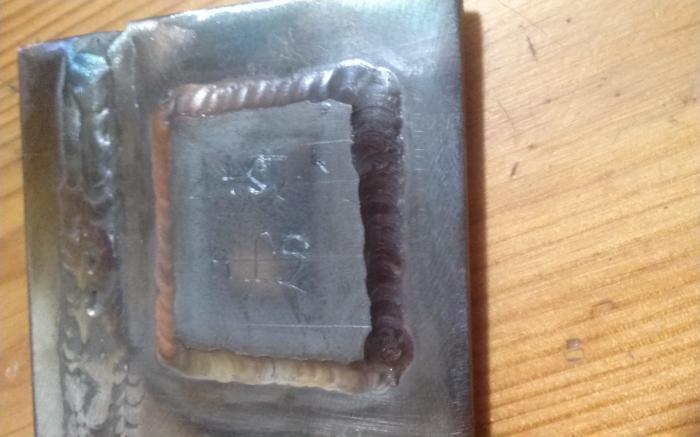

Ok, I am changing the plan, not the goal. I will have to engrave a steel tag.
My first try with silicon bronze did not go well. I tried a bead on plate and it looked all granular and didn't wet out.
Any help is appreciated.

- 0128171000.jpg (48.9 KiB) Viewed 1622 times
I am using 1/16th filler rod and the base plate is 3/16.
You're including your base metal into your braze. Tig brazing takes practice. You have to use an amperage that would eventually puddle your base but will melt your braze long before your base. takes practice.
Things are getting a little better but I am still melting base metal into my braze. I switched to using the torch switch but even at 40 amps the 1/8th inch steel is melting. These were just scrap pieces. I plan to just keep practicing.
