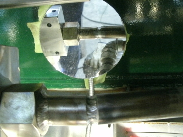

I do a load of mirror welds, and I do not have a "standard" setup. Every situation presents it's own unique challenge. I use bunches of the 3" rounds from the craft store, sometimes put in place with two-side tape, sometimes on a magnet with the same tape, sometimes on a gooseneck. Often I can't use magnets (stainless and aluminum), so I rig clamps. I have an inspection mirror (3") with an extension handle I can sometimes clamp in the right area and adjust the u-joint for the right view. I also have a 4" X 6" generic replacement truck mirror with a ball joint on the back I can bolt to magnets or brackets with a 1/4-20.
There is no "one way" to do this.
The one thing I have found, is when I come out of the mirror and can see it straight again, I have to tail off, and walk away for five minutes, because I can't instantly switch back into "normal" mode.

I also use a 2"-3" inspection mirror on a teliscopic handle or tape it in place....Most of mine are done on stainless. I've also use mirrors lexan in a pinch.

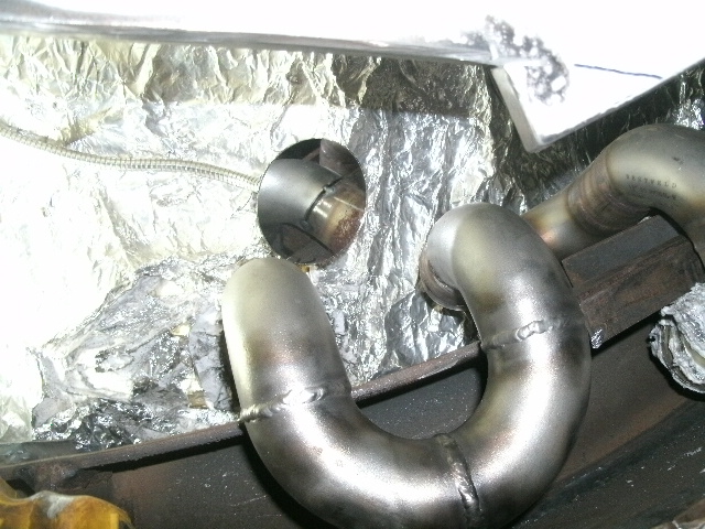

When I decided to get more serious with my racecar and add the full cage, I already had a rollbar that was very well made and the hoop fit quite tightly to the body. The prospect of cutting it out, cutting out the thick base plates, then trying to fit it back in and patch it up was daunting so I got a CK microtorch and crossed my fingers. Worst case I decided I'll cut holes in the roof and patch them after. But the microtorch had just enough access. I ripped the mirror off an inspection wand and used a rare earth magnet to pin it against the roof. This was all very McGyver impromptu stuff, if I had to do it again I'd glue the magnet to the back. I eventually got the hang of it pretty well but initially it definitely involved a lot of tungsten grinding when I zigged instead of zagging in the mirror. But, job done is job done.
