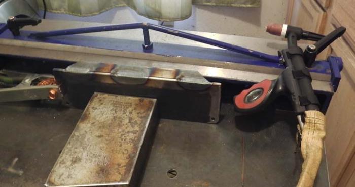

This was today's 11ga SS job shop project. They bring me the laser cut parts and I fuse them. They get wire brushed before they are done.
- SS Brackets 110.JPG (58.55 KiB) Viewed 2247 times
- SS Brackets.JPG (43.03 KiB) Viewed 2247 times

Thank you, I just stumbled into this trying to learn about E3 tungsten and thought it could come in very handy.
Start to finish is about 3 hours, a good jig helps a lot. I do this job (110 pieces) about every 3 to 4 weeks.
Hey Rudyray...nice welding. I notice no obvious signs of cleaning the metal prior to welding. Is this for cosmetic reasons or just a time saver as you do so many? I have tried not cleaning SS and it welds like crap.

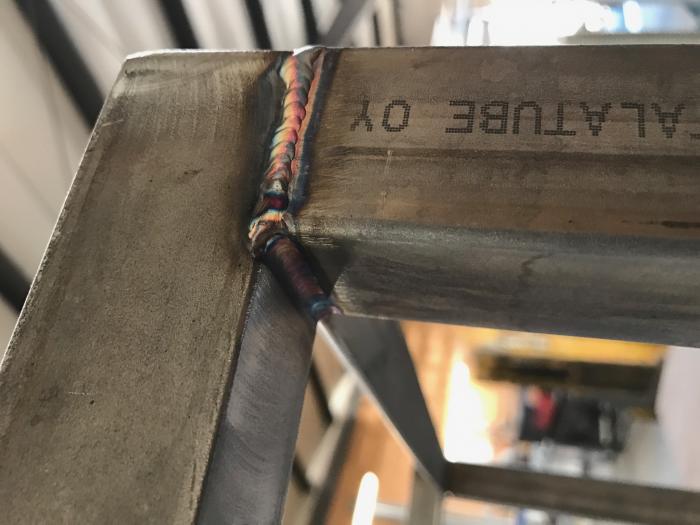

Welding corners on 1" square tubing, testing different pulse settings on the Fronius. All welds at 80 amps. Top left corner is 1.000 HZ. Top right is 500 Hz. Bottom right is 100 Hz and finally bottom left is 1 Hz. For some reason I had to use filler on the 100 Hz weld. The rest is butt welded.

Thank you.exnailpounder wrote:Hey Rudyray...nice welding. I notice no obvious signs of cleaning the metal prior to welding. Is this for cosmetic reasons or just a time saver as you do so many? I have tried not cleaning SS and it welds like crap.
I can usually weld them as delivered from the customer, fresh off the laser. They will have a little soapy film on them sometimes that will turn slightly black. Without cleaning I'll have to sharpen (clean) the tungsten every 25 parts or 75" of weld. Cleaning the tungsten is faster than cleaning all the parts. After fuse welding I'll line them up on the table 16 wide (just under 60") lay a bar across the back side with 2 clamps, and run across the weld with a soft SS wire cup on the grinder to remove the color, flip and repeat. My customer throws them in a vibratory to clean and deburr before they ship them off.
All in all 110 parts takes 3 to 3.5 hours if I'm not interrupted any more than usual.

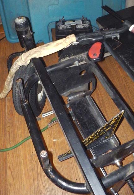

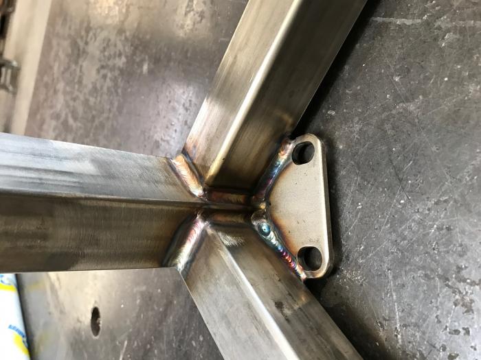

Here is this afternoons work, a cart for a local Armenian deli meat manufacturer and fixing a buddy's chair. Was quoting construction and chasing parts in the morning.
The stainless was filthy, it's been on the shelf for quite a while. I just buffed the area to be welded with the flap disk as I was deburring and called it good. I was out of acetone to clean everything first. All materials were rems from other jobs, I love selling the same piece of material twice.

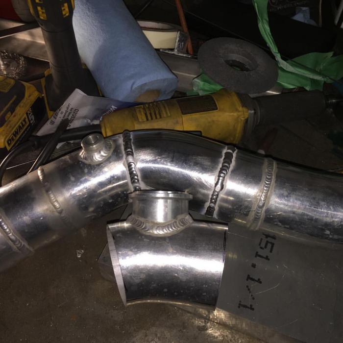

After talking to Borg Warner engineers at PRI, they told me that the recirc valve in the EFR turbos is part of the recipe for the lightning fast transient response (only needing to repressurize the compressor cover, not the entire intake), so I'm putting it back in and needed to delete the blowoff valve. My first time doing aluminum piping, was fun to figure out the angle to cut out of the 45 elbow but turned out pretty well. Also my first time using 4943... suffice it to say that I'll never use anything else except for when required for a specific application.
- charge_pipe.jpg (57.47 KiB) Viewed 2306 times
