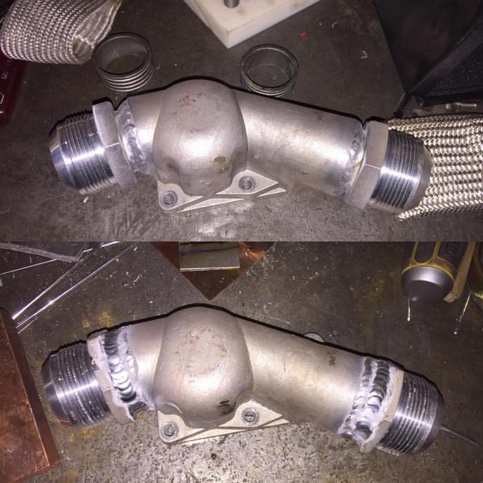

Yeah, I got a hold of an aluminum expert from a very respectable company but I've been waiting for his express permission before I share his words verbatim. But to paraphrase, he said it takes hundreds and possibly thousands of hours of exposure to stress in a corrosive environment and high heat before this is a concern, in other words, not a concern for my application.
I still hogged out and rewelded my thermostat housing because I'm a loser.
- tstathousing.jpg (82.65 KiB) Viewed 2564 times
What filler did you settle on BigD?BigD wrote:Yeah, I got a hold of an aluminum expert from a very respectable company but I've been waiting for his express permission before I share his words verbatim. But to paraphrase, he said it takes hundreds and possibly thousands of hours of exposure to stress in a corrosive environment and high heat before this is a concern, in other words, not a concern for my application.
Still waiting on the 4943 so I just refilled it with 4043

I got permission to share the gentleman's opinion publicly so here is what he said.
Frank G. Armao
Director, Aluminum Technology
Lincoln Electric
In order to get stress corrosion cracking (SCC), you need 3 things. First you need a susceptible microstructure. You get that when you expose any aluminum alloy containing more than 3% Magnesium t(5356 has 5%Mg) to temperatures higher than 150 degrees F for long times – 100s or 1000s of hours as I said. Second, you need a stress. Usually the residual stresses around a weld are more than enough. Last, you need an electrolyte – salt water is the worst, but any impure water will also work and cause SCC. If you take any of those 3 factors away, you won’t get SCC.
So if you only expose the 5356 to atmosphere (not to engine coolant), you won’t get SCC.
SCC is actually fairly common. You usually find in marine environments. The US Navy, for instance, is having a problem right now with a class of aluminum hulled ships that are cracking where the engine exhaust pipes come out of the 5083 aluminum hull. In 2016, I encountered a problem on a large aluminum hulled yacht where the hull was cracking from SCC. Why? Because the builder routed the engine exhaust piping right up against the 5083 hull. The solution was easy. Fix the cracks and move the exhaust piping inboard a bit so it didn’t get the hull hot.
Frank G. Armao
Lincoln Electric
