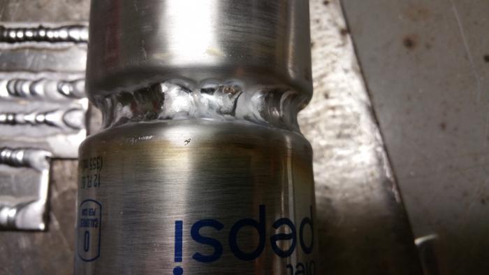

Just undertook this endeavor today. Quite fun and frustrating at the same time. I am out of coupons but l am certain my neighbors will be able to supply all l could need. This looks better in person than it does on camera. This is one of the better results. Warts and all, right?
- 20170110_095438.jpg (29.52 KiB) Viewed 3584 times

Yeah, I found a few beer cans last night and started dabbling with them, and it certainly was tricky, at least for me.
I'll probably go to the store today for some nice new cans and get back to this.
Not bad, Sedanman.

Steve, Craig, Keith and Ryan, thank you gents.
Thankfully this did not require pics from both sides of the can
. I am thoroughly convinced that the thickness varies in this area of the bottom as you go around it. Some places it just up and vaporizes away. Anyone else notice that?
Think this will be my new go to exercise for shaking the cobb webs off, being as I go so long without lighting up.
I was experimenting with lighting up on flat bar and moving it over to the edge of 2 pieces of strip I had cut from a can, just stacked on one another.
I had a play with it. I could keep a low amp arc going provided I bumped the frequency way up and kept the arc gap around 1mm, once the arc got too wide the hf kicked in took a big bite out of the edge. Could just about get a fusion weld on the edge of the two strips though.
Ok... Excuse time ....
Lets see, well I only had 2 cans, and there is only so much ginger beer I can drink. All my real bear comes in bottles
Seriously though, what a pain in the arse this is. I did a root pass (looked shite), several fill passes for practice and to clean up the root pass (they looked shite too), then tried to clean it up again and ended up with this big dodgy cap which I did at about 100 amps and weaving side to side to cover the width of the beads below.
Really need to light up on the filler and get it to melt itself in. I ground the electrode to a point and put a flat on the end. Bumped the frequency way up hoping to tighten up the arc somewhat. I only have 2.4mm rod on hand, probably would have been better with 1.6mm as the 2.4mm takes a bit too much heat to wet in. Or simply practice a lot more.
- C. Livingstone
Yeah,
I bought an 8-pack of small, 7.5oz Coke cans, since I envisioned myself having to drink the soda faster than I thought I might master the task.
But those little cans had a short lip where the red color was real close to the joint, which may have added to a contamination of the puddle problem. So I drank the first two, but then dumped the rest as I quickly burned through them and about 20 CF of Argon. Ha, ha, ha... But I did start to have a little luck with an "Advanced Pulse" or Mix/TIG feature on my machine, which I've otherwise never used for anything.
I might get back to this before too long, as a neighbor consumes a lot of soda and has plenty of normal, already empty cans.
