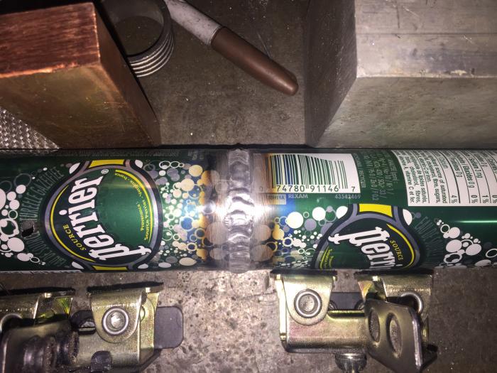

Wife bought some canned Perrier so I used the rare opportunity when we have cans in the house to try this.
3/32 lanth, 60 amp peak (dont think I ever came close to full tilt but I was doing a heavy pedal dance regardless), triangle wave, 200hz, 75% EN. Didn't go nearly as badly as I thought, I could probably neck down the bead more with pulse but I'm pretty happy with it for a cold single attempt
- IMG_4772.JPG (72.68 KiB) Viewed 2851 times
- maker of things
Big D, looks good to me. I would have been delighted with that as a first attempt.

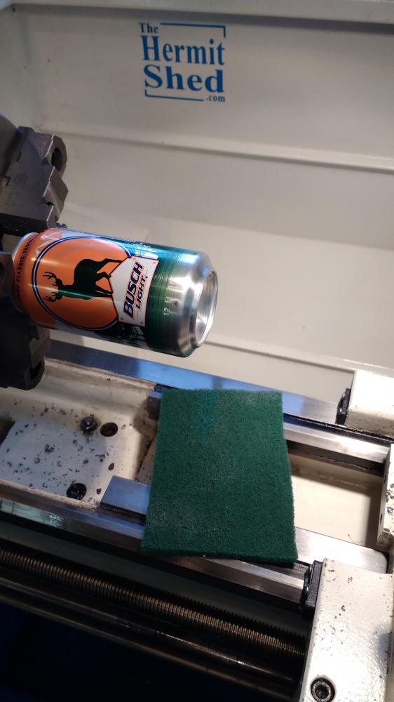

- maker of things
- IMG_20161211_113624032.jpg (57.59 KiB) Viewed 2842 times
- IMG_20161211_132232702_HDR.jpg (37.26 KiB) Viewed 2842 times

- MosquitoMoto
Location:The Land Down Under
Nice work!
I've fallen back on this. Have had a lot of other welding to do and no time to keep up the practise on the cans. However, a Christmas break beckons, so I'll be back into it soon.
