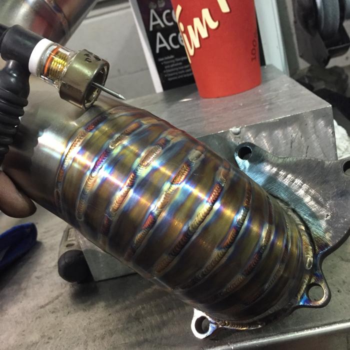

Hey guys, I have been so busy with the shop lately I have totally forgot about this place. Here are a few pictures of some recent projects.
- Downpipe welds
- image.jpeg (48.31 KiB) Viewed 3242 times

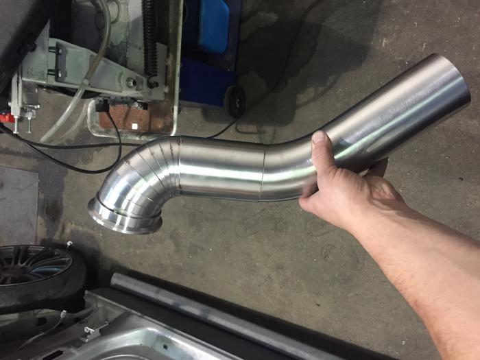

- Downpipe fit up
- image.jpeg (45.57 KiB) Viewed 3242 times

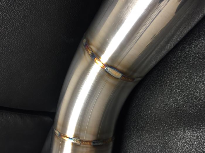

Thanks for the kind words guys! I am still learning and progressing a ton with each job. Sorry to post again so soon but I was doing some more exhaust work today and these are my best welds to date IMO.
- image.jpeg (70.53 KiB) Viewed 3119 times
- image.jpeg (31.82 KiB) Viewed 3119 times
- image.jpeg (41.85 KiB) Viewed 3119 times

did you use the same stick out as shown to
achieve those pretty welds?
if so what kind of gas flow?
very nice!
very nice!
AFR_Autoworks
- AFR_Autoworks

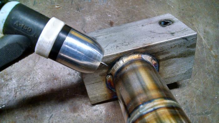

Hey Craig, yes I did use that amount of stickout. I almost always run 25 CFH unless I have to do some insane weld where I need more stickout. With this cup I have been able to run over 2" and still see coverage.

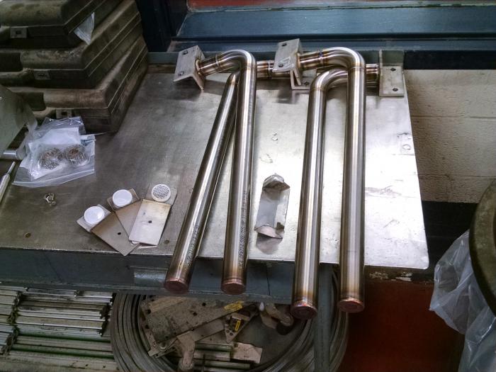

Finished up a bunch of little projects last night at work, have a full workload today have to finish welding up a filler.
- IMG_20160722_172342.jpg (59.21 KiB) Viewed 3220 times
- Rocking with my Superior Welding Unbreakable Cup
- IMG_20160722_192958562_HDR.jpg (47.41 KiB) Viewed 3220 times
Location:Orlando FL
They are capped solid no hole, they are just some fancy stands for some Video Jet Printer cleaning stationsLtBadd wrote:Hey Rick, looks like these are capped on one end and a bracket on the other, is there a weep hole anywhere, and what are these used for...?Rick_H wrote:Finished up a bunch of little projects last night at work, have a full workload today have to finish welding up a filler.

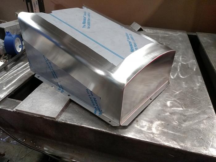

Thaks, the lower LH corner I assume is what you are talking about... they are actually reflector mounts for some photo eyes..subwayrocket wrote:Nice stuff Rick ! Are those your back shielding boxes next to the finished brackets ?
Just a machine guard...

That is a Metabo burnishing machine PT# 12-115, with a scotchbrite style flapper, 900grit at that point. I work in a food plant so finishing is very important, this is one tool I am not sure how I lived without, expensive but worth every penny IMO. You can put the grain back in stainless and blend it so you can not even tell. It has a neat little attachment where I can use scotchbrite or sand belts to polish all around piping.hey_allen wrote:What is chucked up on that tool?Rick_H wrote:Just a machine guard...
