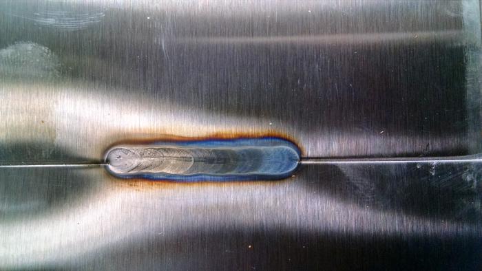

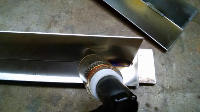

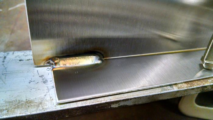

Here just whipped these up for ya..
Maxstar 150 STH, 1/16" tung, CK gas saver, 70amps
16g 304L Stainless, butt weld with alum backer, I moved fairly quick straight pull
16g 304L Stainless, fillet weld, dabbing (didn't sugar the backside on either)

- dabbing some 3/32" filler on Fillet
- 093 filler fillet.jpg (35.28 KiB) Viewed 2227 times
- dabbing some 1/16" filler on a Fillet
- 062 filler fillet.jpg (27.27 KiB) Viewed 2227 times
- backside of buttweld, full penetration
- 70amps buttweld rear.jpg (26.22 KiB) Viewed 2227 times
- butt weld alum backer
- 70amps butt weld.jpg (40.24 KiB) Viewed 2227 times

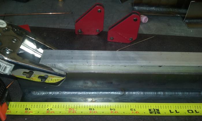

So you just do a couple of inches at a time? They're giving me joints that are about 12" long. The first time I tested they told me that they sometimes do runs that are 30 feet long.

I just stopped there, with the thin metal if I were to continue it would warp and pull around.. you could stitch it across in 1.5"-2" sections then go back and fill those in. At that point you have starts ands stops to worry about.RamboBaby wrote:So you just do a couple of inches at a time? They're giving me joints that are about 12" long. The first time I tested they told me that they sometimes do runs that are 30 feet long.
Depends what they are asking for with the test....I would weld a 16g fillet 36" long, would it stay straight, most likely not
I stitched it in about 2" sections, then filled in the gaps a few minutes later. Apparently I'm moving way too slow because I got very little color other than gray and silver. Can't figure out why some of the sections were silver because my travel speed didn't increase.
The pieces that they had me test on were about 6" X 12" so it really wasn't gonna warp too much if I gave it a minute to cool. That's definitely not the case with the practice pieces that I picked up today.

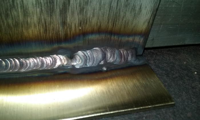

I don't see 16ga stainless and anything more than about 45 - 50 amps. It'll allow to slow your travel speed just a bit and not have your puddle out of control, but still enough so that you can move along the joint.
I work with a lot of stainless for poultry (we do lots of contract work for the local tyson plant) and I got lucky as all get out when I tested for my job. I hadn't really welded a whole lot of stainless before hand, and I was still in school at the time as well, but I made sure that day I was in the dime layers club.
The faster you can get that puddle established and start moving, the better. Stainless is super sensitive to heat input. The coefficient of thermal expansion is 1.5x that of carbon steels, and the fact that chromium is reactive to heat, and when it gets hot it get bombarded by oxides like crazy! Proper shielding will also go a long way as does a tight arc length. I'll run stainless on the edge of nipping my tungsten in the puddle, and always with a gas lens.
Best advice I can give is just keep goin for it

Your consistency is on the way there, but your heat input is way too high. You need to either turn downs the amps or move faster across that joint. That dark burnt purple is the hexavalent chromium burnt off which defeats the purpose of stainless to begin with. I'd try to move along the joint faster.
Cold beer and cash money!
That's about as fast as I can move. My hands aren't suited to feed with my thumb so I use my first and second fingers to extend the wire into the puddle. This causes problems with missing the mark if I don't feed slowly because the filler is moving in an arc instead of a straight line. I guess I'm just gonna have to turn the heat down.

From the looks of that weld, you are weaving your torch. I can't really tell from the pic but if thats only 14ga. you don't need a weld that wide so weaving to get a wider and fuller bead is smoking that thin metal. It looks like weaving because you don't have that stack a dimes look. Like I said, I can't really tell from the pic so tell me to shut up if I'm wrong but thats what I see from reading that weld.
Yes sir, I have been weaving to compensate for the fact that I have never been able to stab the rod straight into the puddle. I pretty much learned how to tig with aluminum because how I feed the rod into an aluminum puddle didn't matter. Because of your post I just went out to the shed and tried feeding with my thumb. Apparently I have developed a much lighter touch now and feeding with my thumb went just fine. As a result the rod is now feeding in a straight line rather than an arc. Now I'm gonna go try actually welding like that and I'll post pics of the results. Thanks for the "Eureka" moment!exnailpounder wrote:From the looks of that weld, you are weaving your torch. I can't really tell from the pic but if thats only 14ga. you don't need a weld that wide so weaving to get a wider and fuller bead is smoking that thin metal. It looks like weaving because you don't have that stack a dimes look. Like I said, I can't really tell from the pic so tell me to shut up if I'm wrong but thats what I see from reading that weld.

You bet bro! I can't feed rod worth a damn so I had to get good at hiding my starts and stops. Go get 'em!
Brother!,
I owe you a few pitchers of beer at least!
I started out with my same old BS and then asked myself, "Self, what in the hell are you doing?".
Then I straightened up and just look what happened!

YOU NAILED IT! Good color too! Bravo! There is no shame in starting and stopping. We all strive for excellence but in the real world sometimes it's not completely possible. I wish I could do big long runs but I never get the kind of work that requires long runs so I concentrate on making my short runs look good and my start/stops almost unnoticeable to the untrained eye.
