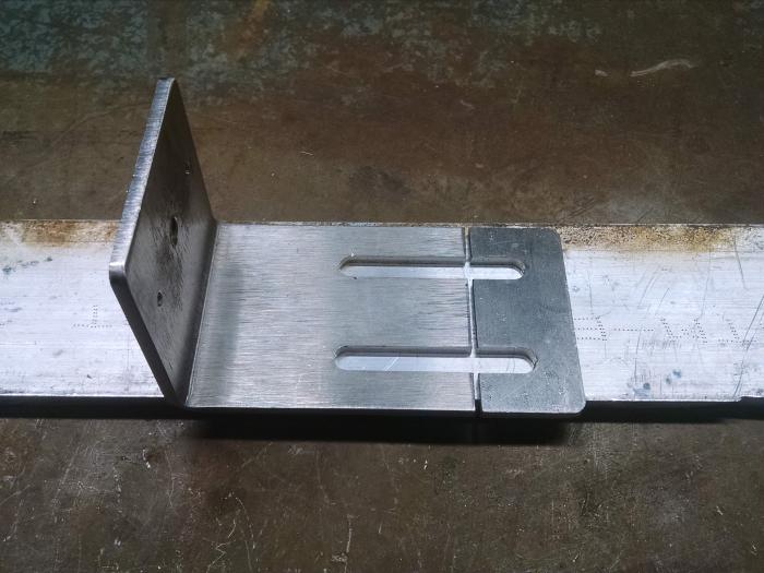

- Tabs for a guard 13g to 16g

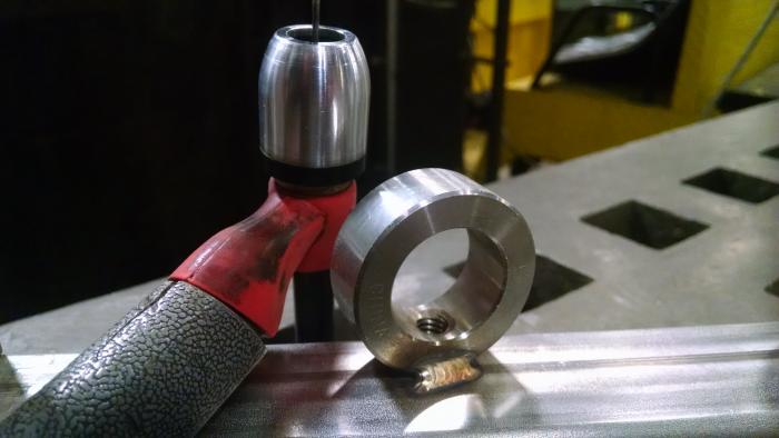

- Rosette weld
- IMG_20160629_224223.jpg (57.61 KiB) Viewed 2983 times

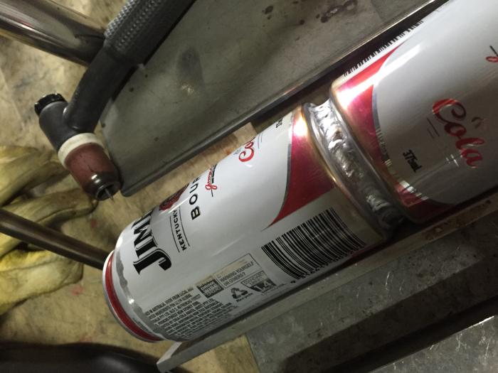

Didn't have any proper work on so spent the weekend messing around in the shed doing the 'ol can and razor blade exercise. Had some trouble blowing through the cans until I got everything dialed. Pretty new to using a foot pedal so it felt like it was beneficial having to actually work it a bit.

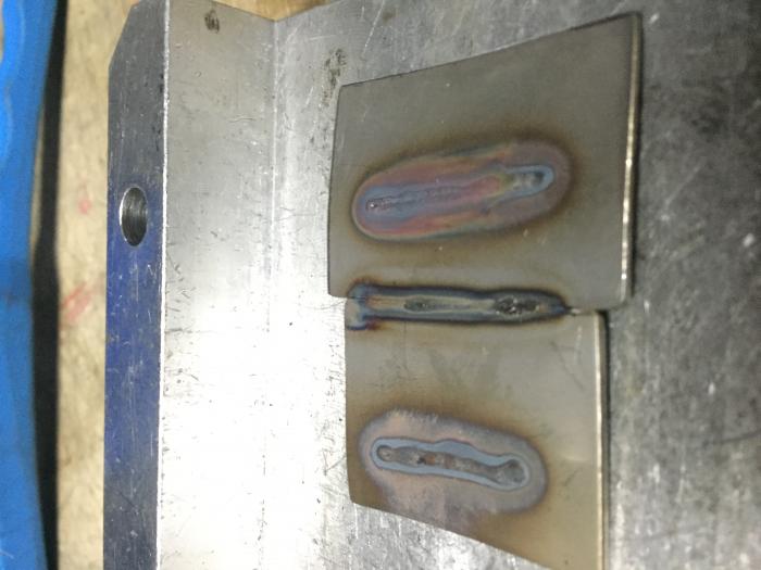

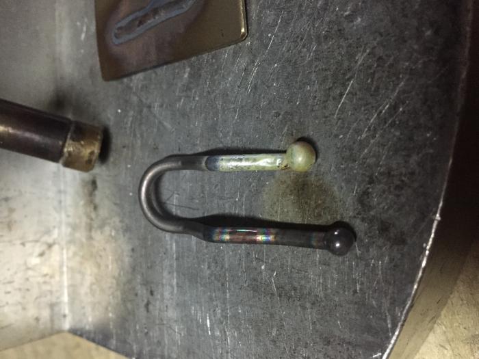

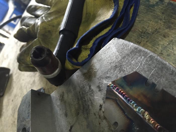

Decided to use the stainless box I welded up and posted a few pages ago and make a purge box similar to Jody's. At the minute I don't have a proper dual flow meter yet (on its way), just a little flow control off a pneumatic cylinder. I think I may be a little low on the flow, as I notice a lighter goes out before I weld, then after I can light a lighter in the Box? Does the weld burn the argon out? Never heard of that, maybe I am disturbing the air in the box moving around in it? Seems to be working to some extent but maybe not as well as I would like. Will wait until I have a flow meter on and troubleshoot. Also have some mesh to go over the top, just need to guillotine it.
The box:
Then some Stianless, Middle was on some copper, other two in thin air at 70 amps. Ignore the pin holes/craters as I had it set on my tack setting, no down slope.

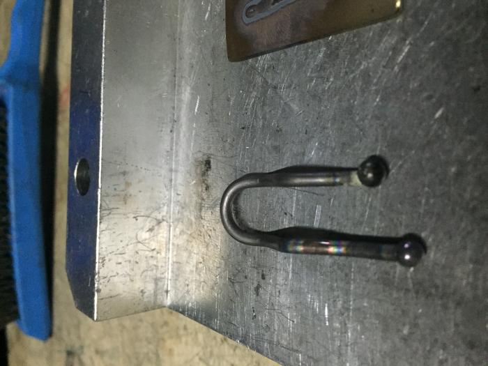

Then I had a piece of material which I think is Titanium, it is from a anodizing line from my work. Seems very light and strong. The short side I didn't use much gas, out in the open and tried to get it real hot and pull the shielding away. I think the white stuff is contamination from being in service, however the metal didn't seem to color like I have seen titanium. Then heated the long side in the purge box it did seem to color out a bit and to me looked like titanium. Any experts on here know what it might be? I did get brittle on the side I burnt and didn't shield. It was just on DC, much like I would weld stainless and seemed like it would weld if I tried. Also seemed to stay red hot for a long time, yet cool rather quickly. Seemed to be able to file it slightly. interesting......

The white flakes or even somewhat like a powder on the Ti is from a (dramatic) lack of shielding as you discovered, the colors in Ti show different levels of contamination depending on the shielding, or lack there of.nortical wrote: Then I had a piece of material which I think is Titanium, it is from a anodizing line from my work. Seems very light and strong. The short side I didn't use much gas, out in the open and tried to get it real hot and pull the shielding away. I think the white stuff is contamination from being in service, however the metal didn't seem to color like I have seen titanium. Then heated the long side in the purge box it did seem to color out a bit and to me looked like titanium. Any experts on here know what it might be? I did get brittle on the side I burnt and didn't shield. It was just on DC, much like I would weld stainless and seemed like it would weld if I tried. Also seemed to stay red hot for a long time, yet cool rather quickly. Seemed to be able to file it slightly. interesting......
Cheers
For art work using Ti the colors can be used to the advantage of the artist, but for most weldments it's not desirable.
Looks like your box project is almost done, keep playing with it that's how we learn.

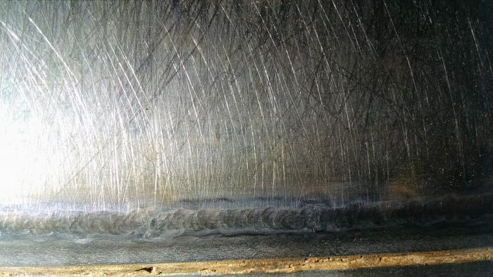

Fun repair first day back...all due to lack of following proper procedures for getting product off the sides off the hopper....a dead blow isn't in the procedure. Job security.....
Had to put my harness on and hang upside down and weld in a 1.50" pipe that was ripped off and about 30" of seam...316L 16g. All in all happy with the results....
