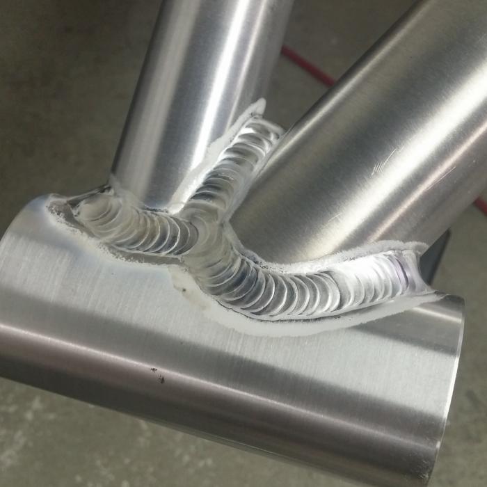

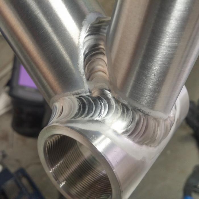

Working on my wiggly foot.

Awesome!

zank wrote:Working on my wiggly foot.
I think excellent modulation not random wiggly ;)

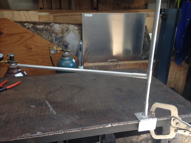

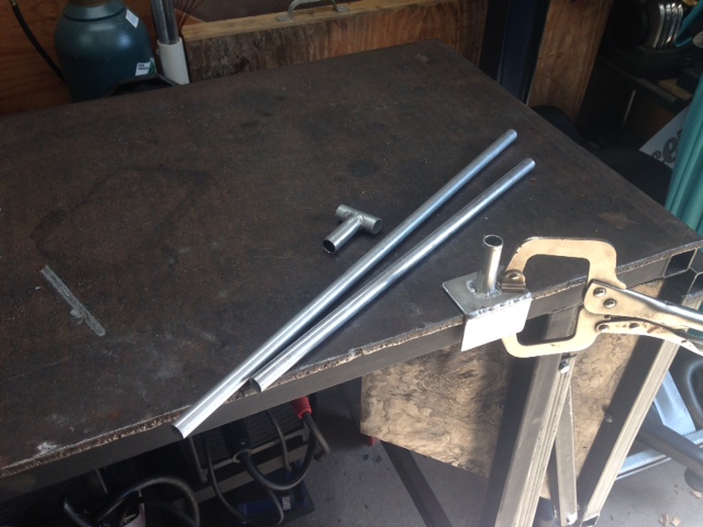

I welded up a light-duty steady rest out of aluminum tubing (0.75"/0.0625" wall) left over from folding kayak building projects. Nothing fancy but I felt it was a good chance to practice several skills: 1) welding aluminum 2) welding small diameter tubing and 3) coping tubing. My welds won't win any awards but I managed to weld the coped T-joint without much distortion on the inner wall so it still slipped easily over the 0.625" tubing. The rest slides easily but "locks" into place once a little pressure is applied to the horizontal rest. If I find the rest slips on the vertical post, then I will add some sort of clamping mechanism. For now I like how I can swing it into position and swing it away once done.
I have other ideas but needed to see if my skills were ready for thin wall small diameter aluminum tubing. Based on this success, I plan to use more aluminum tubing to make a set of custom dog transport barriers for my car to transport our 3 dogs safely w/o needing crates.
Assembled and ready to go
Disassembled
Disassembled

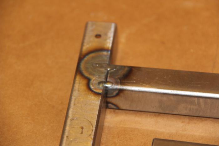

I cut and tacked together the pieces of a mirror cell (holder) for a telescope I'm making. The flavor I'm making is called a suitcase dobsonian. The telescope pieces come apart and nest together into a box (suitcase) to make transporting it easier.
Here's a close-up of one of my tacks.

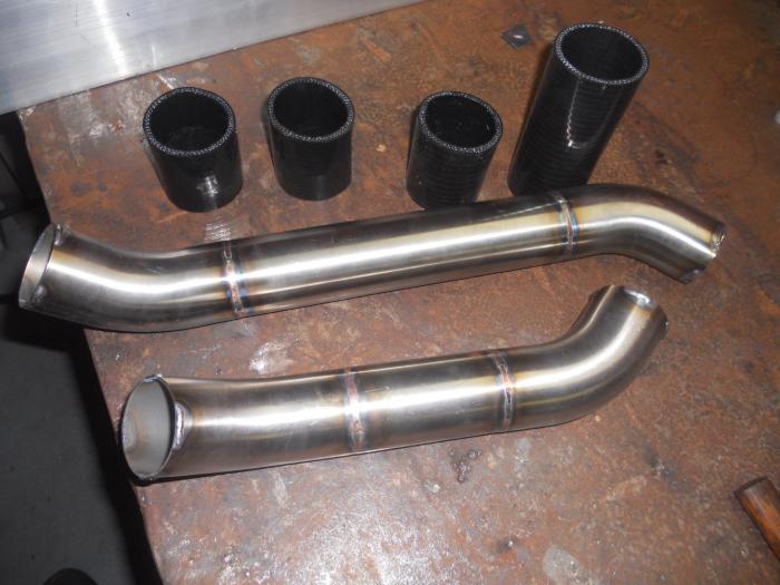

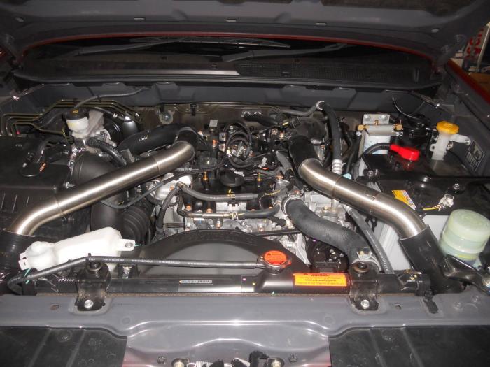

My first what I welded today.
Nothing special, just a pair intercooler pipes to replace the troublesome rubber ones.

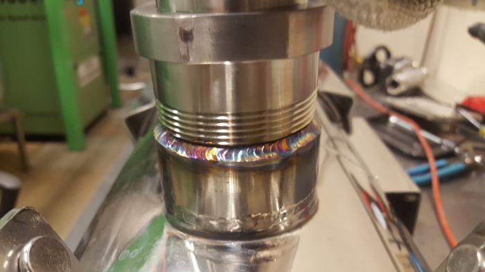

Not a fan of leaky NPT connections so I welded up the tri-clamp adapters in this bag filter housing. Hopefully I'll have time to install it on our membrane filter skid this upcoming week.

Nice I like the Dixon fittings, I also use Andron...

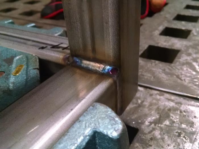

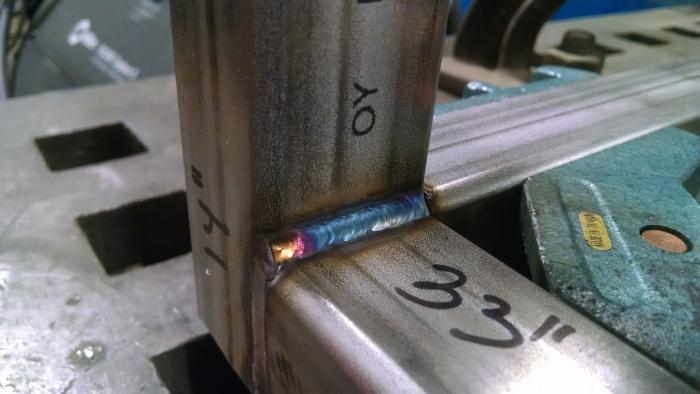

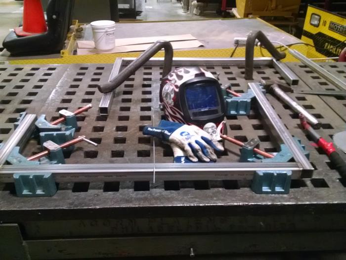

Started making a cart for use when washing and sanitizing some machine parts...304L 1.5 x 1.5 .125" wall. I like making stuff like this, once I start building I don't move it, good practice for welding in all positions.
