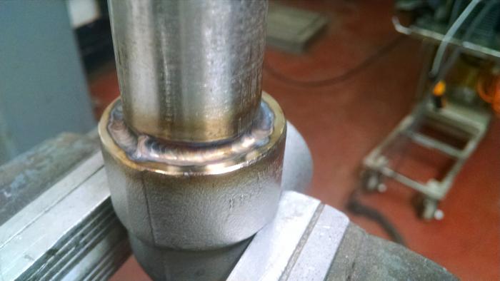

- Root
- IMG_20160220_165555645.jpg (30.33 KiB) Viewed 1430 times
- Sanitary
- IMG_20160504_231549953.jpg (58.8 KiB) Viewed 1430 times

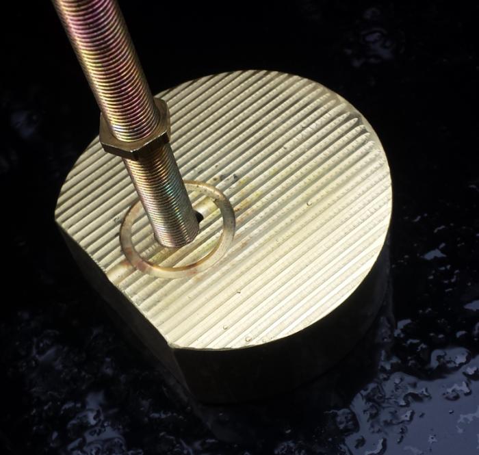

- sink.jpg (68.28 KiB) Viewed 1337 times
I'm conflicted about whether or not to mill a circular channel in (gap below the weld bead) for the argon to directly back the weld or to leave it as-is so that it supports the back side while it's hot and wicks away the heat directly from the back of the weld. Without the channels, I don't think the argon will flow there, but based on previous results, I really don't think sugaring will be a problem anyway - especially with such a tight fit. This question is in the vein of Jody's video about "good enough". What do you guys think?

Thanks. What do you think about using it like it is versus adding a circular channel under where the weld bead will be?
If you can assure it will fit tight then you could use it as is but to eliminate any variables and since you have the tools and ability, I would groove it out for argon backing. I use to play around making all sorts of purge boxes and gas diffusers and it always seemed that they would never work out in a new spot so I just purge the whole keg and be done with it. I bought a 150cf. bottle off Craigslist and I use it exclusively to purge kegs. Once I know the keg is full of argon(I check by holding a lit log match inside) when the match goes out, I set my flow for about 5cf and weld. It doesn't use as much gas as you would think and I shut the bottle off while I am waiting for stuff to cool.glassTransition wrote:Thanks. What do you think about using it like it is versus adding a circular channel under where the weld bead will be?

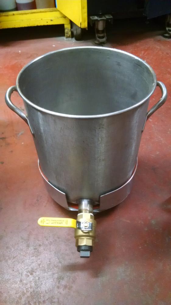

- all complete, leak tested ready to rock
- IMG_20160521_223647158.jpg (53.34 KiB) Viewed 1319 times
- as you can see my closet hole saw was not close enough, then when it grabbed and ripped the bottom it made it oval for me
- IMG_20160521_210503.jpg (47.08 KiB) Viewed 1319 times

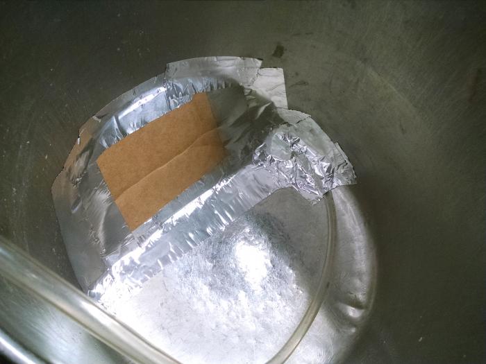

- purge dam
- IMG_20160521_210902[1].jpg (43.11 KiB) Viewed 1319 times
I think we should create a thread on purge dams. There are times when you have to get pretty creative to make something work. I use foil tape also, it works great. Has anyone ever made a makeshift cup to get into and area that no ceramic would fit? I did it once but never took any pics.

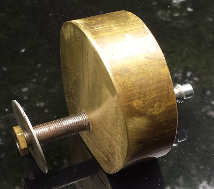

Here is the modified heatsink:

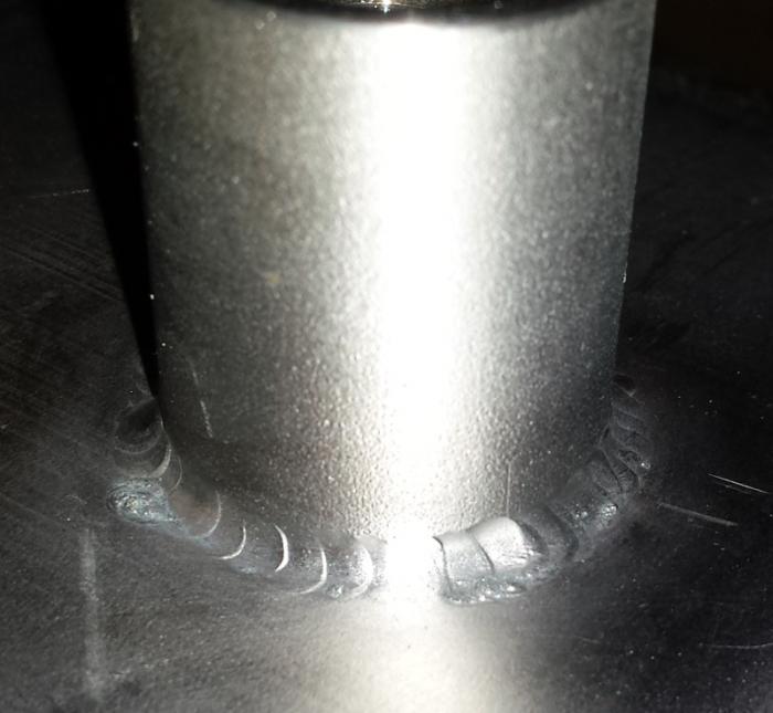

Here is the outside as welded. It got a little hotter than I wanted but I was trying to ensure I go full penetration.
Here are the inside on my test piece where I could see what I was doing and the inside on the actual where I couldn't:
Here is the outside cleaned up after I fused the inside. It sucked in a little which I didn't expect.
Welding the outside was no problem.
For the inside, I machined a shoulder on the welded side of the fitting and drilled the hole a bit smaller so it sat on a ledge. This made fusing it inside really easy when I could see it because about half of the wall thickness protruded through the hole so the seam was clearly visible and I had plenty of material to work with. I would just go all the way through in the future because it would be way easier to get full penetration and not have to worry about fusing inside. I didn't drill afterward as I had planned because it was impossible to fuse the inside that way.

WOW! Your filet weld on that coupler is fantastic. Heat control looks really good too. Your other welds look great too! You definitely got a great start. See, it's not hard it just takes practice. Nothing in welding is new. Great job! How did your purge puck work for you? I can kind of understand how welding on kegs can be a little intimidating but some guys try to make a complete science of it. Very nice work!

The heatsink / purge worked perfectly. The back was shiny silver after welding. I taped around it and punched one small hole. I ran it at about 5 cfh.
