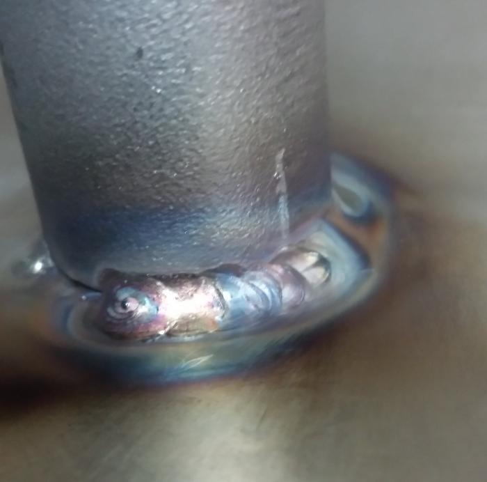

- top.jpg (32.57 KiB) Viewed 1485 times
- brushed.jpg (35.17 KiB) Viewed 1485 times
- back.jpg (44.39 KiB) Viewed 1485 times
Not really too hard to control with heat sinks on the back. My A game is probably about equal to most of your C games so I'm not sure my A+ will help too much LoL!

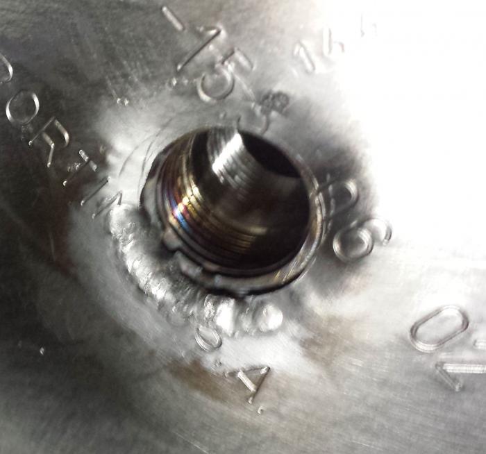

Getting my heat set by running a bead just on the keg wall I had my max set to 70 amps and was running around 40, but when I did the actual joint with the copper and aluminum blocks, I had to turn it up to 110 and stand on it to start the puddle.
I didn't want to waste argon on the practice so the back didn't have any purge - just the sink which I think may be good enough - what do you guys think? I just hit it with a quick wire brush. I doesn't look like the oxidation (chromium whatever) penetrated at all.
I don't know that the dimple adds much, but it also wasn't deep enough to stretch to the OD of the fitting. I'm conflicted as to strength pros and cons. It will thin the material and possibly make it brittle around the edge if I go that far, but it will also make the keg wall a bit more rigid. I'm thinking now that I'll put a small hole in just for the gas to flow through and then drill and countersink up to the ID of fitting after welding as exnailpounder suggested. I have to go beyond just drilling to the ID because it's a two-way fitting and it wouldn't be possible to screw something in from the inside otherwise. It looks like the penetration will be good enough to not have to flow the inside, but if I do it should be very little heat.
OHHH...you put the fitting on the inside of the keg! I usually put them on the outside...I guess it doesn't matter. I guess we were kind of talking about 2 different things. Your weld look fine and it looks like you controlled your heat input really good as you have decent color. I know we all strive for beauty but there is no shame in stopping and starting a weld. Welding around one of those little couplers isn't possible anyway. Nice work! Show us the final outcome and then when the word gets out you can weld fittings on a keg you'll be a busy boy

Thank you for the help. We are talking about the same thing.
I will put the final one on the outside. I just did this one inside because the Sanke thing on this lid cutout was in the way

That looks like quite a trick.
Did you just feather from the thick to thin or did you use some internal sinking?
I did feather out the bead from the thick to the thin and used filler to control the heat a bit. I would weld about an inch or so and stop, throw a wet rag on the top to draw out some heat and then weld on the opposite side. I also used a thick copper disc inside it to hold in the purge gas that also drew out some heat. The result wasn't very pretty but there was no warping or distortion or more importantly, heat cracks.

I put four evenly spaced tacks on and then welded 1/4, opposite 1/4, backstep 1/4, and then the remaining 1/4. I let it cool a bit after each section and then removed the heatsink and dunked it in water. Does that sound workable or do I need to take all of remaining heat out of the stainless too with the wet rag? I'll do it anyway BTW just to be safe, but I'm curious how much is really required?
