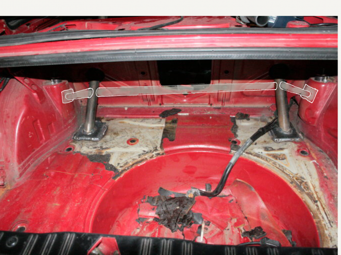

BigD wrote:The back stays are terminated on top of the stock spring perch area. This was part of the original roll bar and it's too much work to improve for now. At some point I would like to tie it into the strut towers and diff mount.
The backstay angle looks good and that is at least somewhat reinforced metal they are tied to so from the safety standpoint you seem ok. If you were going for frame rigidity, it wouldn't be perfect but you could tie the towers in from the sides like this without it being a huge amount of work. Granted, the only thing I like less that welding while contorted around a brake rotor is the joys of climbing into a trunk to weld...
tower linkage

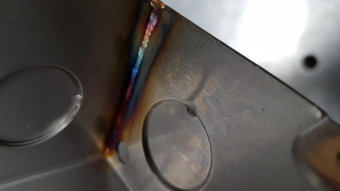

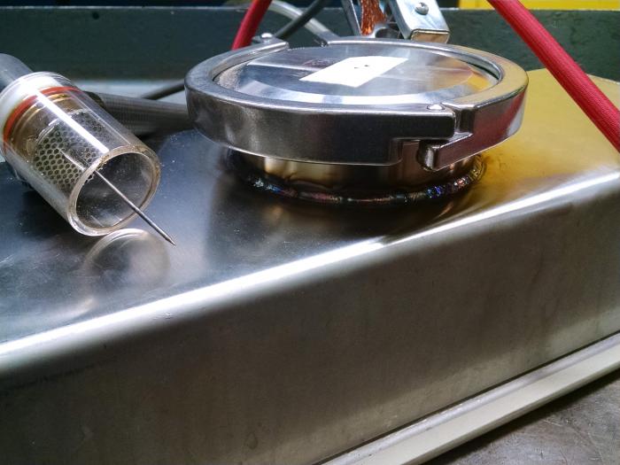

Had a run of 300 of these little 20 gauge 304 boxes to do today. Need to be water tight and full pen. Boss doesn't believe in purging lol used a block on the accident to trap the gas

Rick_H
    Sat Feb 08, 2014 1:50 pm
    PA/MD
Custom parts for a bottle dryer I designed
Back purged... Tight area
Inside,
Inside,
Rick_H wrote:Custom parts for a bottle dryer I designed
Looks good Rick, seeing your weld reminds me of my last employer who was emphatic about us brushing our sst welds.

Mine all get pickled clean, and polished in most cases...
Pickled... Still need to polish it out when I'm done
