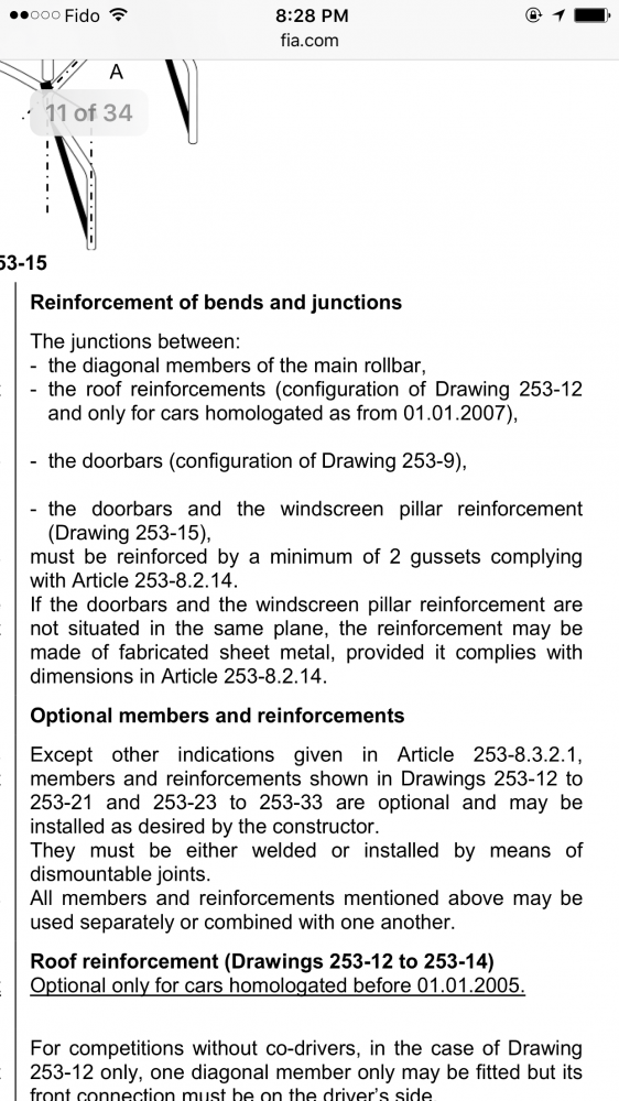

I've been referencing the FIA spec for ideas and like the whole spec, it's pretty excessive for the amateur level but I've been modifying my kit with things I can reasonably do and I feel add significantly. I've seen some incredibly violent crashes with no major injuries where the cars had cages that were the typical SCCA spec, and didn't half the stuff in the FIA doc. For instance for gussets it's more than just Xs:AFR_Autoworks wrote:So it appears that there are quite a few cage builders here! That is very good to know. Pretty much all of my cages, with the exception of drag cars, get built to FIA specs. I honestly don't know one form of road racing that does not accept thier regulations. I would certainly recommend anyone who builds cages to familiarize yourself with those regulations. Allot of really good practices to follow, such as gusseting every junction that forms an "X". In the event of a crash the tubes that intersect will crush the tube that is one single piece. But enough of that... Here is a weld that I recently did on a tubular front end for a drift car I am constructing. This weld is 18ga cold rolled welded to 1.5" .095 DOM tubing. I have not had much luck with these welds in the past but I think I finally got a technique I am happy with!

Every joint specified that requires gussets is where there would be two bars intersect to form an X. I would certainly agree that for most cases FIA is overkill. It is just great information to know. I find drift cages to be an absolute joke. Mind you the crashes that a drift car will see are very minor compared to rally.

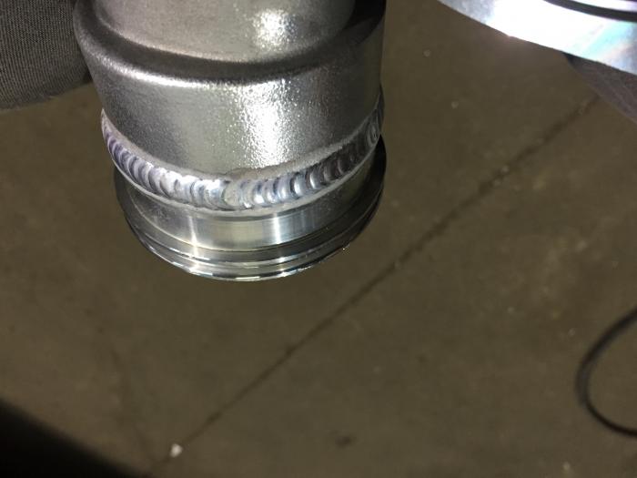

Made a grinder stand out of a tv stand I found in the desert. The main support is pretty sturdy. The base piece is really thin, but it will do until I can find an old wheel in the desert. It looks tall in the pic, but it's chest high.
Just ran out my second small tank of argon ( second went quick because I accidentally had it flowing 25cfh instead of 15)
I think I'm coming along alright.
Close up of base joint. Blows out so easily even from a tack.
This was almost good, I just started after the tack instead of on the tack.
And finished product.

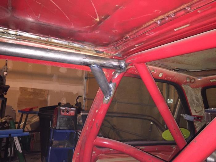

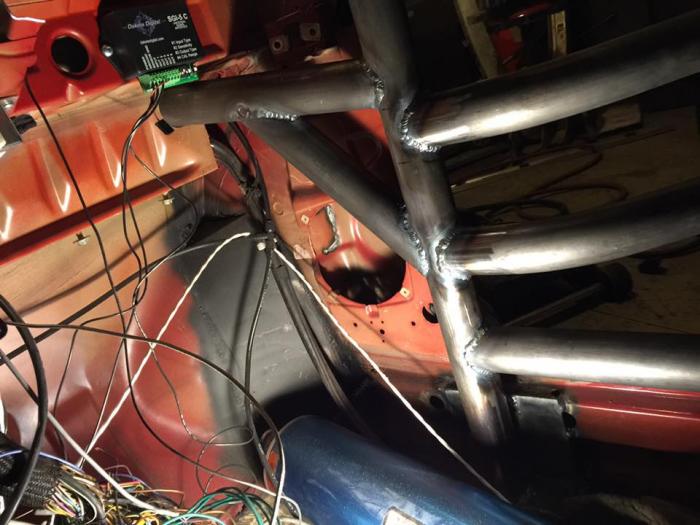

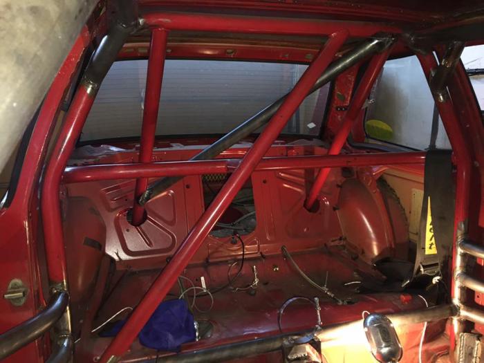

Completed all of the additions I wanted to do. I couldn't fully weld the forward/upper joint on the gusset bars for the strut tower bars, will weld a 1/8" triangle plate in there to make up for that.

Looking pretty bombproof BigD. FWIW, I looked through the FIA regs and they regard the bend in the belt bar as totally kosher so I'm not sure why lemons is mostly opposed to them. I've got a race next month and I'll ask then.

Just out of curiosity, how did you terminate the back stays?

No problem, I am happy I added the brace across the bottom. While I'm not worried about the bent belt bar, there was still nothing really keeping the bottom half of the hoop from caving in, especially on the driver's side. Now there is. I also tied it to the trans tunnel so it should add a bit to the stiffness.

Agreed. At a club race last year a guy crashed head on into the pit in wall at Mosport. It's a CMod car so he was probably cooking at a good 90mph when he lost it. The front of the car was just gone but all he had was a broken foot from the wheel intrusion. I added a bar to the wheel well to hopefully prevent that.Sandow wrote:There was a driver in another car that died my first race. He had a massive MI approaching the last turn (CMP turn 14) and T boned the wall at around 100. The front of his car was just gone. Autopsy showed that if he hadn't been dead already he would have walked away though. Passenger compartment was undeformed enough that the doors still opened and closed normally. Makes an overkill cage seem well worth the effort.

The back stays are terminated on top of the stock spring perch area. This was part of the original roll bar and it's too much work to improve for now. At some point I would like to tie it into the strut towers and diff mount.
