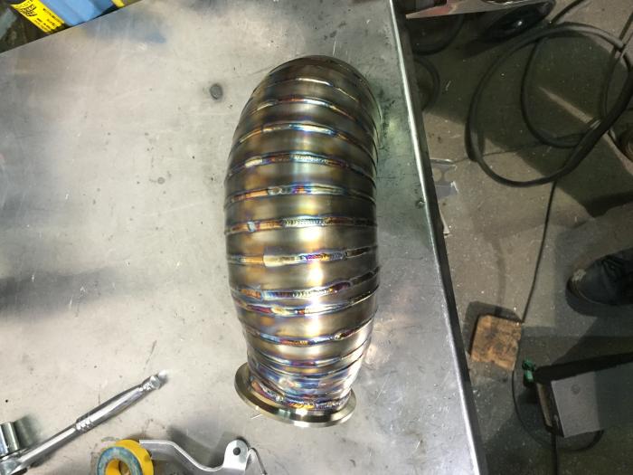

Pie cuts tend to get crapped on by allot of people. The truth is they are EXTREMELY helpful. I had to bend this downpipe elbow up to clear the wastegates and then down right away... All while transitioning from 3" to 4". They 4" bends I have don't have a tight enough radius to do this.
- image.jpeg (49.98 KiB) Viewed 1997 times
- image.jpeg (50.48 KiB) Viewed 1997 times
- image.jpeg (33.64 KiB) Viewed 1997 times

Pie cuts work however plain and simple, very nice job..
How are you cutting?

I cut with a water cooled band saw and deburr with a belt sander. I used to use a chop saw but it was terrible, more time deburring and dressing then actually welding them. To calculate them I always do 5 degree cuts so each piece equals 10 degrees. Some people do 4.5 degree so you can make 45 degree elbows but 5 works well for me. To adjust the radius of the bends you just change the length of the pieces. If you can deal with welding paper thin metal on the inside of the bend you could essentially do a 0 radius bend

Also, I tack welded a 3-4" concentric reducer to a piece of 4" stainless so I had a piece to clamp to and reference to make sure it was straight. I then pie cut the reducer. This was my second time doing this and it works like a charm!

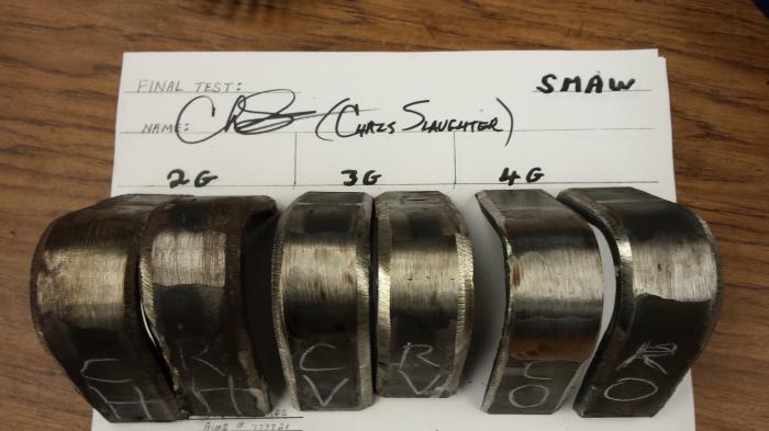

I started welding school last May 18th. We aren't supposed to finish until April 15th.
AWS certification on all four processes, 2-4G.
I passed my last final tonight.

- Stick....
- 20151215_160930.jpg (37.1 KiB) Viewed 1938 times

Awesome job Chris, always nice to finally have all those bend tests completed. No matter how confident I was I hated watching those bend...lolLtBadd wrote:Congrats ChrisRocketSurgeon wrote:I started welding school last May 18th. We aren't supposed to finish until April 15th.
I never could follow the rules.
Your hard work is paying off.

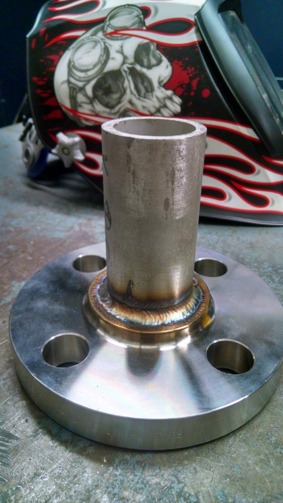

More pipe, I have the whole bypass loop finally done I'll post tonight, next up welding the leg in up in the ceiling... Yippie

- Flange
- IMG_20160223_230833742_HDR.jpg (78.83 KiB) Viewed 2084 times

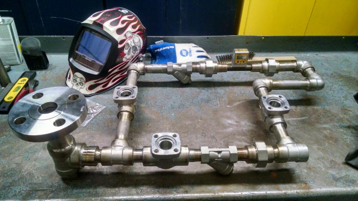

Bypass loop completed, tie in tomorrow and replace the entire leg in stainless.
- IMG_20160227_171152.jpg (49.77 KiB) Viewed 1939 times
- IMG_20160227_171514489_HDR.jpg (50.75 KiB) Viewed 1939 times

As a retired mechanic at a food factory I must thank you for the unions and their respective positions. So many times either one of our people or a contractor socket welds these in so you cannot even begin to remove and repair. THANK YOU ahead of time.Rick_H wrote:Bypass loop completed, tie in tomorrow and replace the entire leg in stainless.
bruce991 wrote:As a retired mechanic at a food factory I must thank you for the unions and their respective positions. So many times either one of our people or a contractor socket welds these in so you cannot even begin to remove and repair. THANK YOU ahead of time.Rick_H wrote:Bypass loop completed, tie in tomorrow and replace the entire leg in stainless.

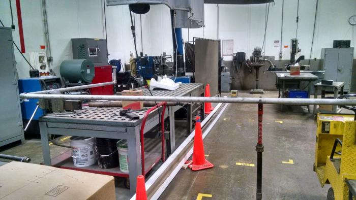

Thank you Bruce! I to am a mechanic at a food plant, and like you it pisses me off every time I have to do a repair and there is no Union in sight. People really don't think about future repairs.w
- IMG_20160228_180104054_HDR.jpg (31.13 KiB) Viewed 2057 times
- Leg done...just have to weld the flange once it's all aligned.
- IMG_20160228_232338505_HDR.jpg (50.12 KiB) Viewed 2057 times
- I'm on it today...
- IMG_20160228_232312592.jpg (49.19 KiB) Viewed 2057 times
