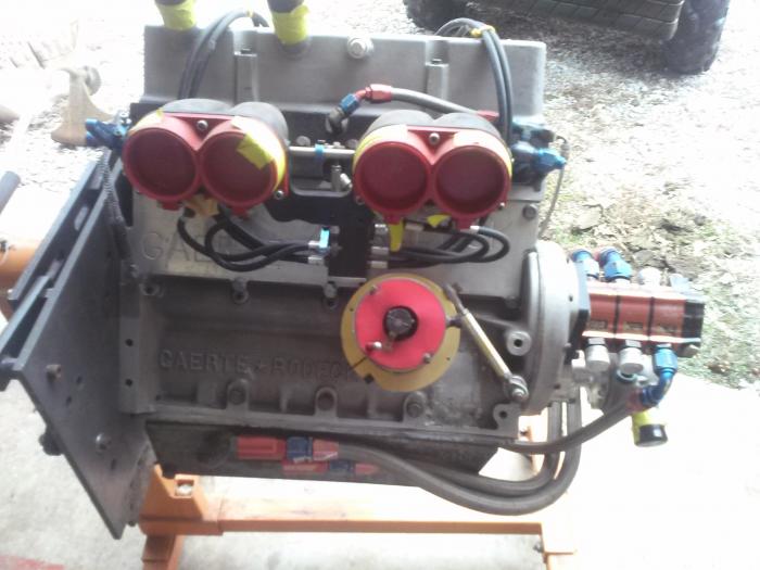

The block is cracked near the crotch of one web.
I will get a 75% blend and pay attention to the pre-heat, I'm hoping to get enough heat. We have an old gas grill rig that will sit under the block and a darned smelly and heavy old fire blanket for over the top. I have 2 old hand held, corded probe pyrometers to keep track and watch the cool down. and a laser shooter for comparisons from top to bottom, front to back. Yes I will sweat, good excuse for an old fat guy to sweat besides tying his shoes or whatever..............
The eventual engine will be completely re-machined, new sleeves and all that. Still a grenade, 7 used Oliver rods and 1 new one, 7 used Mahle pistons and 1 new one and on and on. I have seen grenades like this blow up first time out and I've seen them last until they were too worn out to hurt themselves. It'll be 14.5-15 to 1 and probably be cammed for 8000rpm ish. 410 sprint car. Fuel injected, a salvaged set of -12 Brodix heads, a little baby 2.562 fuel injection. Short track motor, dry slick.

- 0131161334a.jpg (43.72 KiB) Viewed 1728 times
- 0131161334.jpg (48.49 KiB) Viewed 1727 times
