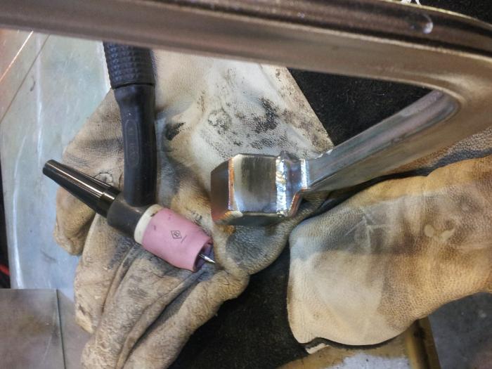

Nice stuff Skyline and BigD ! Out here in the garage getting ready to tack up an aluminum box i'm making ...my welding clamps don't grab under my harbor freight welding table due to its design . Decided to mod my clamp. Cut off a short piece of 0.055" square tubing ...cut a little piece of flat stock to cap it ...then clad the top with silicon bronze .
Got a little sidetracked !

.055" square tube! Maybe you mean 1/2" ? What is that receiver in the background, a Marantz?subwayrocket wrote:Nice stuff Skyline and BigD ! Out here in the garage getting ready to tack up an aluminum box i'm making ...my welding clamps don't grab under my harbor freight welding table due to its design . Decided to mod my clamp. Cut off a short piece of 0.055" square tubing ...cut a little piece of flat stock to cap it ...then clad the top with silicon bronze .

It's 1" square tubing , digital guage says 0.055" thick , it's all I had , the flat stock I capped it with is 0.125" .

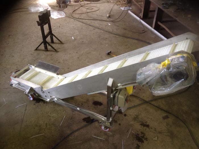

Some old job, steps, platform and railing on SS corn hopper in popcorn factory. 2" schedule pipe bent, some 2" boxes and 1/8' checker plate. Cut, bent and tig'd together.
Below conveyor for popcorn as well, had to fabricate 5 of them as health and safety inspection did not like the rust on the old ones. Pretty nice job, a bit tricky to weld cross brackets holding the sides as easy to distort the 1/8" side plate.

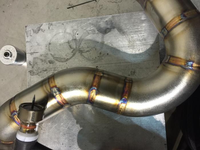

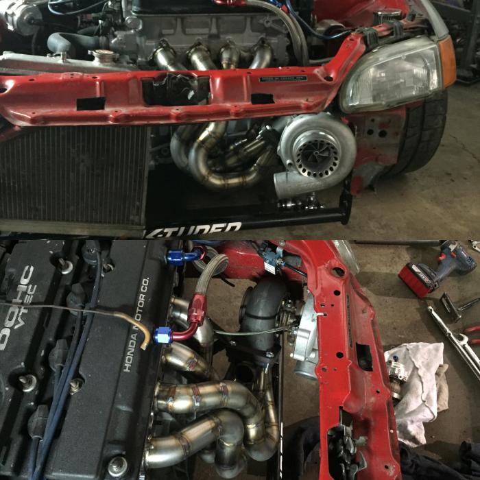

Working on my first turbo manifold.Every time I pick up my welder I find myself getting better!

Are the runners of the turbo manifold being kept equal length?AFR_Autoworks wrote:Working on my first turbo manifold.

Yes, the runners at equal length and also equal degree of bends. I did change one runner from the way it is in the picture. Also, no pulse. Sch10 304ss welder set at 100amps but pedalling out. I get a puddle started, dab at it quickly just on leading edge of the puddle until it fills up just flush with the material. One you get the weld height continue to dab quickly and start moving. I really am fond of this technique for welding this stuff. It is easy to stay consistent.

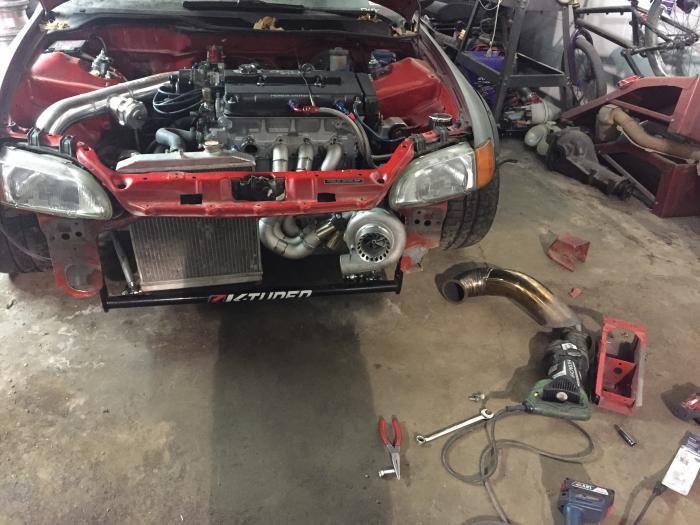

Finished product
