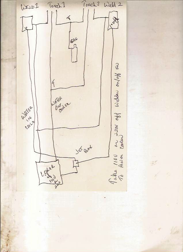

I have a Sycrowave 351 with a V3 Cooler, and I am on the verge of purchasing an Everlast 255ext. I'd rather not add the expense and use of space for Everlast's cooler unless I really need to. Both machines will pretty much live right next to one another in my shop. Does anyone have experience with two machines sharing one cooler? I would be O.K. with adding quick water disconnects to switch between the two machines since it won't happen that often. On the other hand, I do wonder about unintended consequences. Any advice would be appreciated. Thanks

I have a little experience in running more than one welder from one cooler. In addition to that I have a system that runs two torches from the same welder. There is a chance of forgetting to change lines to the welder you're using. What you can do is just let the water circulate through the welder that you're not using. It means you'll have to add a little more coolant up front, but it cuts down the chance forgetting. You'll also have to have the cooler on it's own power source, which requires remembering to turn it on before you start welding. The water lines can be teed' between the inlet and outlet of each machine.
If you forget to turn it on just once, it will be a $100 lesson, but a separate cooler adds about $300-400 from Everlast and their cooler is quite noisy, I know, my son has one.

There is a production shop I do some mechanical work for near me and all there fab guys share coolers. 1 cooler two welder. They do a lot of SS food grade equipment. Most is 1/4 in or less they've been doing it that way for years good or bad it does work.
another way
2 welders, 2 torches, 1 gas, 1 cooler.
cooler always comes on with one of the welders
just tap off of welders on/off with what ever voltage cooler needs, assume one is using 220V for both welders

Just a thought but if your the only one that will be using the coolers then it kind of makes sense to just run it through both torches in series. It wont hurt anything and you eliminate the chance of using a torch and it not getting coolant. Since it will be an analog system so long as you see flow @ the outlet window of your cooler you know both torches are getting flow and your good to go.
That is what I would do personally. If there is the chance both torches will be used at the same time then that is a different matter all together.
