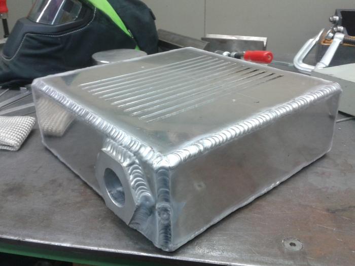

Finally I had time to continue building the "reservoir tank" for my Tig-cooler which will also work as a heat sink:
Milling the cooling fins:
tacking it up and welding:
finished tank:

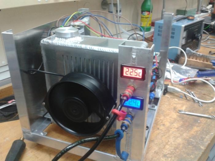

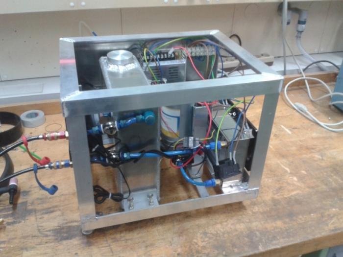

Almost finished my cooler today:
Welded up the frame:
Integrated the tank, pump, powersupply and the radiator:
First test run after doing the wiring:
Backside View:
Completing the frame:
The rest will be some sheet metall work to complete the housing and doing some safety stuff regarding the fans. :mrgreen: :shock:
There may be something wrong with your temp gauges. There reading C. :lol:
Looks Awsome

Any concerns running an aluminum tank?

Poland308 wrote:There may be something wrong with your temp gauges. There reading C. :lol:
Looks Awsome
That'll never work! It would be almost as bad as if he had measured up the project in millimetres, in which case of course the whole thing would just catch fire!

rahtreelimbs wrote:Any concerns running an aluminum tank?
I'm actually running a coolant which is especially designed for the use with aluminum. I had bad experience in the past with the wrong coolant!
Thanks again to all!

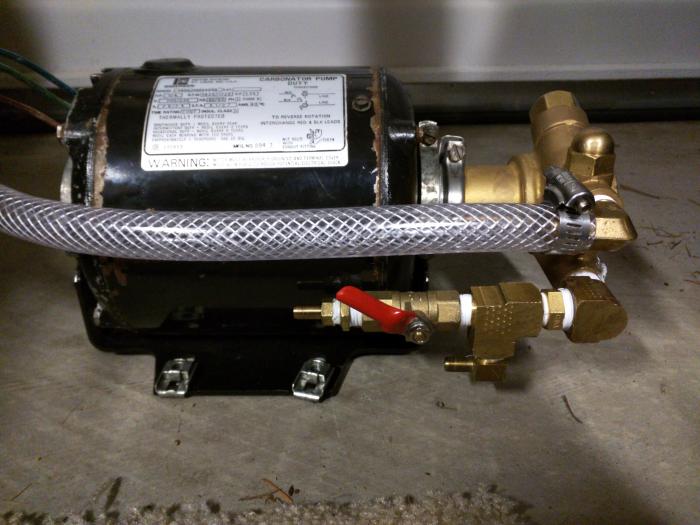

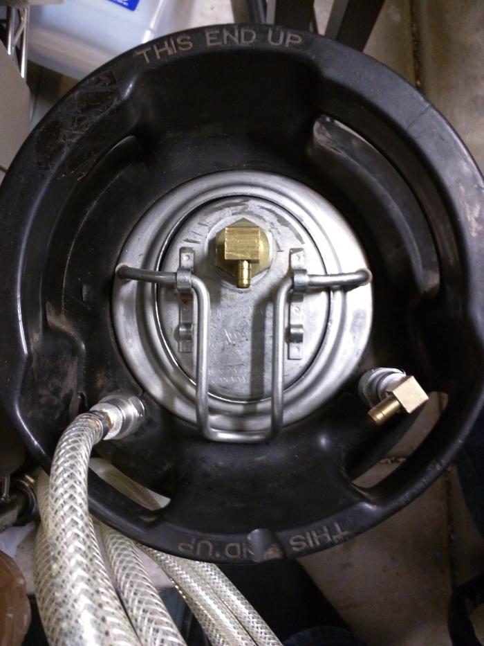

Here is the pump that I'm setting up for my cooler, along with the bypass valve to dump excess pressure/flow back to the tank.
It's a Procon that I got from a beverage equipment rebuilding company for about $60, strapped to a motor from eBay that ran $35.
I bought a retired soda syrup tank to use for my reservoir.
~3 gallons and has nice fitting on the top with a dip tube to the bottom of the tank, and I was easily able to add a return fitting in the lid to dump excess flow and torch return flow with no restriction back into the tank.
Most of the fittings were junk bin parts from disassembled equipment.
Now I just have to finish plumbing it and get it wired for power, instead of just sitting there near my welder taking up floor space!
-Josh
Greasy fingered tinkerer.
That style of procon pump has a pressure adjustment under the nut by the intake you can back out the screw for less pressure. There is a minamum pressure for some water cooled torches but you might save your self some energy by backing it down a bit. My used one came set at 115 psi.

Poland308 wrote:That style of procon pump has a pressure adjustment under the nut by the intake you can back out the screw for less pressure. There is a minamum pressure for some water cooled torches but you might save your self some energy by backing it down a bit. My used one came set at 115 psi.
I had this one spec'd at 60 psi, since the pump that I initially had purchased turned out to be a good bit overkill (1/2" NPT fittings, 120gph at 150 psi...), I traded it in on a rebuilt from a repair and service center. I explained what I was doing when I ordered it, and they even offered the lower pressure set point for the application.
The main reason I have the bypass valve there is to keep from internally bypassing continuously and potentially boiling the water in the pump, when pushing against the restriction of the very small hoses in the CK20 torch that I have. It's also a convenient place to hook up the radiator, so any coolant going back and forth to the tank will have a chance to dump any excess heat on the way.
-Josh
I agree glad the place you got the pump from set it for you. Otherwise there usually cranked up to the max.
