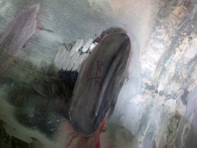

Had another go-round with Stress corrosion cracking today.
It wasn't interesting until I ground halfway through it. It later consolidated back in to one line. Here it is, ground through.
and with a root pass in.
My welds were all great today. This morning I took the last of the pills Dr. Sullivan gave me when he pulled my tooth. I was "in the zone" and "one with the puddle" and all that...
I was able to transcend dental medication.

What was your cleaning procedure after that dpt?

I was grinding through about 7/16, so I would grind a bit, and DP again to be sure I was following the damage all the way through. Between stages, I just wiped up the excess developer and kept grinding. When it was time to weld, I used first the light Naptha spray that comes with the dye-kit, then brake parts cleaner (NON-CHLORINATED!), then a good blow-dry with dry nitrogen.nathan wrote:...

That's why I asked. I KNEW it would be more interesting than "acetone and scotchbrite."Otto Nobedder wrote:I was grinding through about 7/16, so I would grind a bit, and DP again to be sure I was following the damage all the way through. Between stages, I just wiped up the excess developer and kept grinding. When it was time to weld, I used first the light Naptha spray that comes with the dye-kit, then brake parts cleaner (NON-CHLORINATED!), then a good blow-dry with dry nitrogen.nathan wrote:...
Looks like a big part, how did you do the purge?

Nathan, it was a huge part... The outer vessel of a 15K gallon vacuum-jacket vessel for liquid hydrogen. Back-purge was achieved by pulling full vacuum, then breaking vacuum with dry nitrogen before I ever started grinding (thus I'm starting with a 99.99% nitrogen atmosphere behind the weld). Then, 20 CFH nitrogen was plumbed to the vessel through the vacuum thermocouple port, and exhausted through a "blow-out plate" safety device. Argon would not be practical from a financial standpoint due to the volume, and this weld does not fall under any mandatory code, so nitrogen was more than sufficient.

Question please, how did you become aware of the crack, and then locate it ? And was this in a mounting area ?
This trailer had been in our shop 16 months ago for vacuum issues, with the same problem in the same general area. It came in this time for regulatory retest, and had poor vacuum on arrival. This was a first indication. Also, the CSS phenomenon has become common enough on these trailers that investigating that area (the rear head) is now automatic. Locating it was done through helium leak detection. With the vessel under vacuum, a mass-spectrometer tuned specifically for helium is attached to a vacuum pump. Then, I introduce helium to ever-smaller zones on the rear head, getting each time either a positive or negative indication telling me if there's a leak in that area.kiwi2wheels wrote: Steve ,

This most common location for these cracks is a load-spreading structure that attaches the inner cargo tank to the outer vessel, for longitudinal support. It transfers inertia from braking and acceleration from the cargo vessel to a broad area of the rear head, so it sees constant flexing... the "stress" in stress-corrosion cracking. The cracks also tend to prefer to start at weld grain boundaries, so I almost always find them under welded structure, sometimes in a stand-alone seam weld, and rarely out in open unwelded material.
I'll try to remember to get a picture of the overall structure the next time one is sandblasted (so the client logo does not get published with the picture).

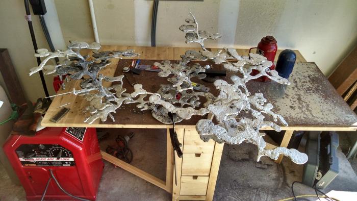

Here's what I welded today. Sorry for the long post, im a little excited lol
I have some family friends that cast aluminum ant hills and turn them into beautiful sculptures. Real quality work. G7 Artworks, they have a Facebook page if you're interested in seeing some of their pieces.
Anyways, they had a BIG mold that came out in six or so pieces. Well, last weekend I went to their house to try brazing it back together. I used flux coated brass and oxy acetylene to fail the first time.
I did some looking around and found out that my brass melted hotter than their aluminum, smooth move. That's okay, though; someone with a brain already had this problem, and, lucky for me, they work at Hobart. They made a low temp rod that's mostly zinc.
I had pretty good success with this rod on a few smaller pieces, but the big piece was 50"X35"X16" high, and would re-break under its own weight. So I gave up after six hours and had them come over to my shop today so I could try something.
I got some 1/8" 4043 stick rods and got a killer deal on some 3/32" 4043 TIG rod. It's funny, I'm one of two people in my department at work that knows you can stick weld aluminum, or that you can TIG it on DC.
Anyways, stick welding aluminum is awesome. Of course, I was just welding little pencil-sized pieces, and not any long beads, but that stuff lights up and feeds like a dream.
And there were bits where I needed some more control, so I just lit up the scratch start TIG and filled it right up. I'm pretty happy. The whole thing took about two hours, and I fixed the big casting and five or six other smaller ones. The customers were almost giddy, because they stand to make some good money on that big piece. I think I didn't make a cash profit off the job, but I got a bunch of materials left over, a very happy customer that will probably be back, and it was FUN!
Sorry there's no pics of the actual welds. They were pretty much tack welds, so nothing really fancy.
