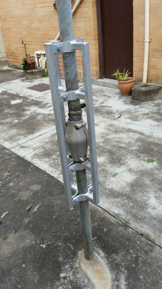

Did an air con repair at a block of flats. Owner asks me to look at his old stlye "Hills Hoist" clothes line which was busted by kids swinging on the line and you can't get them or parts anymore. All aussies will know what I am talking about here.
Here is an example of what kids do (this is an image off the web):
So I made up a brace for it. 25 x 25 x 2 (1"x1" x 5/64") square section with some 50mm pipe clamps.
Strong as anything now, owner and kids happy. :D

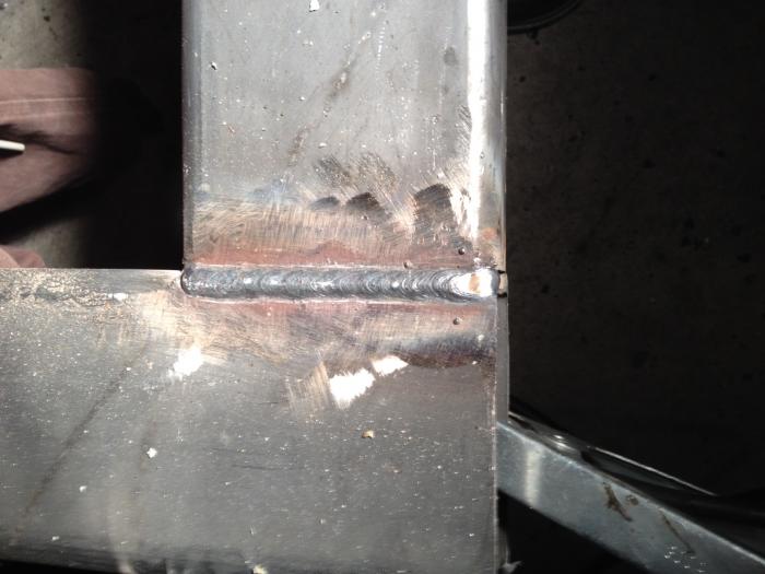

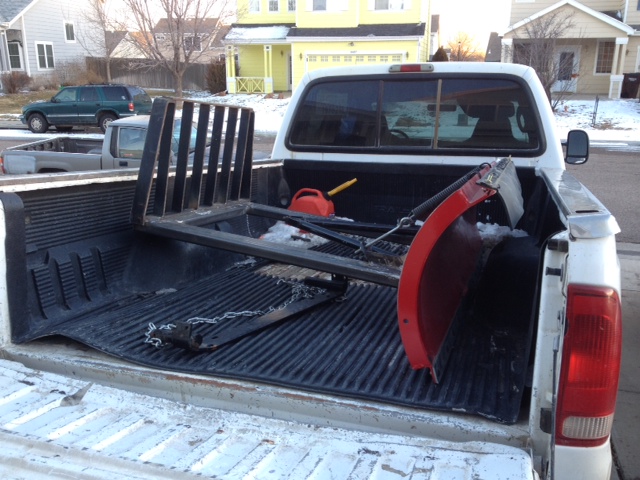

I built this snow plow with 3/16 2x6 square tube to adapt it to a fork lift. Right after I built it I delivered it to Denver and the guy tested it and ran into the concrete side walk and almost flipped the fork lift. It didn't hurt anything or break any welds mainly due to the design of a blade it is made with tons of play but it was funny.

Here is the completed plow the previous post was 4 stringer beads 1/8 7018 at 135 amps Esab mini arc 161 lts plugged in to Miller Bobcat 250

Here is just another bead 7018 at 85 amps on 3/16 tube steel.

Neat work, man. Very tidy.
