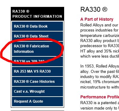

Yes I live in a right to work state, but I have one question for you Otto does RA330 weld similarly to HR120 the new job offer does a lot of that material
I have to admit, I have no idea. I would expect at least some similarity, as it's not comparing 304 to 90/10 Cu/Ni, for example.Welder kurt wrote:... does RA330 weld similarly to HR120 the new job offer does a lot of that material

Here is the information you need to weld RA330Welder kurt wrote:Yes I live in a right to work state, but I have one question for you Otto does RA330 weld similarly to HR120 the new job offer does a lot of that material
http://www.rolledalloys.com/alloys/nick ... /ra330/en/
Also there is a 12 page PDF file you'll want to read, the link is in the menu as shown in my attachment
- RA330.JPG (49.09 KiB) Viewed 631 times
