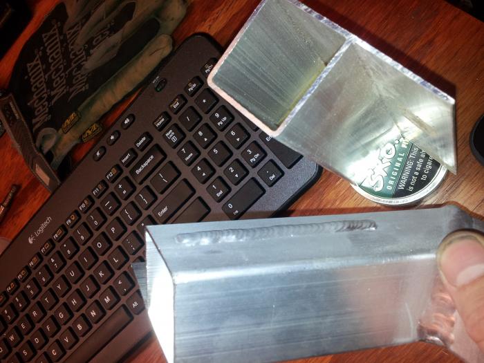

While breaking the bike down for an unrelated problem, I noticed the radiator mounting tab was cracked. The previous owner used JB weld to repair it. While I was able to get a used radiator on ebay cheap, I thought i'd try to weld this tab back on for a spare. I ground off all the JB weld, wire brushed it and cleaned with acetone, both sides.
I think it's some kind of alum alloy and figure I've got nothing to lose .... Anyway, I just couldn't get 5356 or 4043 to wet out into it . After a lot of trying, I was able to get the outside edges to fuse but the whole middle of the crack just refused to weld. Anyone have any ideas on filler rod or weldability of this ? As a test, I ran a few decent beads on some 1/16 scrap aluminum which welded fine so everything else is working. Thanks much

Thanks guys. I tried the argon from 15 up to 25 cfh ... I was at 42 amps ac (pedal), 1/16" 2% lant, I tried 120hz and 250hz , I tried anywhere between 30 and 45% EP ...I was able to get the very outside edges of the cracked piece to wet out fuse after much trying ...but the middle just wouldn't take filler ... it would just blob , I ground off the blob and tried again.
Maybe I wasn't hot enough ? I never had any burn thru issues, and I welded on a scrap piece of 1/16" 6061 box channel testing my setup next to the radiator. IDK , it just didn't seem like regular aluminum and the fact that it cracked right off with no bend . Big gear head, what amps and filler did you weld those radiators with ?

I agree with Steve on the amps you diffiently need more amps. Except for the preheat don't see any need to preheat this. You are welding thin material nothing real thick. I am guessing this is 16 gauge or so. So at least 120 amps bury that pedal once puddle forms give it some rod to stabilize it and you will be able to control amps with pedal. At 42 amps you where just putting heat into part. Remember with aluminum get that puddle going and then use pedal to bring amps down to control heat. I use art least 80 amps when I play around with soda cans.

Yeah I definitely put a magnet on it, non magnetic and also the burr ground it very easily. I just don't know what kind of alum or alloy it is ... I was trying to be careful not to burn thru it so yeah I think i'm low on amps...I did put a bead across a piece of 1/16" alum scrap right next to it, so I thought maybe the radiator was some kind of alloy mix . I'm gona grab a few bike radiators from my buddy's scrap yard tomorrow and try more heat faster , get a puddle, push some rod in hopefully. Maybe this is why it only fused at each end of the crack where the heat had less room to sink out into the piece. Guess I played it too safe. Thanks guys for all the suggestions. I'll try it again .

It had just the one rivet , but it has a coating of melted metal over the whole tab and top of the radiator .
As suggested, I went up to 60 amps and got it welded ...it was not easy, fun or pretty
...had to grind out poof's and soot a few times.
(Yes the piece was ground to shiny metal all the way around) I burned off a little of the side of the tab ...had to pulse and build that back up . Whatever this radiator is, it makes 6061 seem easy ...haha
Anyway, both radiators are welded now...and they sure aint pretty but I think they'll hold.
