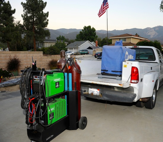

My Everlast 250 EX died a quick death today.
It's a 2011 model, Everlast water cooler, CKW torch, and the upgraded foot pedal.
It's been working fine, last week I built a coupon test bender from 1 1/2" SS
just like Jody did.
I fired it up today, tapped the pedal to check the gas flow.
It responded properly.
I turned around ready to weld and that was the last breath of life.
The panel is lit up, the fans work, I can change the welding amps, but no response from the pedal.
I changed pedals, no response.
I tried lift arc, then switched over to stick.
No sparks.
This is about my fourth 250 EX. Thats what it took to get one that wasn't damaged in shipping,
failed to function, or both. This was the latest model in February 2011.
Anyone have an idea?
I dread the thought of shipping back to SF.
Thanks, Jack

I pulled the covers off it today looking for something burned up or broken.
It looks great inside. I keep it covered so it didn't even need much cleaning.
I understand that there are some contact points that can be adjusted, couldn't find anything like that.
Calling Everlast is my next step.

This too late but same symptom on my 250 EX(2013) on AC, worked DC and AC lift arc. Readjusted my points then worked fine. Fingers crossed. It was HF that was not working for arc start(stabilization).

Rick,rick9345 wrote:This too late but same symptom on my 250 EX(2013) on AC, worked DC and AC lift arc. Readjusted my points then worked fine. Fingers crossed. It was HF that was not working for arc start(stabilization).
My machine would not weld in any position, tried all tig settings and stick, no sparks, And no gas flow
after I tested it that one time on start up. The fan and digital display was operating. Both legs of my
incoming power was good.
I pulled the cover to look for something burned up or damaged, it was clean as could be inside.
I was looking for the points, as I know that can be a trouble spot, but I didn't find them and would
like to know where they are located. I would sure appreciate some directions to the points and their
proper setting, if that's possible.
