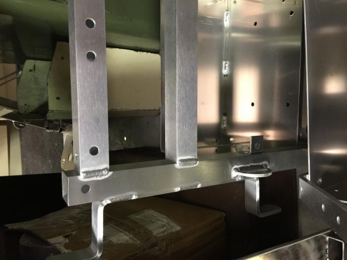

I'm sure someone along the way has asked this question but I'm still going to ask, ha! So the work I do is aluminum Tig, all clean gravy work. Mostly square tubing of various sizes and some small 4" and 5" pressure tanks. All of my work has to be super clean because the products are sold as a premium product. I'm running a weld Tec 20 torch with the quarts set up and a 3/32 tungsten. The question I have is reducing the etching along the weld. I know reducing the en will take some of it away but is there any techniques or specific settings you guys have or use for the reduction of the etching? Any help will be appreciated. The welds are tanks and butt welds and edge welds and pretty everything.

If the pictures you have posted are normal etching for you then you're doing about as good as can be expected and probably better. It doesn't matter how clean or new the Aluminum is you still have to break up the oxide layer to weld it which means you're going to show some etching. Yours seems to be minimal.

- Frame with etching

Unless someone knows something I don't know if you reduce your cleaning you will increase penetration. Seems like if you do that you're going to run into problems with push through. If you have an inverter welder then there's some things you can try, but I'll let some of the folks here who use them all the time answer those questions. I'm still old school and use transformer machines.

As Len was leading to, you can experiment with reducing the cleaning cycle with the AC balance control, and control the penetration with travel speed. Defiantly use only argon (no helium) to help reduce penetration. Even so not sure you'll see a dramatic difference but the results might be improved over what you have now.Braehill wrote:Miller,

You could also use a heat sink on the back side to prevent penetration, I'd suggest copper as it won't stick to the AL if you do burn thru, and the back side will still be flat

I have the htp 221, so I do have some features at my disposal. I have tried as much as 85%en but man the puddle gets grainy. I would like to stay in the 72-75%en realm. if maybe I had a practical application for the amplitude setting on the machine I could see if using that helps. Anyone use amplitude?

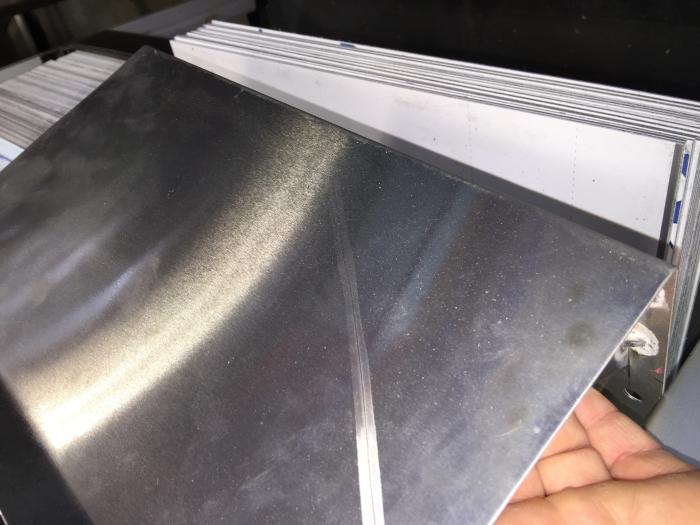

That was a great post on amplitude adjustment, when I get the opportunity I'm going to play around with it using what the post outlined. One more question is browning on the backside of sheet metal, specifically .050. Any string recommendations and or causes.
- image.jpg (45.15 KiB) Viewed 1879 times

Stainless sheet metal?

No sorry it's a 5000 series aluminum .050, it just seems like no matter what I do the backside gets browned.

Unfortunately, the oxide layer on aluminum is porous, and can trap traces of lubricant and coolant from the mill, which cooks on the back side. I can dress it out with a wire wheel or a buffing pad, but some applications won't allow this. Perhaps someone here knows an electro-chemical process like that used on stainless?Millerismyname wrote:No sorry it's a 5000 series aluminum .050, it just seems like no matter what I do the backside gets browned.

Depending on the size of your part, perhaps try washing the backside with a hot water / detergent solution and then rinse with really hot water.
The heat will open the pores in the aluminum.

Here is another thing you can try that CrummyWelding (Roy Crumrine) showed me. He uses a #5 regular cup to cut down his etching zone. I use a gas lens and thought it is better but in testing, because I didn't believe him
) I ran a gas lens and regular set up side by side and the regular will cut your etching down by half. It does look to me like your tubes have a good look already but I think your "improvement" will show itself in your other welds. Give it a try and let me know how well that worked for you.

I always get better results on aluminum with a simple collet than I do with a fancy gas-lens.

Really? A collet over gas lens, to be honest I've never used a collet I've always gone with gas lens. So a number 5 gas lens cup vs a number five collet cup, the collet wins? What about gas coverage it will be affected in some fashion correct? Let me ask another question, why does the etching zone decrease when I'm welding tanks on a turntable, but then I do a butt weld with the same settings and the etching is twice the size? Travel speed?

If you're referring to edge joints, as in your 1st pic, my guess is gas flow is being parted by a 90' joint and dispersing faster than on a butt joint, where gas coverage is a little better due to the 180' of surface area.Millerismyname wrote:... why does the etching zone decrease when I'm welding tanks on a turntable, but then I do a butt weld with the same settings and the etching is twice the size? Travel speed?
