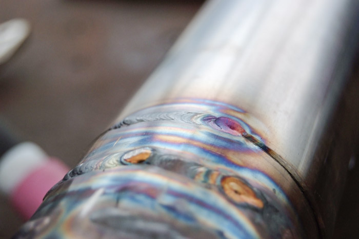

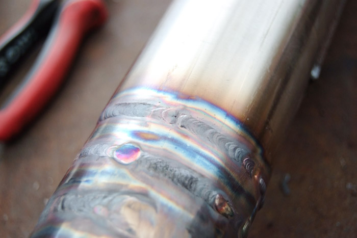

By the way, what do you think about my beads on 304 SS? It's my third time with my machine so I'm still a complete beginner. Any advice welcome :)

My beads looked the same when I started welding stainless- Good and rippled, even, but flat. You cant add rod like you do with mild steel, you gotta kinda tap tap tap it in there. You cant just leave the rod in the puddle like you normally would for steel or aluminum cause one of the alloying elements in the stainless makes it sticky (I believe its the chromium) so you just gotta add rod more frequently, and be quick about it. Thatll give you the bead profile you want.

I am also worried about the color of the welds. No matter what I use, the welds are grey. Once brushed, they just look like the surrounding metal, but I understand that what we want is a straw or rainbow color right after welding. I just can't achieve it. The tubing is only 1.5mm thick (a bit less than 1/16") so when I go too slow with the bead, I build up heat and pop a hole. When I lower my amperge to compensate, I get beads which are too tall. When I go fast and have good penetration, the welds are grey becaus I just move too fast to let the shielding gas cover the cooling metal. I use gas lens 8. Should I get a bigger one? Or maybe I should't worry at all? These welds are for my car's exhaust and they will be grinded.
kermdawg
    Tue May 25, 2010 8:16 pm
    All over, mostly southwest USA
Whats your flow rate at? Theres also another thread on this forum with a guy that had the same problem, ill link it here in a sec.
http://forum.weldingtipsandtricks.com/v ... f=5&t=1200
Make sure yuor torch angle isnt too steep as well because you'll suck air in and contaminate the weld.
