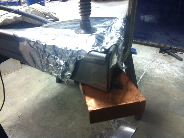

Man it's been a while since we visited this thread. I have a small job in the garage welding up the four corners of a 14ga SS drip pan and wanted to make a quick back purge box and thought I would revive this thread all in the same motion. I bought a inert female to pipe male adaptor and raided my SS scrap bin and this is what I came up with. Ideally if I make one again I would make it smaller as it took 25-30cfh to get a good purge due to the volume. It might work with less flow but I didn't want to grind anything out. Inside the box is steel wool I bought a while back at Harbor Freight and the fitting is silver soldered on. The purge box worked out great. I wish I had better penetration on the back side of the weld but it is just a drip pan. Sad part is this pan will be used on a machine that is getting scrapped in a few months. Someone slipped on some oil and got hurt and the company changed their policy that all machines must have drip pans. Me and a friends company have been getting all we can as it is extremely easy money and work. Next I get to metal finish all the corners and ship it. Now to wait 90 days to get paid

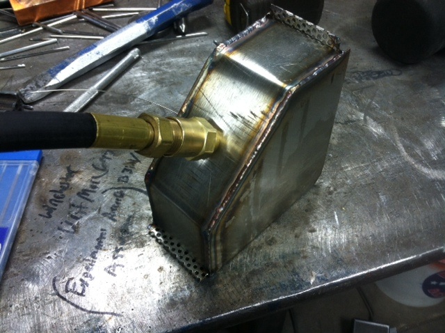

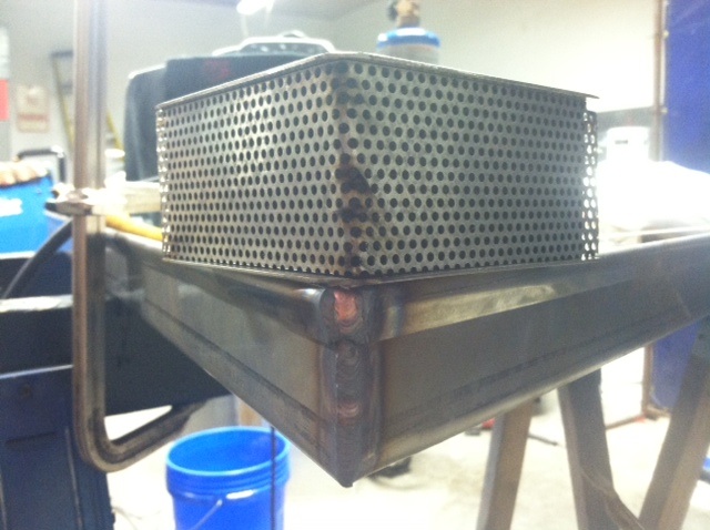

Making purge boxes is fun. I have all sorts of crazy ideas. I made a smaller box tonight and polished them up a little. I need to get down to my metal supplier so I can build more!

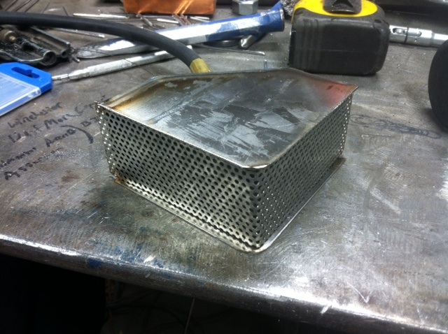

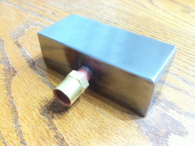

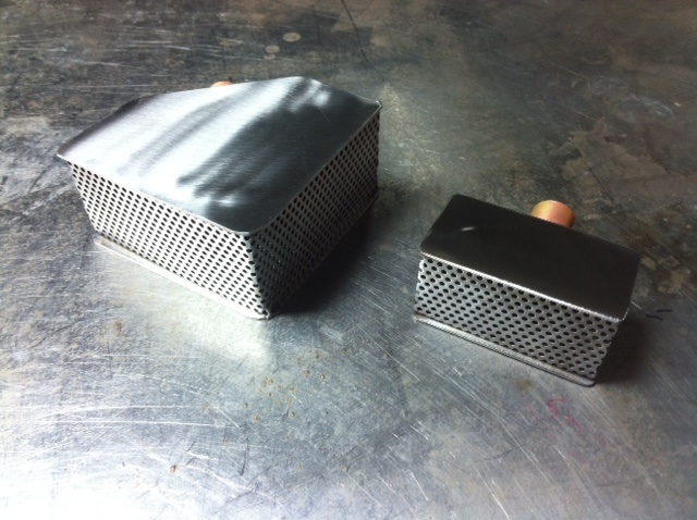

And yet another back purge block. I actually did a little brushing on this one. Not sure the direct use of this one just popped into my head and thought it would look cool.

Superiorwelding wrote:And yet another back purge block. I actually did a little brushing on this one. Not sure the direct use of this one just popped into my head and thought it would look cool.
These look a lot like ones I used to use when I did aerospace work. I have a couple ideas in my head also for some, for special applications. Did you put stainless steel wool inside to help disperse the gas evenly?
I am open to other design ideas if you are willing to share. I saw a few that Jody has made and want to copy them when I get time and materials. I put steel wool in them, not SS but it will work. Originally I wants to order some SS wool but never got around to it. I woul also like to try different meshes like TIG diffusers use. Will have to go eBay shopping soon. Do you have any pictures of your boxes?

One of our traveling welders came in one time to do a repair and had a duffle bag of different ones that he had made (probably 20) over the years. He said while most of the guys drank and would go to the saloon, he would stay at the site and make purge boxes.
He had one that was outstanding from the others, it had three sides that had piano hinges on them and you could open or close them as needed. The long side was even split down the middle so you open just half if you wanted. He also didn't use the perforated metal, he just used some SS mesh that he balled up and put inside.
I think the guy who's paying for their own Argon seems to be more consrvative on the size boxes that they make.
Superiorwelding wrote:I am open to other design ideas if you are willing to share. I saw a few that Jody has made and want to copy them when I get time and materials. I put steel wool in them, not SS but it will work. Originally I wants to order some SS wool but never got around to it. I woul also like to try different meshes like TIG diffusers use. Will have to go eBay shopping soon. Do you have any pictures of your boxes?
We did have some that had fine ss screens in them similar to gas lens' like your talking about. They work great, but the screens would get burned up over time and would need replaced, while the ones we made similar to yours would last forever. All depended on the job. We would also put a "dispersion" bar if you would running through the center. You'd have your gas in, then come to a "T" that had a bunch of small holes drilled "sorry forget what size we used" then tacked the bar to the ends of the back up, then ss wool, the the screen over top. These worked really well to keep an even flow over the whole back up. Sorry no pics weren't allowed phones in the shop. We'd also build gas into our copper heat sinks, but again no pics.
