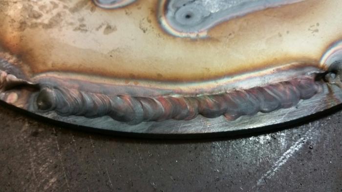

Hey guys I am starting to get into trying to tig weld again..... the biggest thing that has me discouraged is every time i add filler it turns the puddle gray I can just have the arc going on the stainless and be shinny but when I add the filler rod it turn it to a gray color.
I started out 10 ga at 115 A worked my way all the way down to 50 amps I am using 1/16 tungsten 2% Thoriated with a # 8 cup to try to keep the filler in the 100% argon after being dipped, after I trimmed the end and tried lay wire. Nothing it gets hard when the welds look bad in color to get focused on the shape.... any advice?

2nd picture
Middle one was only a arch the other 2 where with filler added.
304SS Plate with 308 Filler

Jason,
There's a point while welding stainless that the base metal reaches a temp (885*F if memory serves me) that promotes oxidation. You're probably going through that temp range right after you add filler metal, hence the color change, the gray is oxidation. If it cleans up with a brush, then it's fine. You can avoid this by keeping the puddle in the gas longer (i.e. bigger cup/more gas) so the puddle is enveloped in it while it goes through that temp range.

I'm new here and a little rusty with stainless, but I'm sure I haven't ever used a #8 cup doing stainless. I like a #5 or #6. Keeps the gas tight. Looks to me like you've got a gas issue. A lot depends to the machine you are using and your settings. Trying to guess at the exact issue without knowing the settings leave a wider area or guessing without any way of really knowing.

One thing you might try is actually turning your amps up! Basically get in, and get out as fast as possible. Jody did a video about it before showing that trying to weld too cold puts more heat into the material than welding hot with a quick travel speed.

My opinion, in the first picture you can see a hint of "color" but the welds look a little lumpy. I believe you are to low of amperage and are sitting there to long allowing the heat to build up. Evidence of that is actually the weld profile, not enough amps to completely lay the bead flat but to much dwell time causing heat input. The second thing I see actually points to to much heat but on the opposite end of the spectrum. The bottom bead is to hot. See how the bead is black and extremely flat? Again, either to much amperage or the plate was already to hot and running the given amperage to much heat input was put in causing it to "sugar".
To sum it up, it will take seat time to get thinner gauge SS down. It is not the easiest in my opinion. Keep up the good work and get us some updated pictures!
