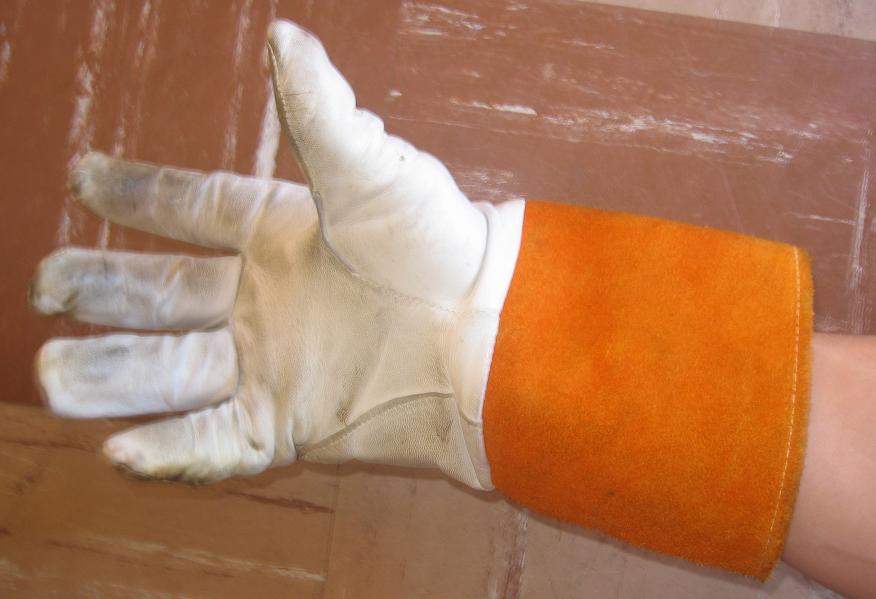

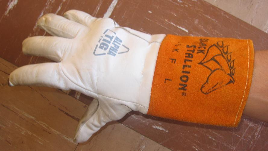

Just to give some feedback, I am liking my revco 35KF (size large) TIG gloves. The foam cushion on the back sude hinders dexterity a little bit I think compared to no cushion layer, but I do sometimes appreciate the added heat protection. The "drag patch" (extra layer of leather on the side of the palm) I think is a really great feature and I think Tillman needs to copy this feature and put it on their TIG gloves. I find this extra layer of leather often benefits me when supporting my hand on a hot or warm workpiece. The kidskin leather (I'm used to pigskin on my previous TIG glove) really shrinks if it even just touches a hot workpiece, but has great "feel" of a small filler rod in the finger so at this point, I'm still happy with it. It just doesn't seem to hold up very well. My gloves at only 1 week or so old are already significantly shrunken in size, although I have been doing a good bit of tig'ing during that week (consumed about a full argon tank in that time.) I am really glad I got the glove sized a little loose initially, because already from just from touching hot workpieces and being exposed to hot torch gasses, it has shrunk to fit my hand. The pictures below are of my torch holding glove. The filler rod glove is looking even worse (darkened and shrunken) from being exposed at times to the torch heat. I think the kidskin does not hold up as well as the pigskin, but is noticeably more soft/supple (good for feeling the filler rod, and good for picking up small objects up off the table.)
