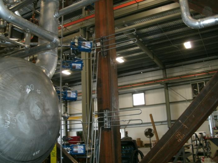

In my avatar, I'm building a "cold-box" for AirGas, and the picture (at an open house) was taken by an executive VP for AirGas. (A cold-box is a distillation unit to extract, in this case, Nitrogen, Oxygen, and Argon from the atmosphere in liquid form.)
Here's a better image of what I was building:

Most of that work was 6061-T6 pipe and tube.
That structure had 4200' of instrument tube in it, all welded.
Here's a sample of the instrument tubes, which I was invited to stay on the job to run...
All .049 wall 6061.
