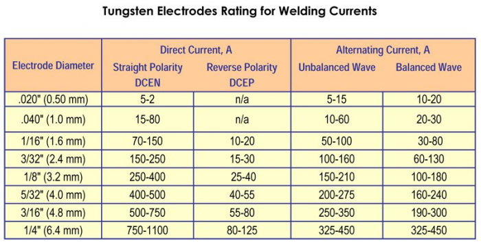

i want to scratch start TIG weld because primarily that's what we do in the field and i want to work on getting my skills better...i am using 1/8" tungsten (thoriated 2%) on 1/8" mild steel with 90 amps which is the maximum amperage i can use on stick mode... it works i can strike up an arc but my problem is it feels like im not getting enough juice the puddle is extremely small i can barley melt down the metal so i was wondering if i need to step down to 3/32 tungsten or am i not getting the amount of amperage it says im getting?????

90 amps is not much, I think you'll need to flip it to tig mode to get your practice time.
Learning to scratch to start the arc doesn't take much practice and is the smallest part of the job - actually time welding is what you are likely after.
Flip 'er to tig and have at it
3/32" tungsten is plenty for that machine.

Did you buy the torch w/switch with the welder? That will do it too.eric325 wrote:I don't have a foot pedal for the machine yet so that's why I can't use the lift tig option but I would think that 3/32 tungsten would be enough for 90 amps??
Here is a tungsten chart for you - as you can see 3/32" is great plenty, 1/16" would do it too.
- tungsten chart.png (230.28 KiB) Viewed 1492 times
thanks for the chart I actually used a 1/16" tungsten and it works great.....I do need the foot pedal cause its lift tig mode and I only have a tig torch that my stinger hooks up to so I only can scratch start at the moment but I am looking into buying a foot pedal and a new torch once I get some money
Ok, try this. Leave your mig gun attached with the 8 pin connector connected. Put you tig torch in the neg terminal, work lead on positive. Set you machine to tig mode, select 4t mode and put the "voltage"(down slope) to mid position. set your amps to what ever you want. Now put your tungsten on the piece you want to weld, press your MIG torch swicth, and lift up your tig torch...you should have just had a lift start on your tig torch...let go of the mig switch and continue welding, with 4t mode it will keep the power on. When you want to stop welding, press and hold your mig gun switch...tig torch should go into down slope to gradually taper your current down. When you release the switch your current should stop. You can use it this way until you get a switch for your torch, or a foot pedal.
