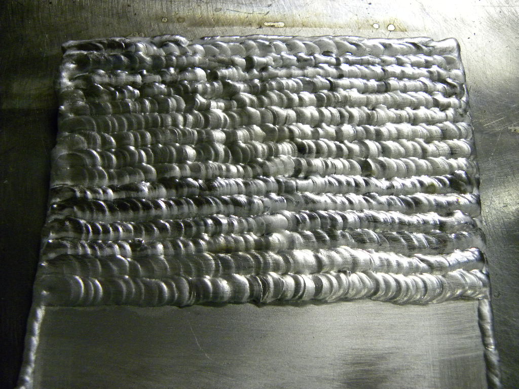

I recently found the site and got psyched up again about some aluminum tigging. Decided to paly around a bit with Jody's practice drill. Including some pics below.
Syncrowave 200, 1/8" 6061, 150 AC amps, continuous mode, 3/32 ceriated tungsten, #7 cup, on a gas lens setup, 17 cfm. 3/32" tig rod

WILD BILL
    Thu Oct 07, 2010 8:03 pm
    BROOK PARK OH
Steve,
I have been following that post Image
I did realign my foot pedal and it made a ton of difference. I wonder if the plug and wiring locations would be the same between your EX and my LX Image
I recently won a Weldcraft WP 20 on E Bay for $66. I'm currently waiting on the adapters to get it hooked up and then I need to get some sort of water cooler for it.
Even though I haven't gotten it hooked up yet I can tell it will be much more comfortable to weld with.
featherhead,
I'ld have to say your weld beads are looking alot better than mine. Image
Everlast 225LX
