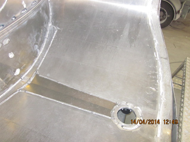

Now welding Aluminium tank what is been modify.. Welds are made ESAB MIG 3000 Aristo and ESAB wires... I have started to like weld Aluminum at overhead and vertical more then steel.. I was suprised how well it goes when ewerything is correct.. Tank has new bottom vessel and one more section then before..

Aleksi86,
Your fab work and welds are really good! So you like the ESAB machines? I have a friend who likes them and their wires a lot. I have only ran their mig machines with solid wire in them, but it did run good.
Question- do you whip with the aluminum mig? looks like it is whipped or pulsed. Not asking because it is right/wrong just curious as to how you are doing it. On my Lincoln 350MP's it has the Pulse on Pulse feature that gives you that nice look and was just wondering if these ESAB's have something similar. Keep up the great work.

THanks a lot man
Here we weld allmost allways ESAB,KEMPPI, Both good machines.. I weld litle bit aluminium at my previous job whit LINCOLN 300 or 350 Aluminium if i recall right?? Its a pulsed machine ESAB, but thoos riples are made By weawing some eeees) If you have douple pulse its good feature to have..But other important thing is gun Angel and that your contact tip is not too out at gas nozzel, (i keep more at inside at AL) so it wont get too hot. (so you dont keep too long stickout because your tips gets too hot and lose Argon coverage) Thoose welds are deasent looking
but the main thing my work is that it will hold pressure/liquids inside with out leaking.. I just wanted to ensure that it would pass test By weawing litle at sides to prevent any porosity or something? And im only a beginner at welding Aluminum ( just a short time welded AL) But its a nice material when you know how to work whit it

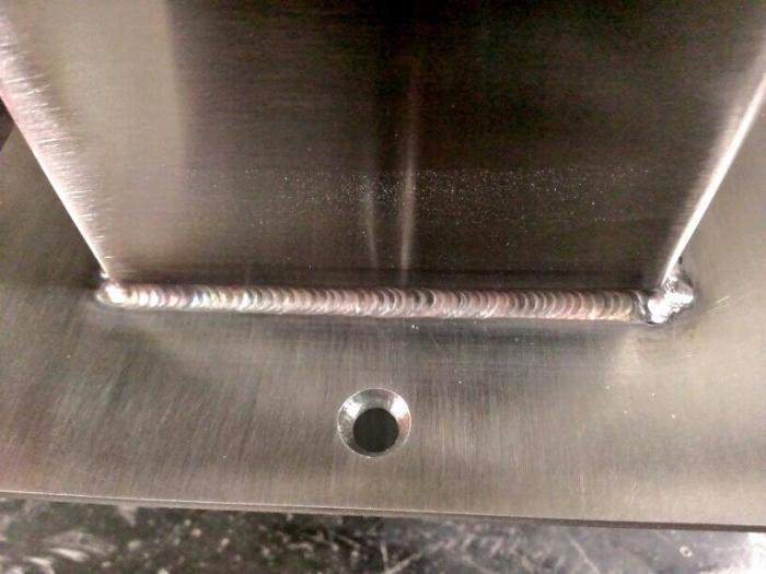

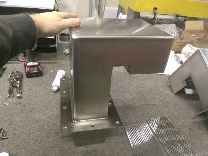

Stainless air vent for custom skylight on the Timex HQ.

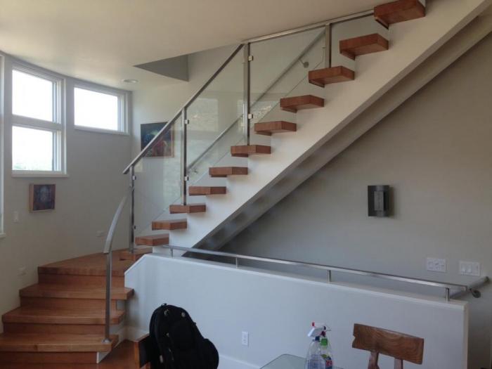

One last post before I go to bed. These pics are a few months old but I am proud of them. One is a really nice ss hand rail we did in a house the other was a personal project I did to test my tig skills welding .030 ss to .030 bronze
