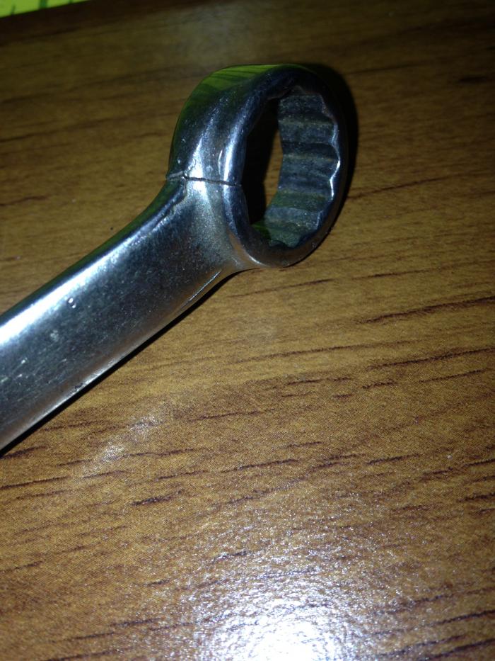

Here's a duro chrome 9/16 wrench, I cracked it by putting a second wrench on it.
I'm going to try and weld it with tig, 1/16 tungsten, and 309l filler rod, and I'll let you know if it holds up.
