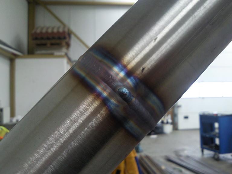

damn, i'm wishing for a 911 almost all of my life :)
about the second class, well u got some end craters that could be nicer :P
here's a 6g weld I did playn with some pulse setings, 304ss
gurew
    Thu May 06, 2010 2:54 pm
weld looks straight, looks a little hot to me... how thick is that material?
when i weld stainless i will literally do 5 beads and stop postflow and start again after a 30 seconds for cooling. and you have seen my stainless welds :)

it's 1,5mm wall , no gap 40A L1 , ~28 L2 , 1,5 sec l1 and 0,2 sec l2.
but that was just training in 6g pos and goofing with pulse. almost never had to weld anything at 45 in a factory, some 800 OD steam pipes ..
inside looks like this :arrow:
gurew
inside is nice :) back purge? tons of penetration hehe
all the SS i weld is mostly 16g thin wall for down pipes and dump tubes, and sch40 pipe

gurew wrote:weld looks straight, looks a little hot to me... how thick is that material?
it's not hot at all, the wall is very thin, 1 pass , freehand.
if you stop after 5 beads will take too long to weld one pipe and increase the chance for craters, let's just say it would be luck to pass an xray, some ppl (walkers) make only one stop, but they work on the bench and i get those hanging from a scafold jobs.
gurew
i know in the automotive industry, welds with that color would create cracks later on a turbo manifold out of sch40 308 SS pipe, entire wastegate runners would break off etc... i havent had the chance to xray any of my welds but ive yet to have a manifold come back :) i would think that 1600-1800 degrees under stress of a turbo and pressures from the exhaust pulses would be in the "extreme" category

is dat a known (scientific) fact or something somebody told you? i belive the thikness of the bead has a bigger influence in failure of high heat sistems then a hot(ish) weld, and i've never seen a fully penetrated weld that looks golden on the outside, not on 1,5-2mm ss and not without backpurge
gurew
thats a known fact atleast in the auto industry making turbo manifolds
