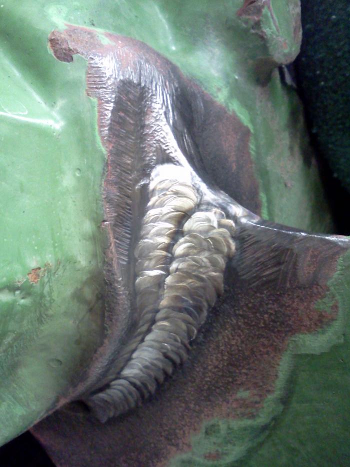

Jason, I have welded a bunch of cast. I am no expert but have had great luck using this method. After I have prepped everything to be welded. I warm the part up slow by a pan heater or space heater not hot just warm to the touch. I use 3/32 red tung, 20-25 gas psi, gas lense. 309l stainless steel filler take it very slow cast does not like to be rushed.. I posted a pic a week ago on some cast I recently done.
power
    Fri Feb 28, 2014 11:13 pm
A picture.

Can I ask why you used stainless rather than nickle?
Arizona SA200
    Thu Jan 30, 2014 8:28 pm
    Arizona
If there is any question as to what the base metal is comprised of 309L is my go to filler. Its very versatile. Welding of cast has been done this way a lot. With your situation i would go with silicon bronze, for two reasons. Oil passage and water jacket temps should not exceed its melting temp and the cleanliness if the material would make it difficult to use 309l. I'm sure you will get other opinions but this is mine.
