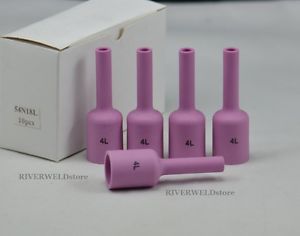

3 try a long series " 54N () L " ceramic & you can shave a bevel onto the end if careful

If you get the long series lava nozzles, you can file the end to an angle or a V. That got me out of a pickle once where I was losing shielding.

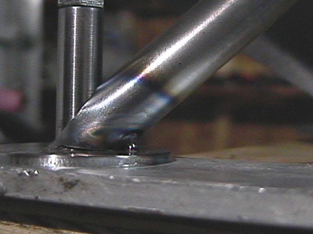

OK here is one of the not so mean junctions...but was still a big pain in the a$$ to get tacked without blowing out the tube. Still learning but this is a hard time for sure. I have one at the 20 degree angle...the last tube. I may try some .045" filler and let the puddle get wide as it wants and just try and keep it off the thin wall as long as possible until it needs to. At least that is my plan....I am probably wrong though. Tried a couple things tonight but sleeting ice pretty heavy covering my shop now and the heat just doesn't maintain a warm set of feet. This has turned into a real bugger to mate up for me. Frustrated with it now. This has a gap at the bottom....just going to have to let it be filled...out of steel again. I'll cool off and look at it again in the weekend......my biggest fear now is blowing a tube after getting on with it and making some progress.

I know how you feel being frustrated that you cant get something that should be easy. I would have to agree with the ideas posted already. I will take a pic of a set up I used a week ago that worked well for accessing a tight spot, although I think it is the nozzles in the picture.
Not knowing the application and taking into consideration your frustration, would this be better to MIG this joint? There are tapered nozzles and longer tips that you could use that I think would work out just fine. If you have access to a Pulse MIG, that would be ideal for this application, in my opinion. Just a thought.

I wish I had other options...I only have the TIG machine. It would be easier MIG....but I think after getting a tack I can start on that and come around the tube on that thick washer. You think that is a good starting point to come away from there? After watching Jody's video on a similar piece he did use this for a restart place. He was also using the same thickness material...so a little more problem for me to overcome. I do know a guy that works at Deere Hitachi and their machines run .045" wire at 700 IPM. Heavy duty plate. I only have access to older MIG machines at work. Nothing fancy and most in need of repair of some nature.....not a good choice for me.

Tough indeed. I'll post again later with a few pictures, but a couple things come to mind.
Try tacking more on the sides. A couple of tacks on opposing sides should hold your alignment.
If you need to tack deep in an acute angle, don't be afraid to bridge a little. When you are running your bead and carrying a puddle later, it will be easier to wash metal down into the root. You'll consume the tack in the process.
Get a good puddle going on the thick piece and bring it over to the thinner tube.
You'll get there!
