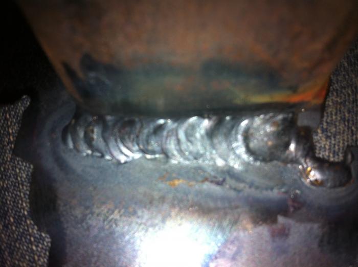

Today's projects are truck hitch covers. We used the plasma to cut out a design in sheet metal then welded it to some 1/4" square tubing.
- 1/4" wall square tubing to 16 gauge sheet
- image.jpg (33.44 KiB) Viewed 2048 times
