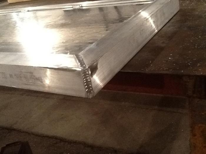

hacadacalopolis wrote:Well with that being said Dave, I'm going to keep the dial at 200 A.
I try and keep my balance as low as I can( between 3-5 on syncrowave). Would you recommend my amps as previously stated with 1/4 " aluminum? I also tried starting off without balling tungsten. I'm just on standard tjoint coupon right now.
Balance setting of 3 on a syncrowave is 50/50 balance like my welder - then you are just welding old school.
May as well at least be at 5 so you get some extra penetration and less heat in the tungsten tip.
On the last set of 1/4" aluminum I ran 230 amps.
I also start without balling the tip since it will round off all on its own anyway. I grind a short blunt angle and put a little flat spot on it.
Pic is 1/4" angle and 3/16" diamond plate. Not perfect, but normal for me.

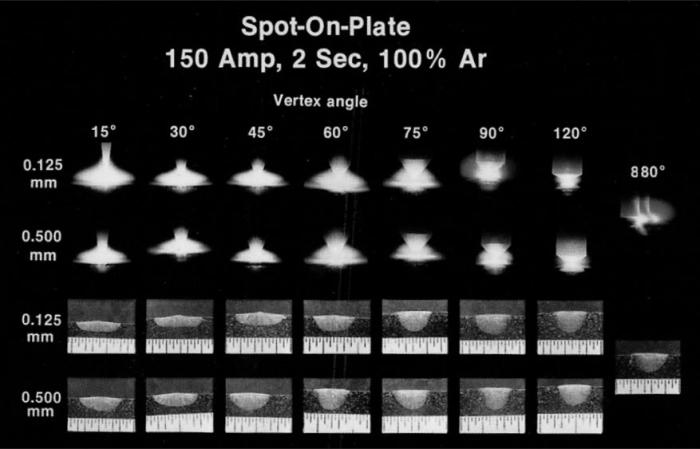

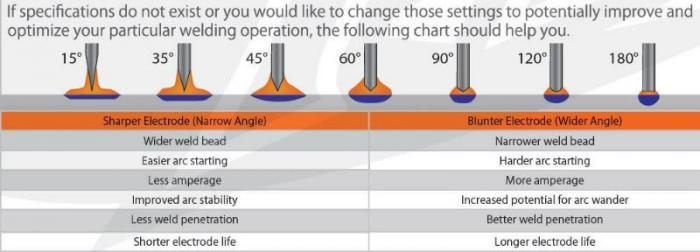

Some grind information for you (by way of pics)
I use the middle of the first pic on aluminum and the bottom two taper grinds on steel.

Minnesota Dave,
Thanks for posting the information on weld penetration versus electrode grind angle. That info. is the exact opposite of what i was thinking. I have been preparing all of my electrodes for steel at a 30 degree angle. I'll go back and resharpen them to 90 degrees. This info. relates directly to the use of correct electrode dia. withthe best angle for the thickness of the material being welded.
Where did you get that information? Excellent reference material!!!
Jim
    Sun Oct 27, 2013 10:57 pm
No problem Jim. I like your take on tungsten prep - using the correct diameter tungsten allows using the best grind angle for the job.
Using a tungsten too large for the amperage requires a long thin taper, which probably eventually becomes the grind usually used out of habit. I'm guilty of it when I grind a long taper on 3/32" when I should be using a smaller one.
First pic was from Miller:
http://www.millerwelds.com/resources/ar ... rc-Starts/
Second from Arc-Zone:
http://www.arc-zone.com/blog/weldlikeap ... ngsten.pdf
Do not remember where I got the Spot-On-Plate test pic. But this post from WeldingWeb shows it could have originally came from a book: http://weldingweb.com/showthread.php?26 ... enetration
