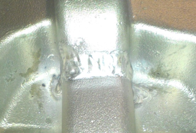

All the welding that I normally do is "saving the day" for someone. I don't build or make anything. I just repair cracked and broken stuff. Here is a high dollar intake manifold. It's for an Olds, so it's already a pricey item and its's been ported.
- Here's the finished job
- final weld olds 1.jpg (68.14 KiB) Viewed 7089 times
- The crack cut out. I usually can play my over the suspect area. The black line is the crack. Now that I can see the ends of it I can finish cleaning.
- grooved out.jpg (71.16 KiB) Viewed 7089 times
- Here is the original crack. Cracked across the crossover.
- cracked olds.jpg (49.1 KiB) Viewed 7089 times

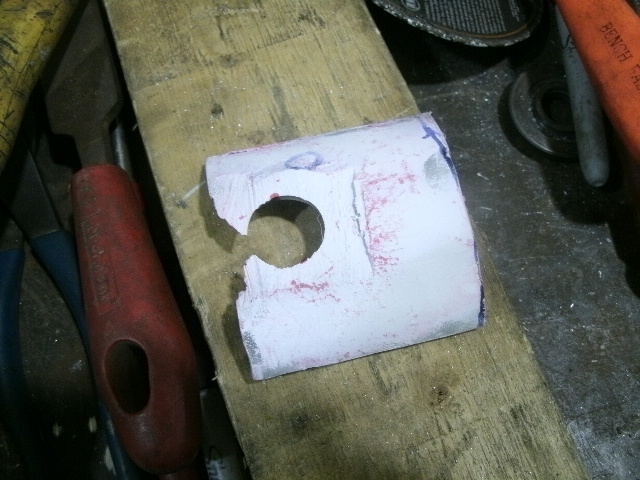

Spent 16 hours repairing someone else's previous "repairs".
Never seen anyone destroy the base metal attemping a reair weld, but such was the case in several places...
Here's what the base metal for one repair looked like with dye penetrant:
LONG two days...

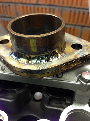

Hello im a hobby welder these are some bits I welded for my racebike one is a seat subframe one is a Ti exhaust header I modified and one is a flange. I raced the bike at the manx gp at the isle of man. Nothing broke

The manifold was 6061-T6, and an unqualified welder attempted to TIG it, using 2% Thoriated, apparently on a transformer machine, too small a diameter, and too much heat. Aluminum should NOT throw sparks as you grind it...weldin mike 27 wrote:Hey,
What caused that?
The base metal was full of tungsten spray.
The easiest solution turned out to be, cutting out the entire affected region (in three places), and adding doublers.
My assumption is there was too litle heat to perform the weld, over too long a time, destoying the properties of the T6, and the tungsten spray. This "repair" was doomed from the start.

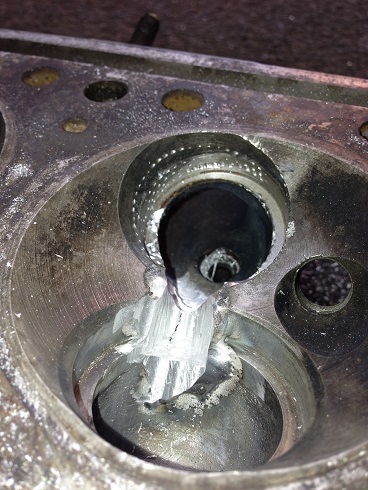

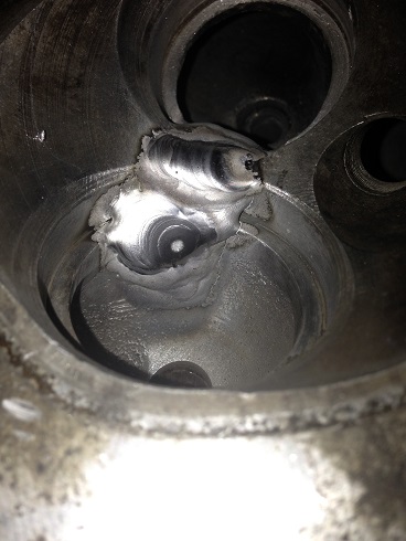

Just sharing a little job ! I did for a mate im no expert remember. Cracked cylinder head. first time I welded it ground it out a bit preheated it and welded it with helium mix and 4047 rod. Cracked right thru weld ! Ground it right out second time and preheated again welded it everything looked ok cracked again on the toe of the weld. welded it a 3rd time this time took the chill of it rather than preheated it welded it and no cracks. Had it pressure tested and might as well welded it with a tea bag leaked every where. Neveragain !! loads of time and gas and rods. But all good fun I guess and valuable experience.
Pictures are wrong way round
steve
steve
- head 3.jpg (75.41 KiB) Viewed 6968 times
- head 2.jpg (108.4 KiB) Viewed 6968 times
- head 1.png (136.49 KiB) Viewed 6968 times
Steve49suzuki wrote:Hello im a hobby welder these are some bits I welded for my racebike one is a seat subframe one is a Ti exhaust header I modified and one is a flange. I raced the bike at the manx gp at the isle of man. Nothing broke
Nice looking stuff!
I know nothing about that race, but from the monoshock with the external reservior, I'm assuming there's some "terrain" involved? When you need a shock like that, and you don't break anything, you done good.

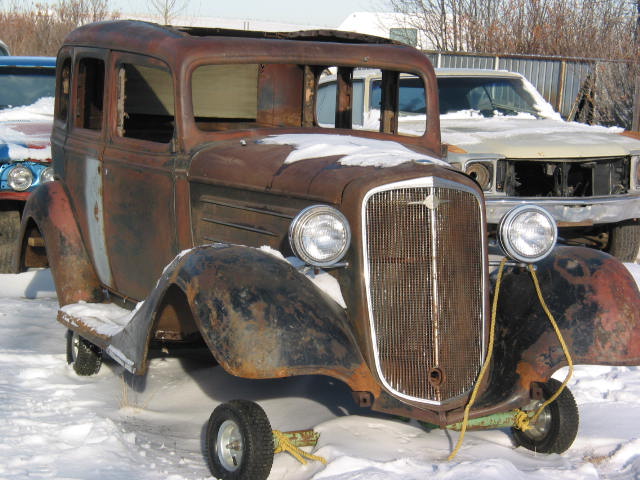

Not my work but my friends where I work after hours.
He is putting this.
Into this.
Chev LSX/LS7, 427 cubes, steel block, twin turbos but take note of the mirror image turbo's, only one place in the world you can buy mirror image turbos.
1952 Ford Mercury pillarless coupe.
And it all fits in without having to have a bonnet scoop.
Still a long way to go but it's well on the way.

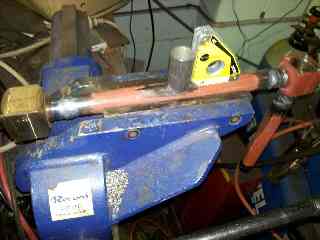

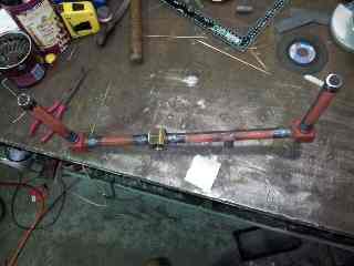

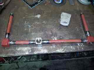

My job today was to fabricate a refrigeration bypass regulator assembly around an existing motorised expansion valve. The existing pipe is 1-1/2" sched 40 and the bypass to be from 1/2" sched 40. I need to pump out the existing line and make safe prior to tie in. (full of 250psi ammonia).
- This is the concept.
- P0.jpg (6.03 KiB) Viewed 6593 times
- Root passes done. 80amps 3/32" ER70S-4 wire & 2% Lanthanated electrode. Gapped with 3/32" wire and 35 degre bevel no land,
- P1.jpg (7.5 KiB) Viewed 6593 times
- Fitting up theaded sockets. Butts capped with 1/16" ER70S-2 wire at 70 amps.
- P2.jpg (8.75 KiB) Viewed 6593 times
coldman
- coldman
This next photo is the coping of the ends for 1-1/2" pipe
- P3.jpg (8.33 KiB) Viewed 6593 times
- Completed assembly ready for tie in.
- P4.jpg (6.5 KiB) Viewed 6593 times
- Assembly tied in to main 1-1/2" line and in service. Sorry for wierd angle but it was a tight t squeeze to get it all in the shot. I used a CK Flexlok torch to help me get around to tie ins gecause of access restrictions.
- P5.jpg (7.44 KiB) Viewed 6593 times

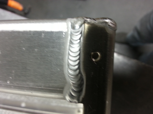

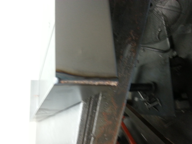

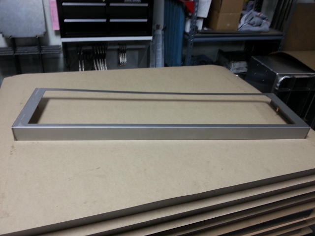

Very easy little aluminum chasis on friday. .062 5052 al the only thing that is critical us all the welds must be fully penetrated because they get ground, used 1/16 5356 filler for color matching and strength. Have 700 to do welld about 200 per day so should be done on wednesday.
- 20131127_235127.jpg (88.35 KiB) Viewed 6568 times
- 20131127_235113.jpg (91.17 KiB) Viewed 6568 times
