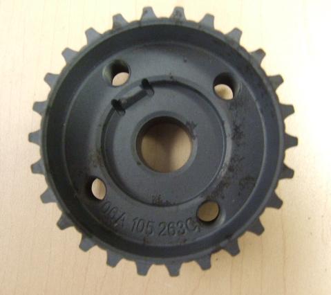

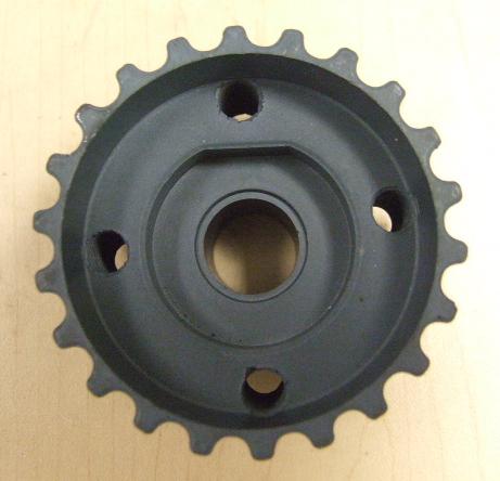

I'm working on a similar project with a Volkwagen turbodiesel AAZ engine crank gear.Ironchef wrote:I made a mistake and got the wrong size sprocket for an electric bike I'm making. The sprocket is a double D but I need a single D. It is also a slightly larger bore. I was thinking I could fill the bore with TIG then bore it to the correct size and then fill it again with TIG and file down to fit the shaft. What TIG settings would make sense? I'm not sure what kind of metal the sprocket is made of.
They are notorious for failing (when mechanics don't replace the crankshaft stretch bolt.)
Eventually, the crank gear becomes just loose enough to destroy the key way cast within the gear.
The popular solution to the problem is to replace the crank gear with a Volkswagen TDI D-type gear.
Some machining of the AAZ engine crankshaft nose is necessary to accommodate the new gear type.
http://www.youtube.com/watch?v=uAl_8GwCLXw
- VW crank sprocket old design.jpg (19.88 KiB) Viewed 2185 times
- VW crank sprocket new design.jpg (21.73 KiB) Viewed 2185 times
