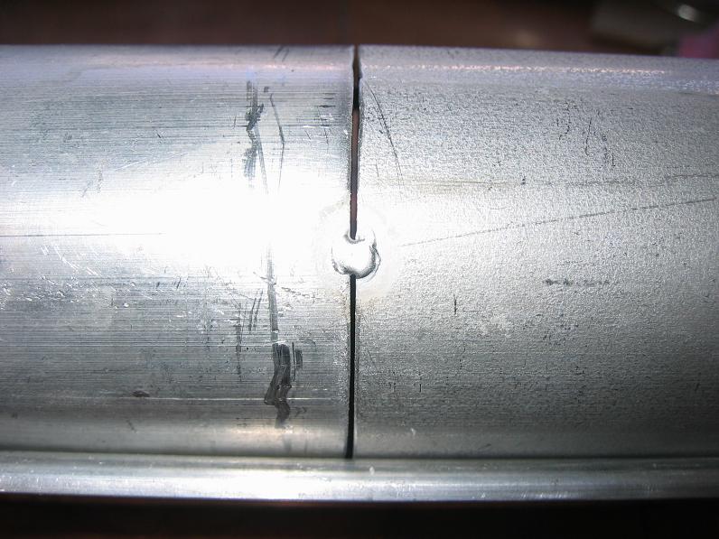

I tried another weld with everything the same (same parent metals, same surface preparation, same filler rod) except that I fit the parts up with a small gap (stood the pieces apart using a .035" mig wire), instead of fitted up tightly like I did at first. I also did no pre-heating, to keep as much the same process as before, to test only the effect of the gapped fit-up. Result: the gap made it weld nicely, without any tendency to crack at all!
By fitting the parts up with the gap, I was basically forced to add a good bit of filler rod to get the two pieces to flow together. Before with the tight fit up, the pieces flowed together with very little filler, so only a small amount of filler was added here and there. I guess I can't rule out the possibility that the filler rod cooling the bead had an effect, but my feeling is that the dilution of the alloy with additional filler rod is primarily what got rid of the hot cracking behavior.

- First tack weld
- IMG_0020_small.JPG (83.88 KiB) Viewed 4486 times

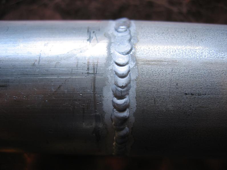

- Completed "stack of dimes" weld bead
- IMG_0022_small.JPG (55.81 KiB) Viewed 4486 times

You figured thru it on your own my friend, .... good job! The problem you were having was exactly that, ..... not enough filler rod. On the tight fit up it is exactly as ya found. Very tempting, or compelling is maybe a better word, to be skimpy on the build up, and that is exactly what happens. The thin strange mixture will immediately not withstand the thermal stress and crack before you can flip your hood up! You also saw that it got better with better attention to preheating, but even so you have to get some material in there and a VERY slow reduction and torch swirl, adding another cap layer on that last bead if necessary. You've got good instincts. Looking at your weld, you just need more confidence in your abilities you have! Wet in, move along at a good but controlable clip, but finsh slow, take your time on that last crater fill. Nice bro.

Oh yeah, one last thing if i may. Especially if your going to grind the finished weld, forget about the "stack of dimes" thing! Get your dips in there more frequently as the larger steps thin the material build up and by nature stretch it thin. Get in there with 2 dips or adds per second approx. and you can do tight fit ups on .062 wall with good penetration, and a nice rounded bead profile!
Thanks Lou - I appreciate the thoughtful words. I like having things to think about and improve for my next welds. I think you are right, I am going slower on this than I could with more practice. I am finding it tricky to get the torch to "rotate" around the pipe! And I am probably a little bit intimidated by burn-through. (Or rather, "excessive penetration", leaving a big blob on the inside of the tube.) More experience on TIG'ing round tubing will probably help. But the dissimilar alloys I think were also making this really tricky.
I tried the stacked dimes just for practice. With my methods and tools available (hacksaw, etc) it takes me a while to prep each weld, so I figured why not try it. And I think you are onto something (thanks!) that faster travel speed and more frequnt filler rod adds would make a better looking bead appearance. I've laid down some really good looking bead sections before (memorable occasions
), on flat sections mostly where I had pretty fast travel speed and pretty small, frequent filler rod dips. I don't know why it can't be done more slowly, but faster travel with smaller dips seems to give a more evenly "glossy" (less grainy) bead appearance. If I had a better set up fixture to hold the tubing vertical (so I could weld horizontally rotating around it), I think it would be easier to rotate around the pipe and weld longer more consistent beads. These welds were mostly with the tubing laying close to flat on a table.
Anyhow, what I didn't picture before the ground/polished bead, was I took a second pass around it to smooth the "stacked dimes" down evenly before sanding/polishing. I have pictured that below. It left me without much material that needed to be removed.

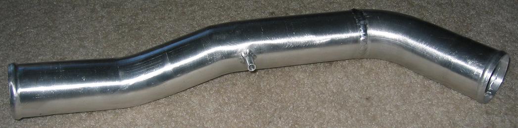

On another butt weld tube joint I made, also of the same dissimilar alloys with the controlled .035" gapped setup, I was joining a straight tube to another that I cut in the middle of a mandrel bend. The bend left the wall thickness much thinner at the outside edge than it started. The inconsistent wall thickness made it considerably harder to get a good bead appearance, and the gapped fit up by itself adds quite a bit to the difficulty of needing to properly time and position the filler rod. The thin side really wanted to melt readily. Anyhow, the resulting bead appearance wasn't the greatest looking on that (kind in the section with one side being thin), so for an experiment, to try "cleaning it up", I went over it with another pass of the torch and no (or very little) filler, using a sort of weave pattern to even out the bead width and make it smoother. It definitely made an improvement in the bead appearance. The weave is kind of pretty up close, I wouldn't say as nice as a perfect stack of dimes to look at or anything, but its interesting. I am going to be OK putting this in a highly visible location in the middle of a vehicle engine compartment.
I also tried some .035" (4043) mig filler rod to fuse a small 5/16" OD pressure tapping tube to the main 2" tubing. Boy, there is a lot of potential for precision work with with that .035" filler rod! My main challenge on that joint was again, keeping the proper torch angle while progressing around the tubing joint. The joint shape didn't offer much of a consistent surface to rest the cup on. The .035" filler rod is very sensitive to melting from torch heat aimed the wrong way.
The end result is completed now; shown below.

- The piece is all done now.
- IMG_0004_small.JPG (55 KiB) Viewed 4470 times
