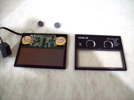

following advice from noddybrian i took the angle grinder an went for it ... HA!
ok, so after a procedure a neurosurgeon would be proud of these are the findings
- the offending item
- 100_1866.JPG (47.88 KiB) Viewed 1900 times
- lens removed from hood, shade knob is pulled off taking note of position relative to pot, nut removed
- 100_1867.JPG (37.22 KiB) Viewed 1900 times
- lens knobs are removed same way shade knob
- 100_1868.JPG (37.5 KiB) Viewed 1900 times
and...
the batteries are spot welded, i`ll take the lens to the batt store hopefully sometime next week and we`ll see

- whooooooa not one battery but TWO ! and the esab catalog states NO BATTERIES... wtf esab !?
- 100_1869.JPG (40.94 KiB) Viewed 1898 times
- batteries measured 2.7 volt each, i assume that they`re 3v batts
- 100_1872.JPG (39.88 KiB) Viewed 1898 times

Happy to see you got into it without alot of damage and not much dust inside - I think what Esab meant is there are no user changeable batteries in the sense that most people will not cut apart a lens to get to them - what I don't understand is why a mainstream reputable manufacturer would do this - but then again I've seen what looks like that exact same lense sold here with any number of make stickers on - but it's Chinese & retails here for around £30 - they actually work OK as entry level hoods but all suffer with battery issues - life depends alot on how much light they get inbetween being used.
Most of the batteries used in these will be lithium & if no numbers are present that make sense just measure them - that's in metric !! ( sorry America ) diameter first then thickness - a common one being 2032 - meaning 20mm diameter and 3.2mm thickness - only difference between these & regular ones used in remotes etc is the connecting strip fixed to the battery- don't try soldering regular ones - the heat pretty much destroys them - you will need to look at an electronics supplier such as "Maplin" / "Radio Spares / Shack " / or on good old Ebay - just add the word " Tagged" after the size you require.

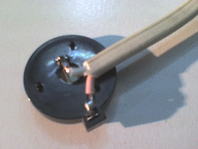

hi guys, just wanted to thank all who sent their replies and show how it all ended
looked for the parts to fix this right away but haven`t had the time to do it. long weekend, holidays and all, suddenly have some time and gave it a shot
i couldn`t find the batteries with the tab welded so instead of ruining the batts trying to weld some piece of wire, bought the sockets and well the rest you`ll see in the pics.
it`s working like before but now i have other problem bc the lens is shading like tiger stripes... well this pos is my farewell to esab, not that i think they care but anyways...

I like your power solution - never seen those battery holders before - an elegant solution allowing future replacement - I'm sorry to hear of this striping effect - never come across that before so can't offer any advise - usually just a battery change returns the lens to full working order - guess you'll not be going to Esab for another one ! - but at least it proves the point when shopping for a hood - make sure the batteries are accessible .
If you look closely they are the tops of bottle caps ...noddybrian wrote:I like your power solution - never seen those battery holders before - an elegant solution allowing future replacement - I'm sorry to hear of this striping effect - never come across that before so can't offer any advise - usually just a battery change returns the lens to full working order - guess you'll not be going to Esab for another one ! - but at least it proves the point when shopping for a hood - make sure the batteries are accessible .
