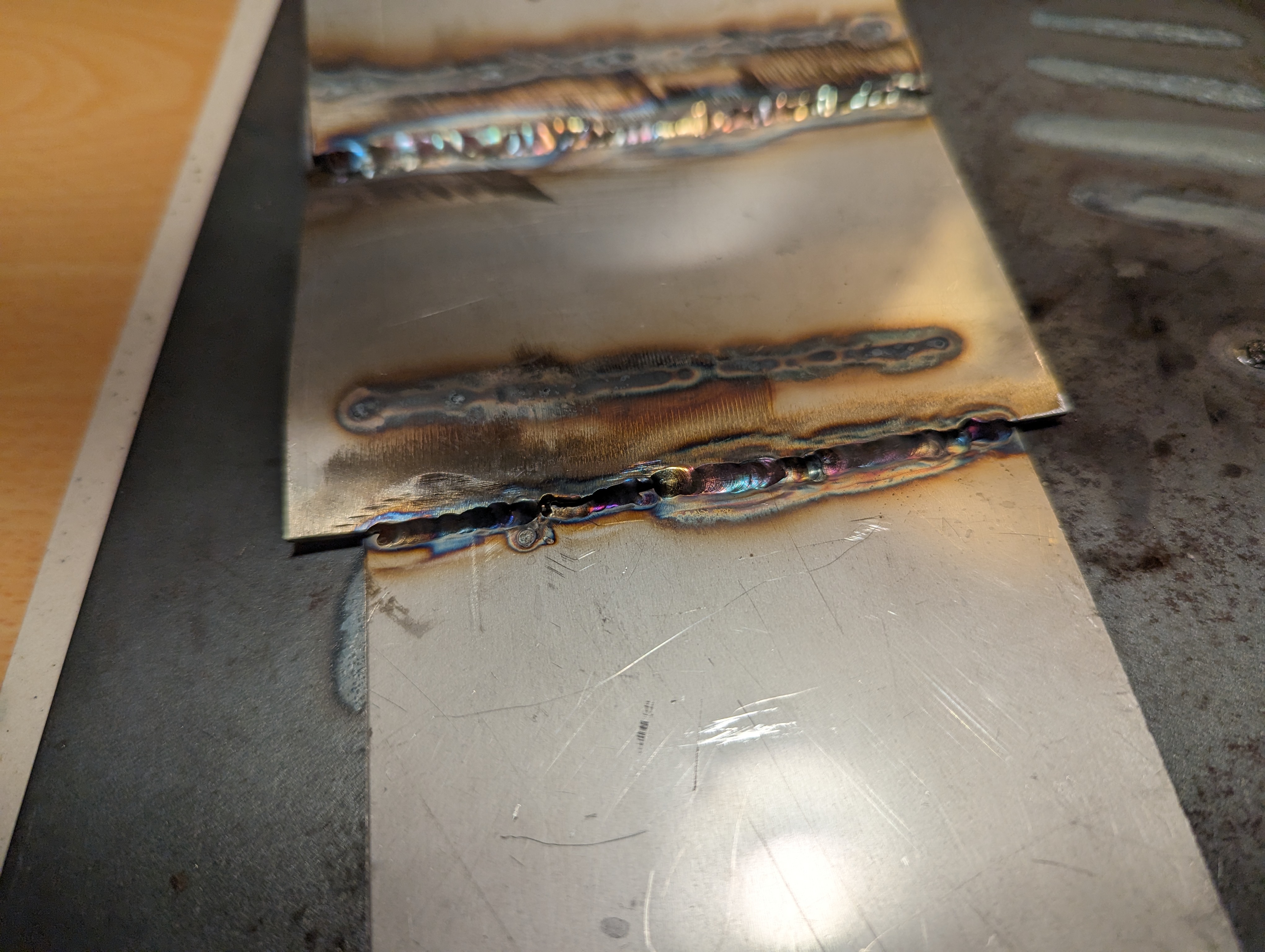

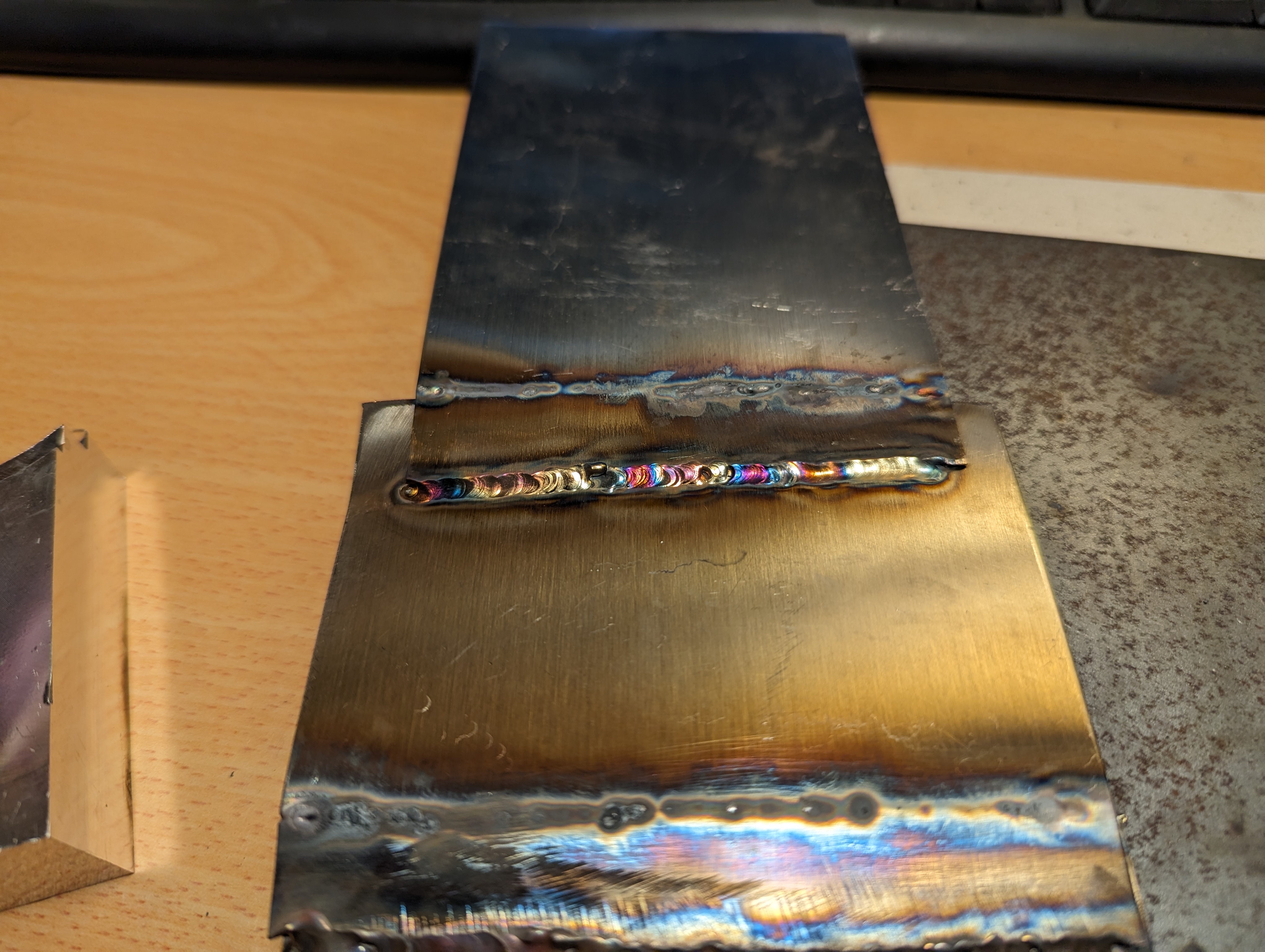

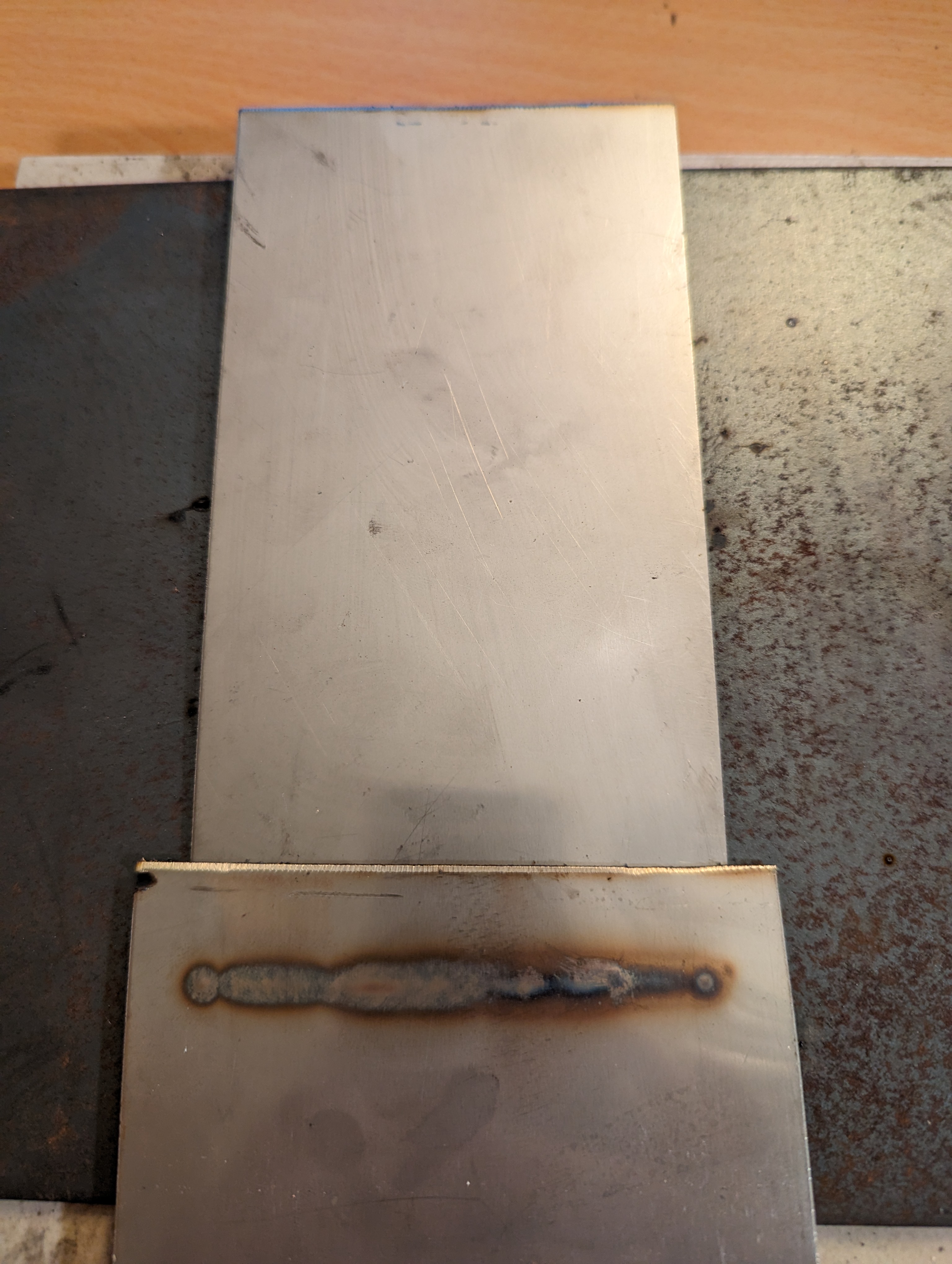

This one I did without filler. 1mm stainless, no pulse, 30 amps, number 8 gas lens, and 6 liters per minute gas flow. The last part sucked because I raised the arc length too much which meant the pieces didn't fuse. I just struck an arc and traveled along the length fairly slowly. Is this acceptable?
Backside. Steel wants to warp, not sure how to stop it. I see that PATW welded it to a thick piece of steel when doing his art thing.
Going to make another practice run on the back side.

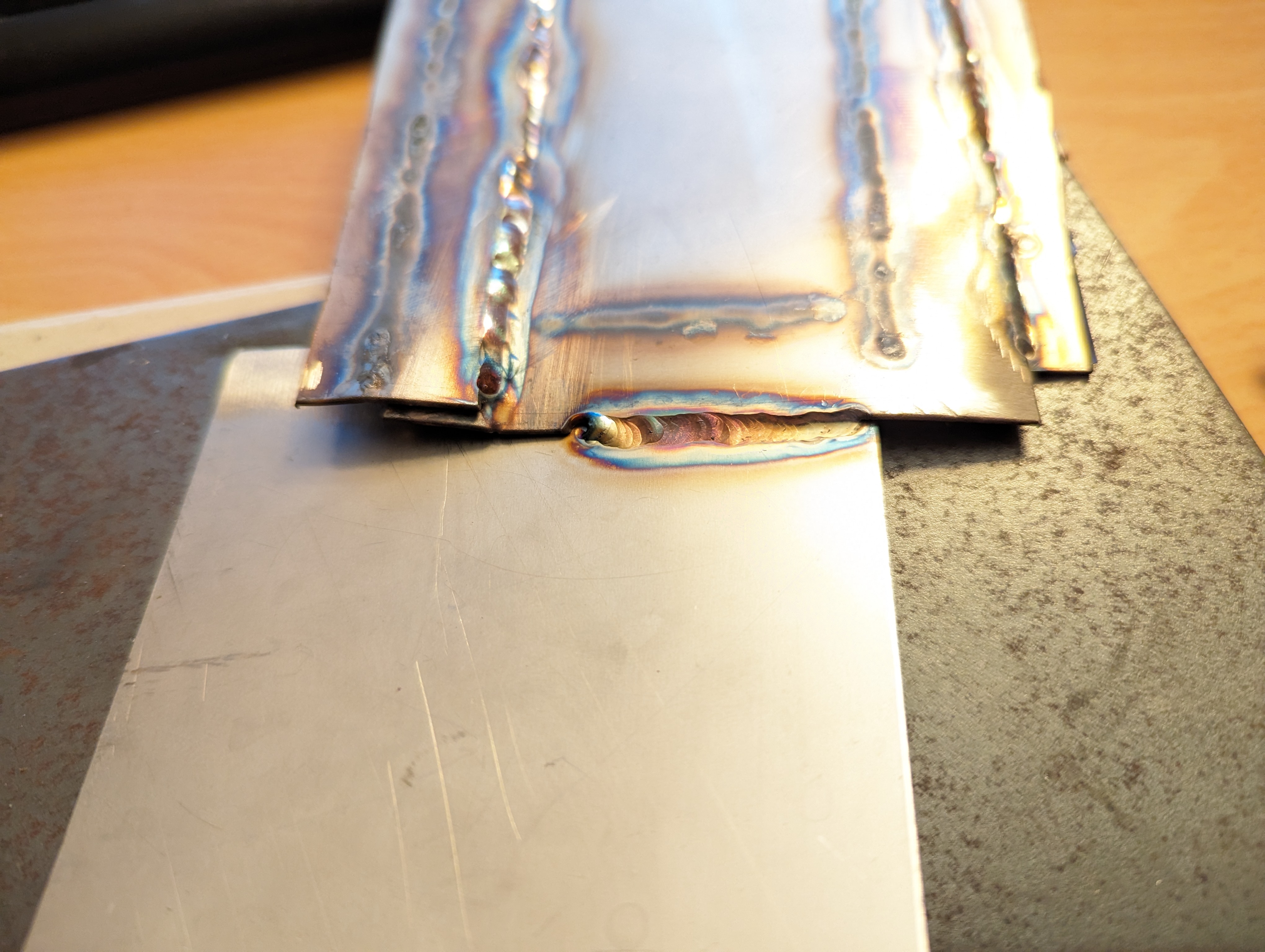

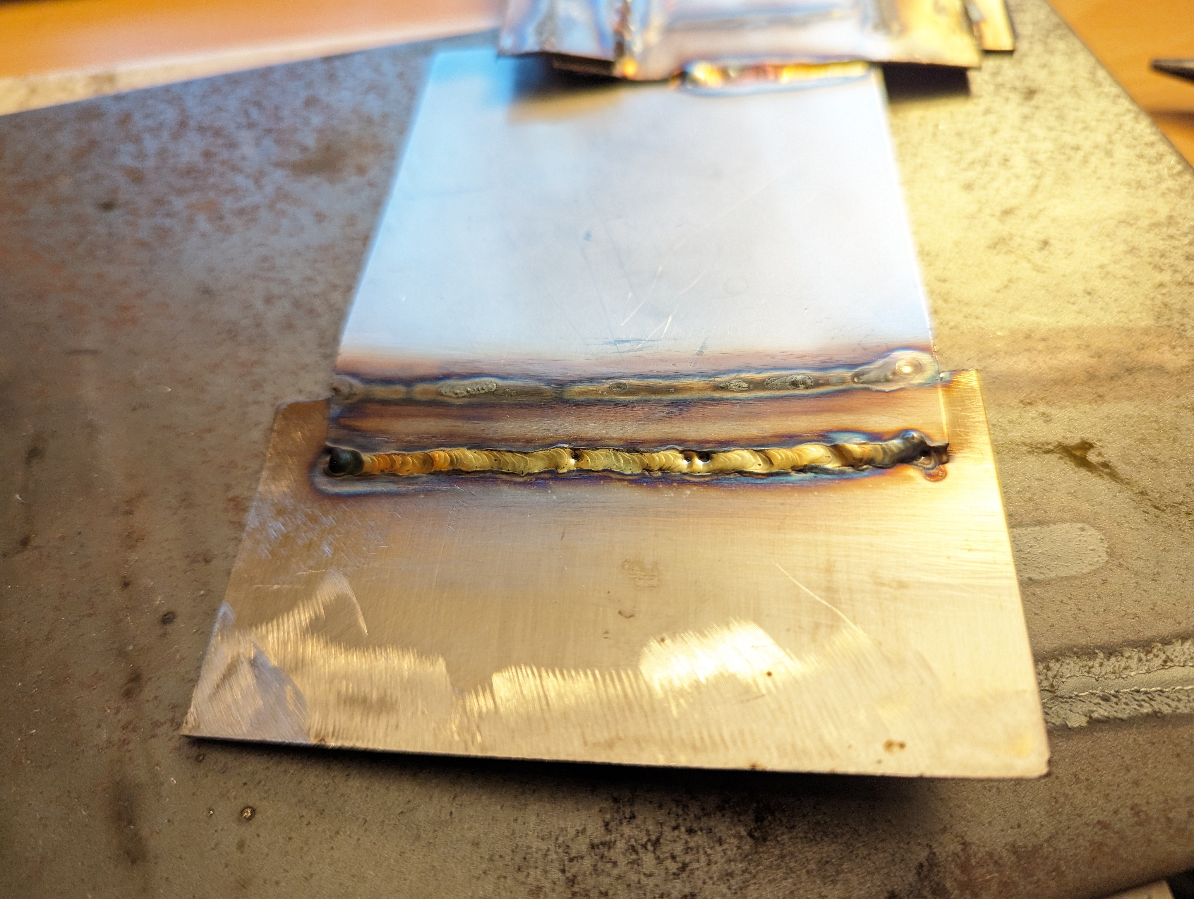

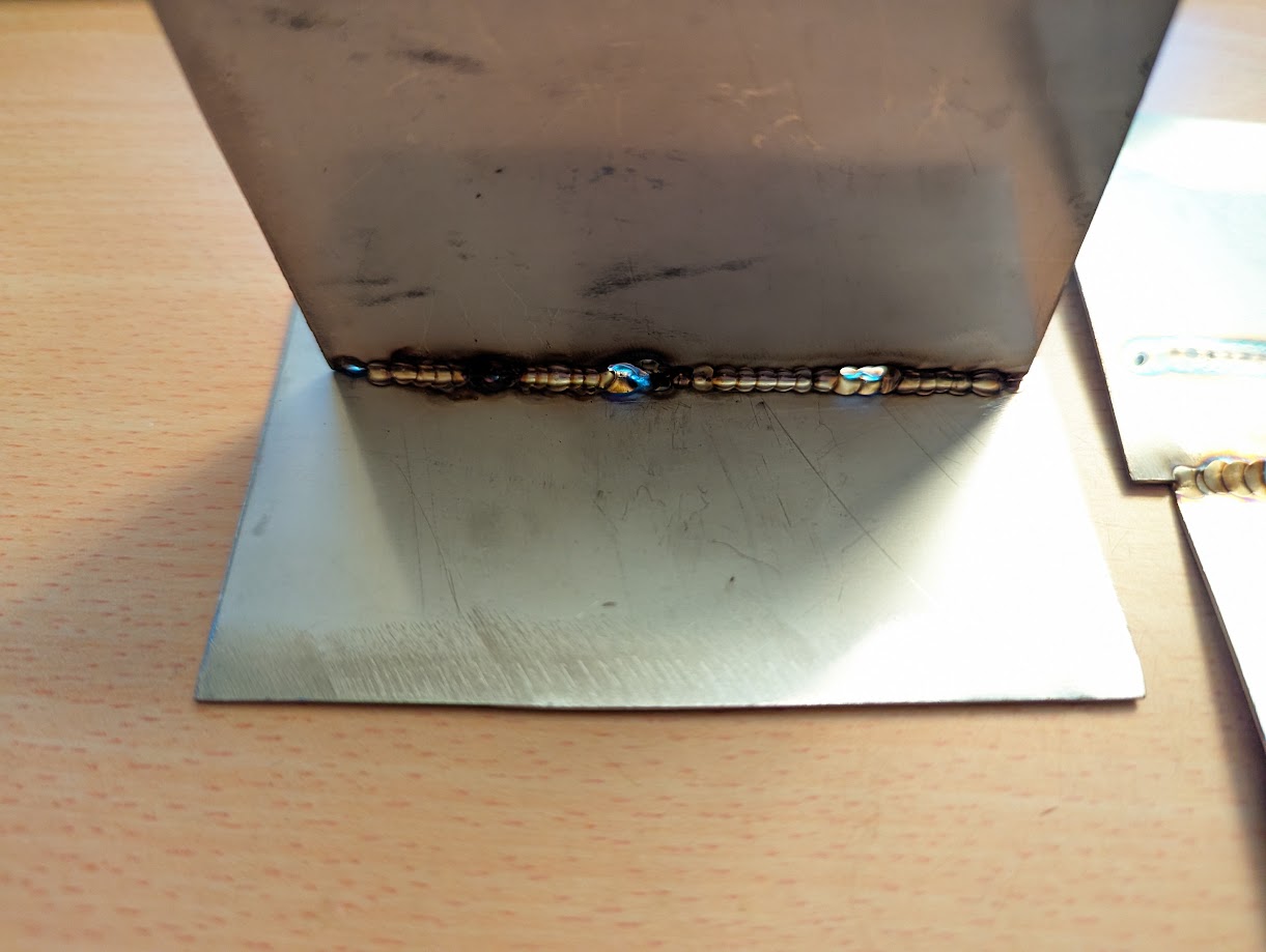

I made a second run on the backside, but due to the gap (from warping) it didn't turn out anywhere near as good, in fact it looks terrible.

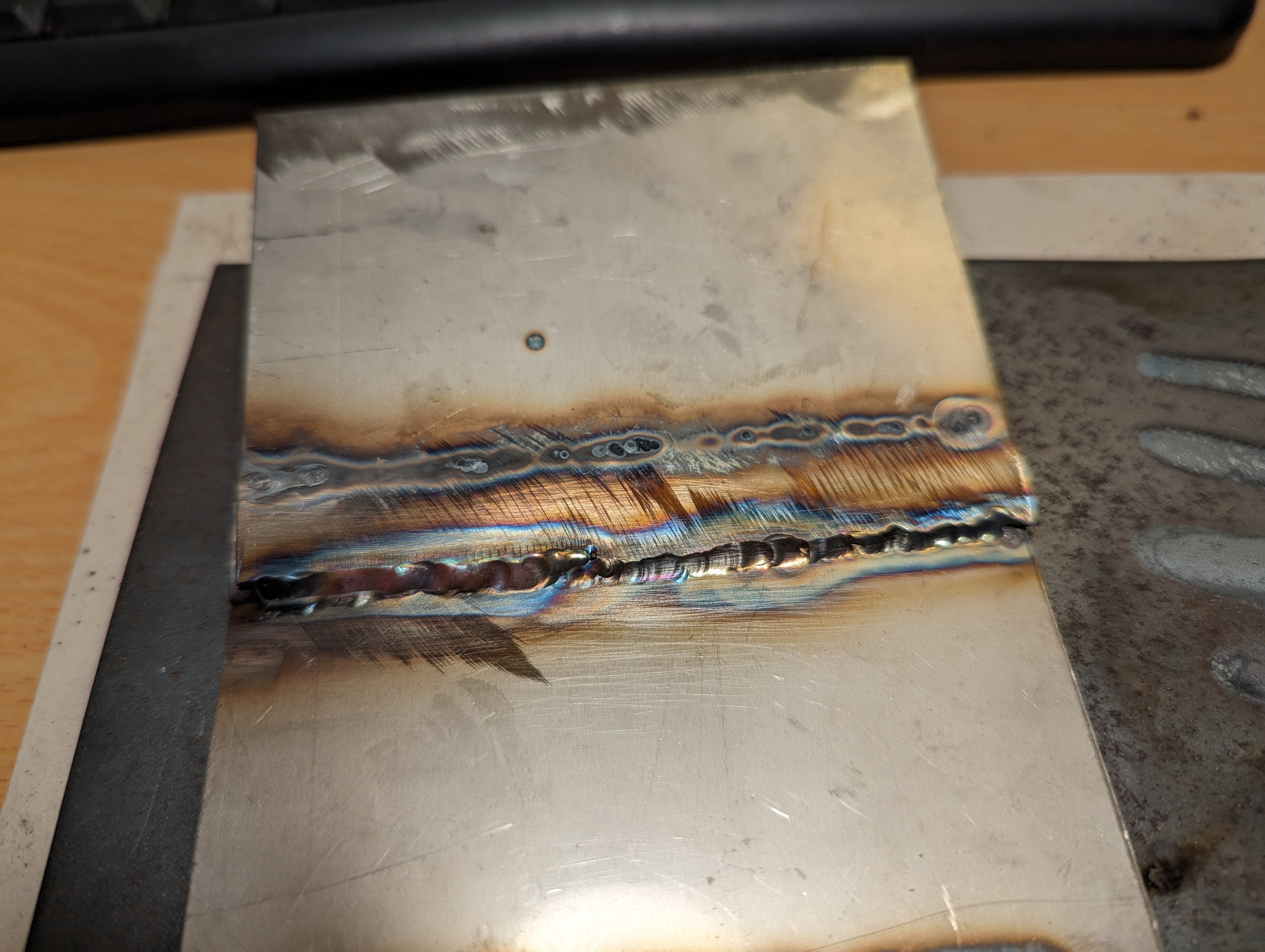

I also made another practice run with another plate and it also didn't turn out that well either, I ended up sugaring the backside.
The problem is I need a VERY short arc length at 32 amps or else it will not fuse (as in the top piece will simply ball away from the bottom piece). I mean an arc length of less than 0.5mm. This means I had to be careful and when I tried again, I stuck the tungsten several times which also leads to the sugaring.
I chose 32 amps because I was told stainless has low heat conductivity, and so it means they need less current than say carbon steel. But at this amperage if I don't keep a short arc, it won't work. I can use longer arc, like what is usually recommended (1.5mm to 2.5mm, basically the diameter of the tungsten), I would need to up the current to at least 50 amps in order for the pieces to fuse properly, but unless I move FAST, very fast, I will burn the metal. I found pulsing gave the best result if I want to keep a reasonable arc length.
I've noticed commercially they don't do full length welds like this at all with this gauge of steel, but rather they just do tacks, or maybe a 15mm long bead along various intervals (usually about 5cm between tacks). If they did full length lap welds or corner joints, they must either use MIG or laser welding because those come out perfect, likely done by machine. When they do tacks like this then it always look good, though I suspect a lot of electropolishing is used if they are used in the food industry.

just run beads on the flat plate. heaps of room for you do to that. get some practice in. get everything else sorted first. don't worry to much about the back side. keep a tight arc.taiwanluthiers wrote: ↑Mon Jan 01, 2024 8:07 pm I made a second run on the backside, but due to the gap (from warping) it didn't turn out anywhere near as good, in fact it looks terrible.
yes, if there is a gap it will pull away. typically you would use filler if there is a gap. if its small gap then you can weave side to side (or circle) and bridge the gap. this is why good fit up makes for easier welding.
it depends on what they are making. eg a tank won't hold water if its not welded fully.
they often tack first to hold everything in place, do short welds and move about to minimize distortion. also keep in mind you don't have to weld it all for it to hold together and less welding is cheaper. but otherwise long welds are commonly done by any professional welder.
they come out perfect because they practice a lot.
you will get there, one step at a time.

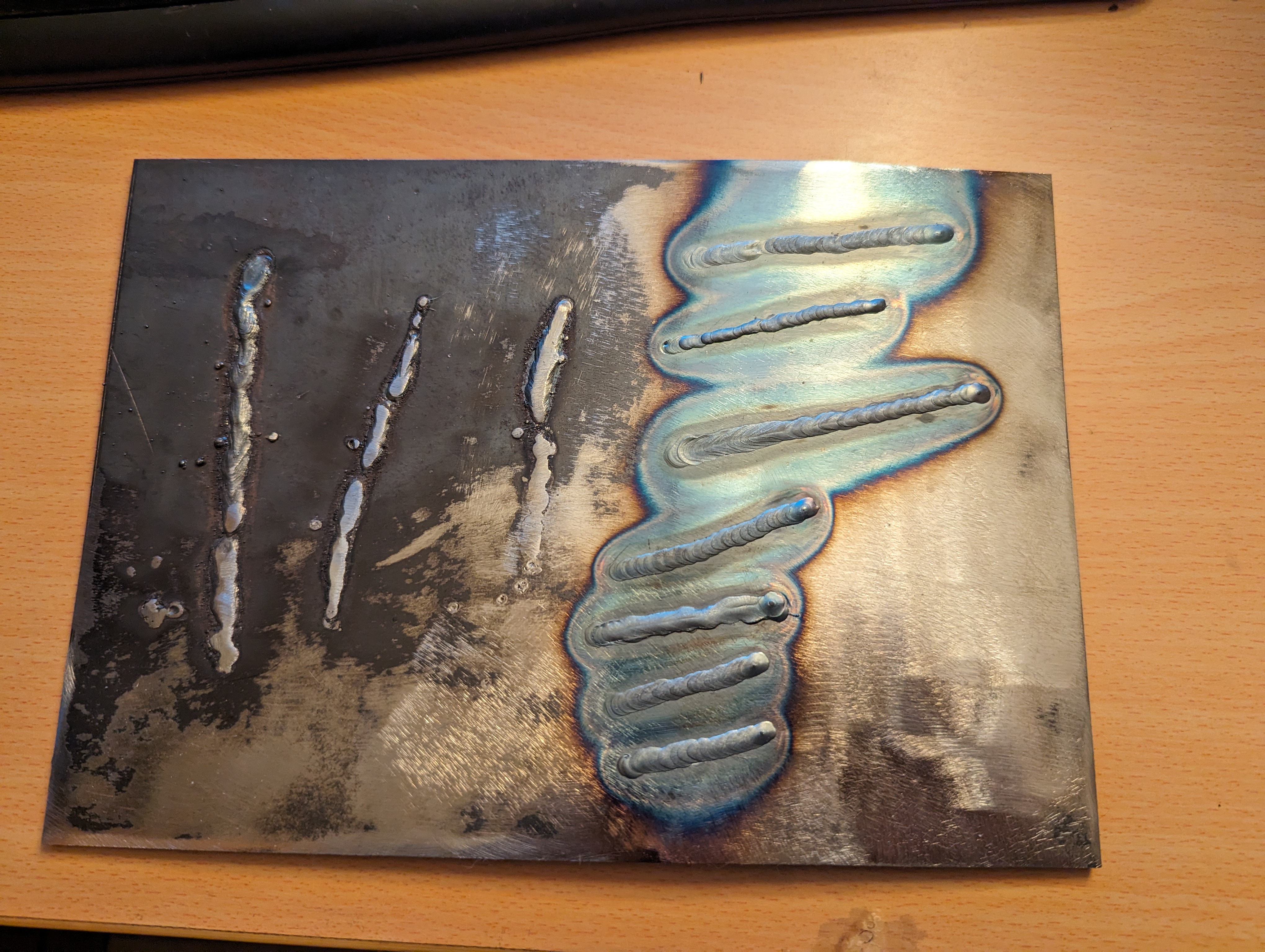

I also tried welding some mild steel, I don't know if it's any good though. This is 3mm thick. I welded at about 120 amps. Some sugaring on the back side. Metal also warped quite a bit. I didn't think mild steel would warp. Heat affected zone is HUGE. Weld bead is all grey, none of those golden color I've ever seen. Vertical beads are stick welds.

they certainly use chill bars. especially if its nicely machined and you can clamp them really well. it goes to crap if it warps a bit and lifts off the chill bar.taiwanluthiers wrote: ↑Mon Jan 01, 2024 10:40 pm I saw on Welding tips and trick video that they used chill bars a lot. Do professionals do this? I don't have enough aluminum around to make chill bars out of.

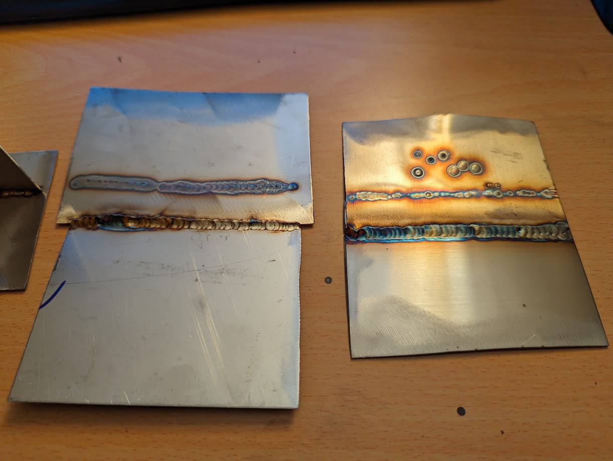

I'm starting to get colors like pacific arc Tig weld but not the stacked dime look. I unfortunately cannot find any thicker stainless sheets, just scraps from a workshop.
Pictures below are all my failed attempt. Getting this consistent is really hard, especially on 1mm thick stock.
I also need more argon. Turns out my gauge is reading low, the actual pressure is about 20 bars higher than what it reads. My gauge reads zero but there's actually 20 bars of argon in the bottle. I took out the little bar that stops the needle when at atmospheric pressure (basically 1 bar) and if I depressurize the regulator, it goes 20 bars below zero. I can't find any adjustment to recaliberate the gauge.

This time I've decided to use pulse Tig. 100 amps, baseline of 10 amps, and it's looking much better because I'm further reducing heat input. I think pulse is made for these very thin metals. Otherwise I think you'll have to use 50 or 60 amps and move extremely fast.
I also brushed some old welds then went back over it with the same setting. Gas setting is now 8 liters per minute, post flow reduced to 3 seconds. I think as long as I'm keeping heat input under control, I don't need such long post flow and waste gas. Blue dot is trying to close a hole, this resulted in some crater and the light blue. Deep purple at the end because I've let arc length get too long (I hear a pinging sound when the pulse hits that tells me arc length is too long)
I've learned for thin stainless welds, very high current, very short bursts, is the best way. Continuous weld is bad unless I'm welding something thick. The short bursts, also reduces steel warpage.
I know pacific arc Tig weld doesn't do this, but I found I'm approaching his weld quality by taking steps to reduce heat input... Very short arc length helps massively.
Finally, tungsten is ground to a very sharp point.
High amperage and fast travel speed really helps with stainless. I'm sure the rule changes when you are welding thicker materials. But these things metal really don't like heat input.

travel speed is the big input to heating material. so faster helps. i don't recall any particular video. i think TFS has one on the subject.
as far as learning goes, you should always strive for full penetration. while a lot of actual products don't need full pen welding, you need to learn to be able to do it. its something that trips me up. but also i have had pro welders who do not get it right. i've fixed plenty of gear that broke because it wasn't welded properly.taiwanluthiers wrote: ↑Fri Jan 12, 2024 11:19 am I know penetration and stuff but how much penetration do you really need with 1mm?
a common stainless product is sanitary tubing, eg food. you need full pen welds so food doesn't get caught in gaps and go off, contaminating the food.

Full pen welding of thin stainless results in sugaring unless you back purge them, or use a backing plate. I heard of a product called "solar flux" that you can apply to the back of the weld so that penetration doesn't result in sugaring, but not sure how it works. The problem with backing plate is that you have to clamp it down HARD so there's no gap, and that's hard to guarantee, and I've had sugaring even with aluminum backing plate simply because the metal lifted slightly when heated. I'm not sure how thick sanitary tubing is, but most kitchen fixture I've seen are all just series of tack welds at 100 amp (similar to the last picture I posted), they are then electro polished.

your next step is filler and joint configuration. especially butt joints. because then its into stainless tube and yes purging is require. learn how to do purge setups and yes it uses more gas.taiwanluthiers wrote: ↑Fri Jan 12, 2024 11:32 pm Full pen welding of thin stainless results in sugaring unless you back purge them, or use a backing plate. I heard of a product called "solar flux" that you can apply to the back of the weld so that penetration doesn't result in sugaring, but not sure how it works. The problem with backing plate is that you have to clamp it down HARD so there's no gap, and that's hard to guarantee, and I've had sugaring even with aluminum backing plate simply because the metal lifted slightly when heated. I'm not sure how thick sanitary tubing is, but most kitchen fixture I've seen are all just series of tack welds at 100 amp (similar to the last picture I posted), they are then electro polished.
guys who can do full pen sanitary (typically 1.6mm) get paid a whole lot more than those tacking cheap kitchenware together. btw we have some custom commercial kitchen ware at work and its all full pen welded.
then you can also go onto pipe, high pressure code work. thats big $$$.
