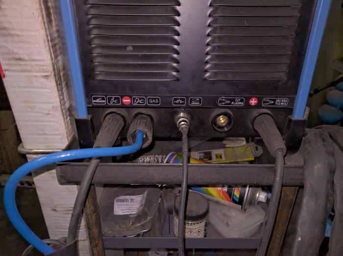

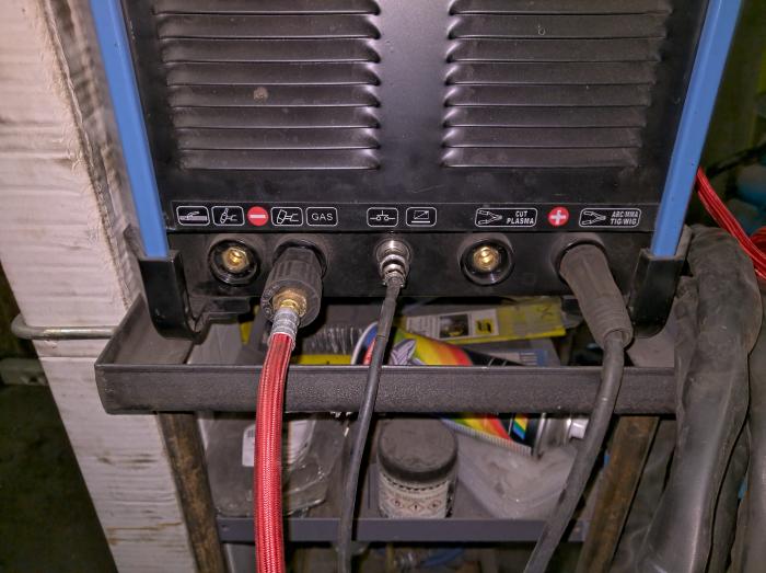

Did some more pressure testing on torch, about 2,5bar it started to leak between cup and cup insulator, not much but still a leak. Changed the cup and cup insulator, this time it held almost 3.3bar of pressure without any leaks.
Picture shows how the torch is currently connected to the machine.tweake wrote:ok, that seams to rule that out.
we have seen issues with cheap gas lens and the gas ports have been undersized.
a possibility thats the case with the torch. maybe it forces gas through at higher velocity. but i would think the gas lens would settle things down.
i presume you are fitting the torch head on the correct side and the gas holes in the connection nut line up with the holes in the head.
is there any way you can block the end and throw it in a bucket of water, see where gas leaks out of ??
There is slight difference how the two torches hook up to the machine.
Left hand dinse and gas connector are bridged with solid copper strip inside the machine so i don't think that's the issue.

put that trouble makin torch on the machine and toss the thing into a bucket of water, then start to assemble the torch one piece at a time, each time in the bucket of water and make sure you are getting gas flow.Martl86 wrote:Torch cup and cap fits really snugly, i pressurised the hose with the cup end sealed and did not find any leaks
