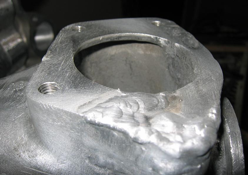

I welded on a thick aluminum roadwheel a week or two ago. sorry no pics. But it was probably the largest, aluminum "heat sink" I've welded yet... 1/4"+ thick where I welded, and quite large thick surfaces to draw away the heat.
I managed to do the thick aluminum welding this time without experiencing *any* split tungsten or multiple protrusion issues!
The "tricks" I threw at it that I didn't do previously in this thread (when I was having multiple protrusions on my tungsten tip welding thick aluminum) were:

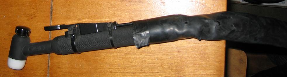

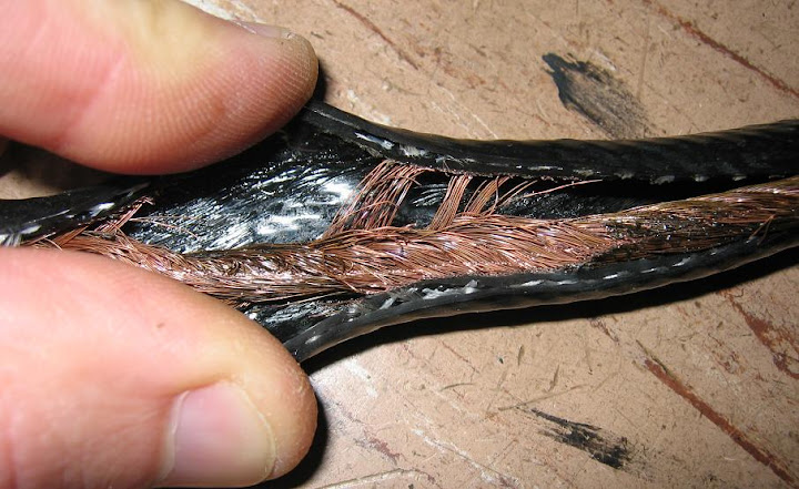

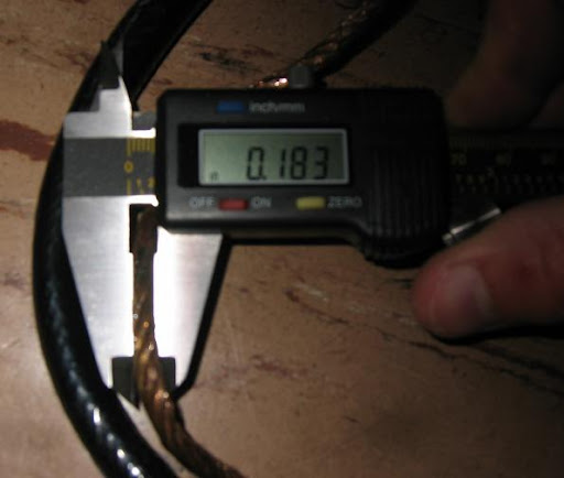

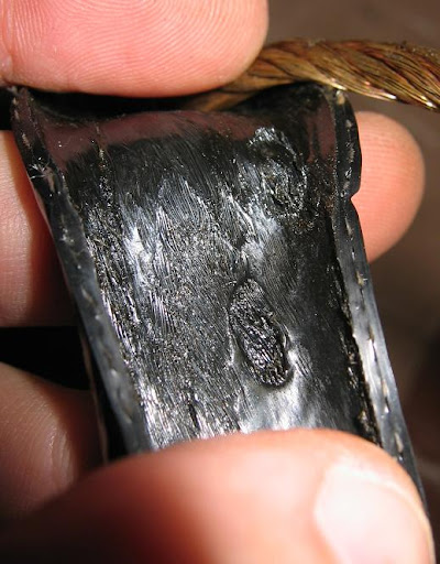

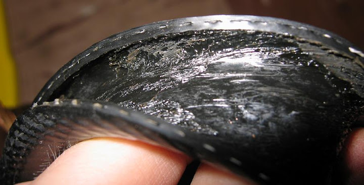

*But* I think I finally figured out what is causing it! Overheating TIG torch, or torch power/gas cable. What I never realized is that the overheating of a torch or cable would manifest itself as a frosted and splitting tungstens. (And something else I didn't really connect at the time - contamination/oxidation of the weld puddle too.)
I think my WP-17 torch is just not up to doing 180-200 amps. My torch has the one-piece power/gas cable. Looks like a plastic/rubber hose, and it must have a conductor inside. I wonder if I split it apart, if the inside surface of the hose looks like its been melted...

The problem ended up being (surprise!) overheating my "WP-17" torch's power/argon supply cable. The outer PVC shell of the cable assembly got melted inside, from the braided copper conductor not being thick enough to carry the currents being used without getting too hot for the PVC jacket. When the conductor got too hot it would melt the inside of the PVC jacket, which would offgass contaminated vapors into the argon gas. When this happened, it would contaminate both the workpiece and the hot tungsten itself.
Since they say "seeing is believing", check out the pictures below of the cable autopsy. Externally, the only clues were deformation of the cable in spots, and also some inconsistent feeling "hard" or "thin" spots in the PVC cable jacket. Inside the cut apart cable jacket, you can see the melted inside wall in many spots. In some spots, I had to pull the conductor away from the cable wall with a good bit force, as the conductor had literally welded itself to the inside of the PVC cable jacket in places. If I kept on welding through this cable with high enough welding currents for long enough time, it is likely the hot conductor would have melted completely through the wall of the PVC cable jacket.
The "fix" here is to use a higher current capacity cable assembly. Such as cable assembly would have either a higher melting temperature jacket material (IE: silicone rubber material rather than PVC) and/or a thicker conductor (giving lower electrical resistance, so it would not heat up as much for a given amount of welding current.) Of course a watercooled cable assembly would also likely be effective in eliminating this problem, as the conductor would typically be immersed in liquid coolant, and the inert gas would travel to the torch through its own, separate hose.
PS - based on the .183" OD of this multi-braided / stranded conductor, I'm guesstimating it to be about 6-8 AWG.

Jim, was that on a Everlast 18 water cooled torch? The wire is much bigger than any torch leads that I have. I wonder if that's how they compensate for the elevated TiN content in the Copper comming out of China. My Elast 18 also flows a ton of water compared to my WeldTec, Radnor and CK torches. I'm a little concerned that its moving too fast to absorb the heat. We have that problem with some of the Race Outboard motors when we mod the cooling systems.

This one I dissected is a 3 year old Everlast "WP-17" (aircooled) torch. (Pic attached.) I've heard as a general statement, a watercooled (such as WP-18) torch would typically be designed with a smaller (cheaper, lighter weight, more flexible) conductor than aircooled. Makes sense that the flowing liquid coolant would remove heat more efficiently than inert shielding gas would, so the torch could use a smaller conductor (having higher electrical resistance.)
I'm curious how large conductors inside other TIG torches are? This is the only one I've really seen a close look at inside.
Upon complete dissection of the WP-17 torch cable, one interesting finding was that the entire portion of the cable that was covered by the PVC jacket/sleeve (you can see in the picture) was melted inside. The only unmelted portion of cable was the last few inches near the TIG machine end, which is the portion that was not covered by the PVC jacket. This finding makes me believe that more current&duty cycle could be obtained by simply removing the PVC jacket.
