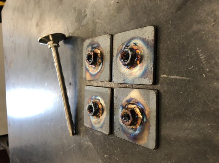

Foot nuts!!
And nobody will ever get to see them. Like a pretty little hidden secret on a table that was otherwise welded out with stupid MIG.
Nice table, and we do know about the secret welds ;)

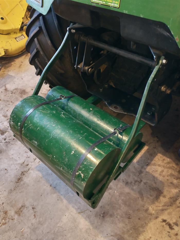

I bought a snowblower for my 2nd lawn tractor thinking that would be the better one for blowing snow (and it may yet be). Tractor is a JD 455. Put it on, and the thing weighs so much it took all the weight off the back wheels and it won't even move in the snow. It's worthless. So, I need to add weight. Figured I'd grab some steel stock at work and strap it on the back of the tractor. Just happened to have a nice 15" hunk of 7" stock and a 16.5" hunk of 5" I wasn't using, along with I've got an entire 2x8 I can cut some hunks off and that'll add up to enough I'm sure.

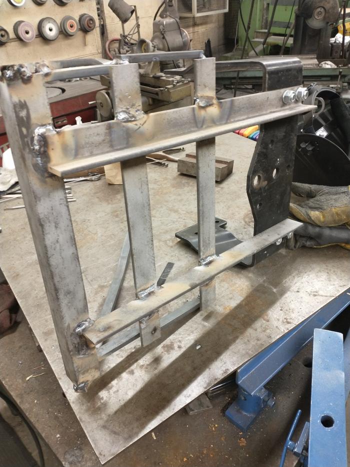

So, got to use my new dry cut saw which I have to say, even with the crappy vise that needs work, does an AWESOME job of cutting steel. If you don't own one, get one... Simple as that. This took untold time off my fab project vs the bandsaw. Honestly, probably took half the time it would have.
Cleaned most of the stuff in the blast cabinet, but left some with the mill scale and just tacked it up with the tig. I'm gonna stick weld the rest just to say I did. I think I've got a 25# box of 6011 3/32...

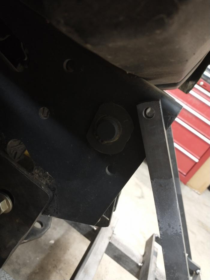

Used 1/4 x 1-1/2 steel angle with some 3/8x3/4 flat stock for the angled braces. Had to measure on the tractor and triangulate the frame hole locations for the braces, then go to work and mock it up and then check to make sure everything lines up. Used cardboard with holes drilled in it to locate the third triangulated hole after using bolts in the drawbar part as well as another bolt for the brace. To my not so small surprise, the holes lined up PERFECTLY when I took it home last night to check it before final welding.
The 5" piece is 67#/ft and the 7" is 131#/ft, so along with some 16" hunks of 2x8 @54#/ft, I fig'r this oughta hold the back wheels down. I'm gonna order a hunk of 10" material to make wheel weights as well. I can cut it in the bandsaw and then machine it to fit inside the wheels and even sit right on the wheel pilot too. If you are asking why I don't just buy weights, just go online and see what they cost. $170ea for a 70# wheel weight. I need 4, then for the rear suitcase weights, they're ~$80/50#. They're smok'n meth. I can't even afford suitcase weights at Tractor Supply.
To explain a little, the 7" piece goes in the outboard cradle, then the 5" piece goes in the next one toward the tractor where I don't have the sides welded in yet. Then the 2x8s (assuming they're even needed) will go behind that where the cradle for that isn't in place yet at all.
If you're wondering, the blower for this tractor weighs 220# and the center of it is 40" ahead of the front wheels. It's extended out there a ridiculous distance. It's so stupid I even inquired asking if they gave me the correct mount, and I'm still not convinced they did.
Time to go grab a stick or two and play!

Buggy, why not just use some tractor counterweights? Can often find those at any Scrap Sale or Farm auction. Looks like there is an existing hitch you could have fashioned a hook for them...
BugHunter
    Sun Apr 19, 2020 12:54 pm
cj737 wrote:Buggy, why not just use some tractor counterweights? Can often find those at any Scrap Sale or Farm auction. Looks like there is an existing hitch you could have fashioned a hook for them...
As I mention above, they're terrible expensive. I can buy 4140 steel new for less money per pound than wheel weighs or suitcase weights. It's insane. For the amount I'd need, it would be $1000 even on Ebay. This is all stuff I have laying around at work already paid for. And I have them today.
If I find suitcase weights at some point for a decent price, this stuff will still be there and can come back to work and be used in the shop. Assuming of course I can get it back in the pickup without a forklift. :mrgreen:

Nicely done on the weight rack. Chains on the rear wheels will make a big difference if you aren't using them already.
BugHunter
VA-Sawyer wrote:The better my Tig gets, the worse my Stick looks.
Well, I definitely need to pick up some new sticks and see if they work better. Holy cow did these look terrible.
I have chains, but my driveway and walks would be scratched up if I use them so I took em off. Tried it last night and WOW, does it work better now! I blew out the neighbors parking area and did my mailbox where the township had plowed it back in. Never spun a bit. I painted everything so it wouldn't rust 'too bad'. Didn't even need the 2x8s, though I might still add them later if I find this next snow is a struggle. For now, I'm really happy, and no out of pocket $$$ used.
