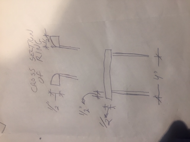

You are saying the 1/2" plate is really a little round piece with a 1/2" diameter and 1/2" thickness? The tubing is 1/2" diameter?
The tubing is 4" X 1/16" round. The plate is round, 5" OD, 3.932" ID and 1/2" thick. This piece has a 1/2" radius milled on it, so from a mass standpoint it is ~25% smaller than 1/2 X 1/2 . The tube will be welded near where the radius terminates, so a bit less mass in that area.Jakedaawg wrote:You are saying the 1/2" plate is really a little round piece with a 1/2" diameter and 1/2" thickness? The tubing is 1/2" diameter?

Ok, so it's not a plate, it's a ring. And a lightened ring at that. Big difference. Still going to be a challenge but nothing like what I was assuming you meant.lr172 wrote: The tubing is 4" X 1/16" round. The plate is round, 5" OD, 3.932" ID and 1/2" thick. This piece has a 1/2" radius milled on it, so from a mass standpoint it is ~25% smaller than 1/2 X 1/2 . The tube will be welded near where the radius terminates, so a bit less mass in that area.
Still not sure where this radius is, inside, outside, on the side the tube attaches or opposite...
A drawing would sure help if you don't have a pic.

I've read through all of the posts, and still can't quite understand the parts and joints you are talking about. A picture/drawing is worth 1000 words when you're looking for advice. Post something graphic if you want accurate advice. Most people here would easily spend 5 minutes or more of their time typing a detailed response to your question, so consider taking 2 minutes of your own time to provide a graphic to help those people help you.
Spartan wrote:I've read through all of the posts, and still can't quite understand the parts and joints you are talking about. A picture/drawing is worth 1000 words when you're looking for advice. Post something graphic if you want accurate advice. Most people here would easily spend 5 minutes or more of their time typing a detailed response to your question, so consider taking 2 minutes of your own time to provide a graphic to help those people help you.
- IMG_1612.JPG (51.41 KiB) Viewed 5041 times
Ok, the drawing got me thinking that I don't need that big of a chunk of metal. The drawing also includes the flange (forgot it in the last pic). If I cut an angle, I can leave WAY less mass near the weld area. I can make that land maybe 3/32 or 1/8 to reduce the mass near the weld. Would like advice on what size to make the land. Also, I can make a step before starting the angle to leave even less mass near the weld.

I'm thinking threading will be a no go. Between the thin tubing and the bevel / chamfer.....a strong breeze would knock that out. IMHO
That said, welding 1/16 to 1/8 sounds reasonable to me.

what is the "thing" going to be and do? You can't find 4 inch tubing with a heavier wall? Can you design an interference fit for the tubing into the plate, since you don't need strength for support?
It is a tubing flange that secures flexible tubing to a flat surface for air flow. Standard 90 degree flanges produce a great deal of turbulence and the radius smooths that out and increase air flow through the tube by about 20%BillE.Dee wrote:what is the "thing" going to be and do? You can't find 4 inch tubing with a heavier wall? Can you design an interference fit for the tubing into the plate, since you don't need strength for support?
Interference fit is a good idea. I am sure If I add some sleeve reatainer that it would be strong enough, though not sure it will be strong enough to allow me to chuck the assembly on the tube for turning. I suppose if I keep the cuts light it may work. Any idea how much? I know .0015 would work well on a solid part, but wonder how much for a thin walled tube. Will have to research that.

For what you are doing, thick-to-thin won't really be that bad.
Once joined, just keep heat to the thick side and the puddle will stay with you.
Add rod to keep joint filled and weld happy.

If it's not going to be subjected to heat, You could even consider Devcon Aluminum Putty. For that, or even still if you're going to weld it, you'd be adding a counterbore to the radius'ed part, with enough length to press the tubing inside it. On that diameter, press fit should be real easy. From there you can easily weld the thing, again keeping the heat mostly on the heavier part. Also you should not need to do quite as much thinning of the ring as you're suggesting above. If it's a press fit, the heat will likely equalized pretty well. Not 100%, but would make welding much easier than two parts sitting alongside each other with no mechanical contact.
Here's what I was thinking. cut a .0625 x .125 counterbore into the ring part. Then insert the tube, then weld at the junction(s). Or, if Devcon would work, use that.

Thanks to all for their input and suggestions on this. I will use this approach. I may also run a test with the interference fit with a sleeve retaining compound, as that may be enough strength for this applicatoin. If not, the welding now seems to be in the vicinity of my skill levelBugHunter wrote:If it's not going to be subjected to heat, You could even consider Devcon Aluminum Putty. For that, or even still if you're going to weld it, you'd be adding a counterbore to the radius'ed part, with enough length to press the tubing inside it. On that diameter, press fit should be real easy. From there you can easily weld the thing, again keeping the heat mostly on the heavier part. Also you should not need to do quite as much thinning of the ring as you're suggesting above. If it's a press fit, the heat will likely equalized pretty well. Not 100%, but would make welding much easier than two parts sitting alongside each other with no mechanical contact.
