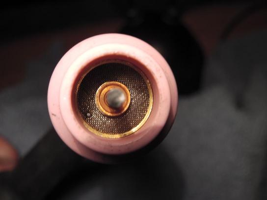

I would agree with you, that it looks like you aren't getting proper gas shield coverage.
I modified my Everlast torch with some inexpensive parts from eBay.
- #8 Cup Medium Gas Lens.JPG (60.28 KiB) Viewed 3299 times
- Medium Gas Lens #8 cup.JPG (34.75 KiB) Viewed 3299 times

Do you always use the cup you showed in the pictures? With a 2.4 electrode in it doesnt leave alot of room for the gas. I like a straight sided cup. #8 I believe , to give the gas some room. If it starts swirling around, it can draw in air at the end of tje cup. This could be exacerbated when the cup heats up, could be why you can get a few welds in, before it goes kaka kookoo.
Id try the biggest cup you have just to see it helps. I dont mean the big ass white one, still pink but a good deal bigger than the one you have on.

Yeah I agree, #7 cup is my go to size, either in standard or gas lens with 2.4 tungsten. He did say earlier though that he was limited to #4 for the time being for some reason.weldin mike 27 wrote:Id try the biggest cup you have just to see it helps. I dont mean the big ass white one, still pink but a good deal bigger than the one you have on.
In the photo showing the balled up tungsten: even that lopsided ball could be deflecting a significant amount of the argon away from the job given the small cup size. The tungsten was still nice and shiney though

I am limited to that torch setup until I get the dinse connector for my other torch on thursday. I am hoping the other torch solves my problems.
The weld with the gas lens was done in one run, and yes the shielding doesn't look great. But that is an older piece of steel so the colors get duller with time.
Well, I figured out the problem.
It was a lack of gas coverage due to the collet. The torch supplied with the machine only came with 3/32 collets and collet body. I only had 1/16 and 1/8 electrodes. So I modified the collet body and collet to accept my 1/8 tungsten. Drilling out the collet was not that easy, because it just wanted to split/flex away from the drill. I ended up getting it so that I could fit the electrode in, and used it.
It turns out, the collet was expanded due to the undersized hole i made. This obstructed the orifices in the collet body, and bam, poor gas coverage. Once I found this problem, I stuck a zip tie on the collet and drilled it out to the correct diameter so it does not expand when the electrode is in it. This worked marvelously. I dont have pictures, but I am getting great results with stainless.
Oh, I also got a #7 and #8 cup to try. I have only used the #7 so far. It works fine. I am excited to try the large gas lens and #12 cup I have for my CK torch!
Coulda mentioned some of this "creativity" earlier...
I never dreampt you were using a modified collet body such that the tungsten/collet were blocking the gas holes.
Glad you have it solved!
